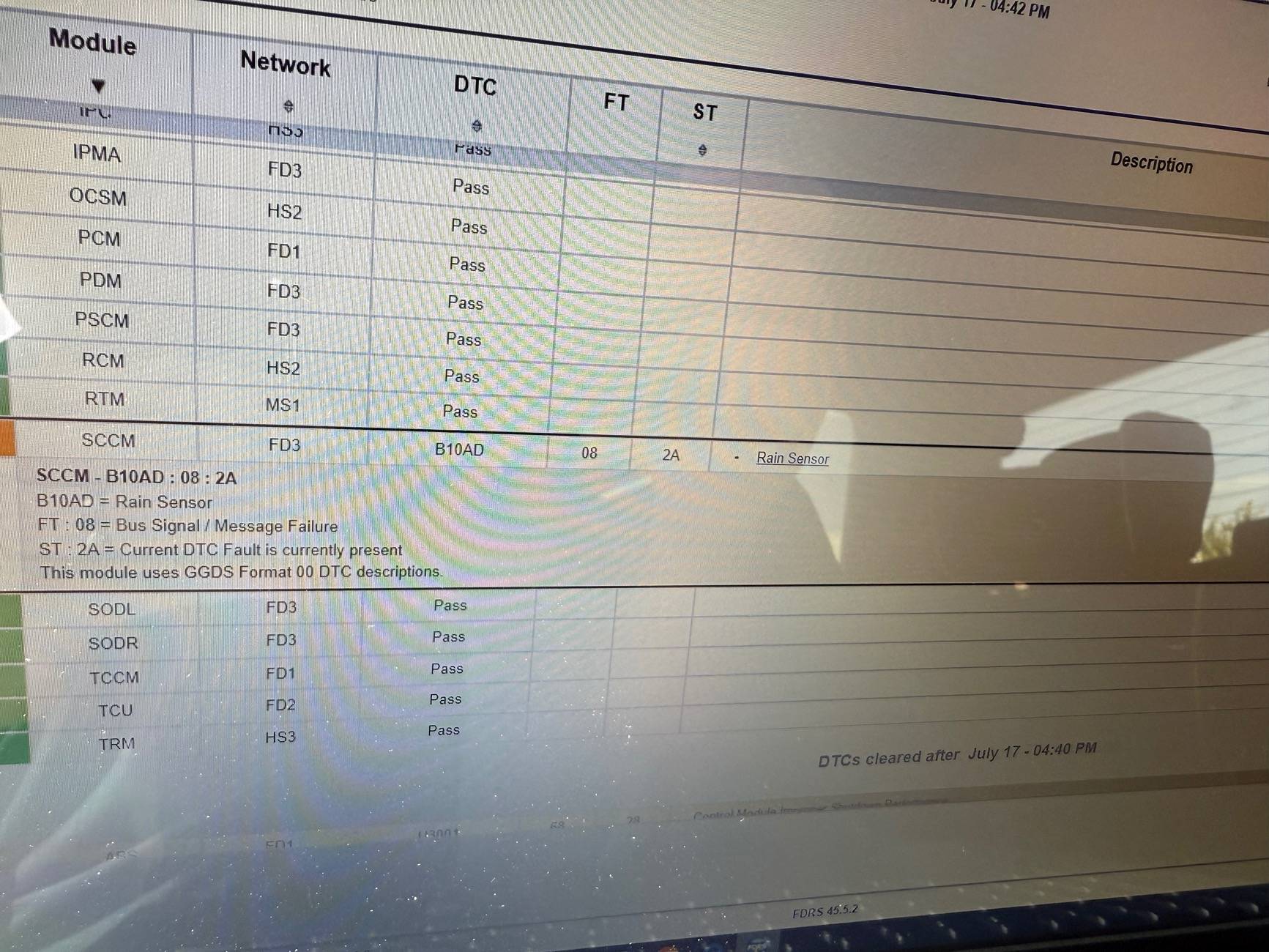

So I keep getting a code for the rain sensor, but I don’t have the auto wipers. Anyway to get rid of this?

Try clearing codes and then running a self-test on the SCCM. Did you make any FORScan changes to the SCCM?

It’s been there since I’ve owned the truck. I’ve tried clearing and it was there before I ever did any forscan changes. It just won’t go away.

If you don't have any problems, then I would ignore it. According to your ab data, you have a 09 here in the SCCM which means rain sensing is disabled:
Ford F-150 ECU module programming guide using FDRS 1752790445239-4
The only thing I see in the SCCM that has to do with this the rain sensor is here, but it does show what the value there does on the spreadsheet. You show a 5 there now and my truck shows a 7. You can try writing a 0 there as a test to see if that means no rain sensor is there and it clears the code. If it doesn't work, put it back to whatever is there now.

Thank you,
I’ll try that tomorrow and see if it clears out. It doesn’t cause issue, just a soft code.
No dice. Still showing the rain sensor issue.

Damn.....idk, man. You may want to post on the FORScan specific thread to see if any of the guys that follow that thread can help.
