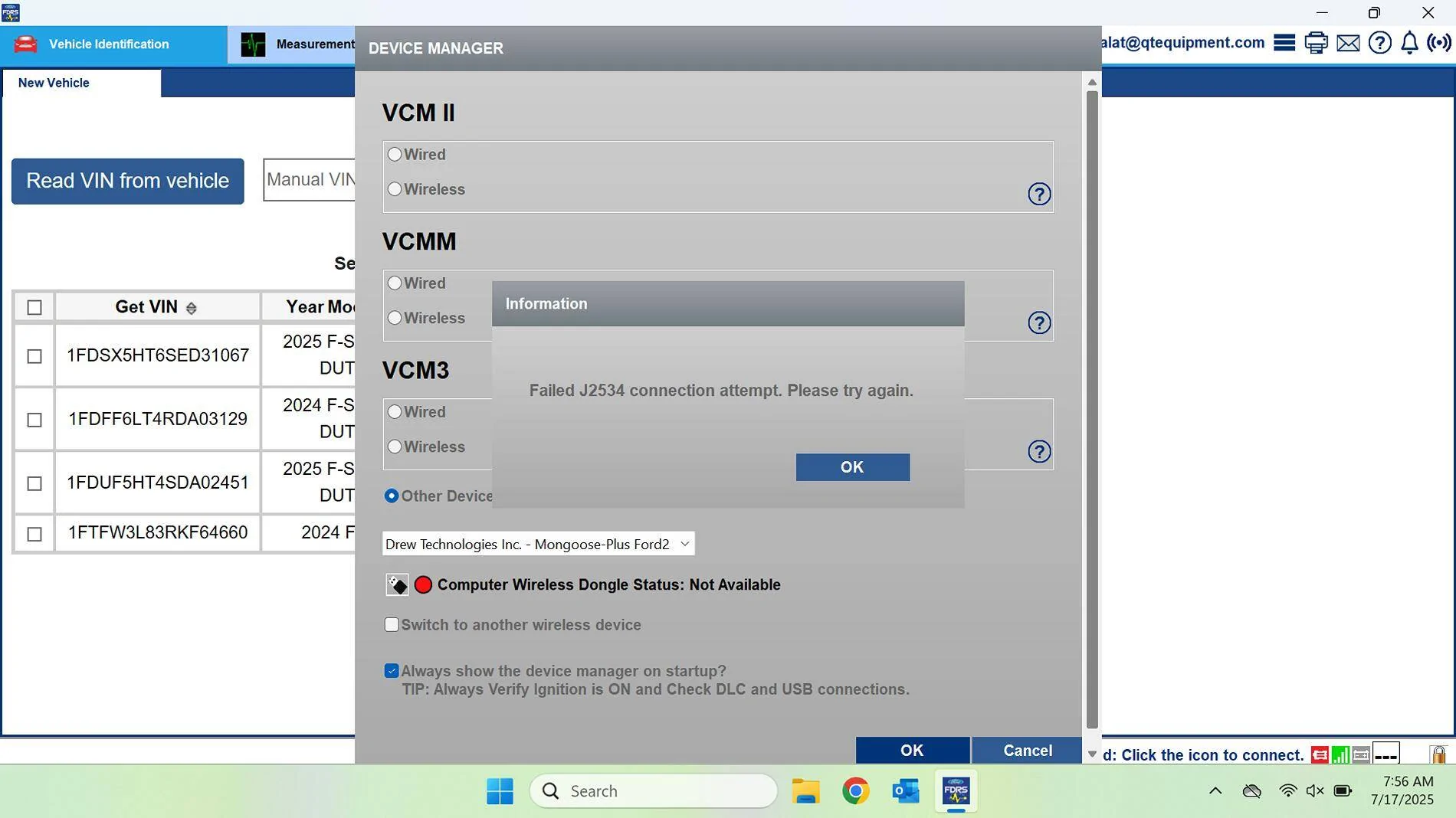

jfalat
joe
Sep 27, 2023
293
akron ohio
2024f150 crewcab xlt 3.5
truck upfitter
here is what i get when connecting the mongoose to laptop and not vehicle.

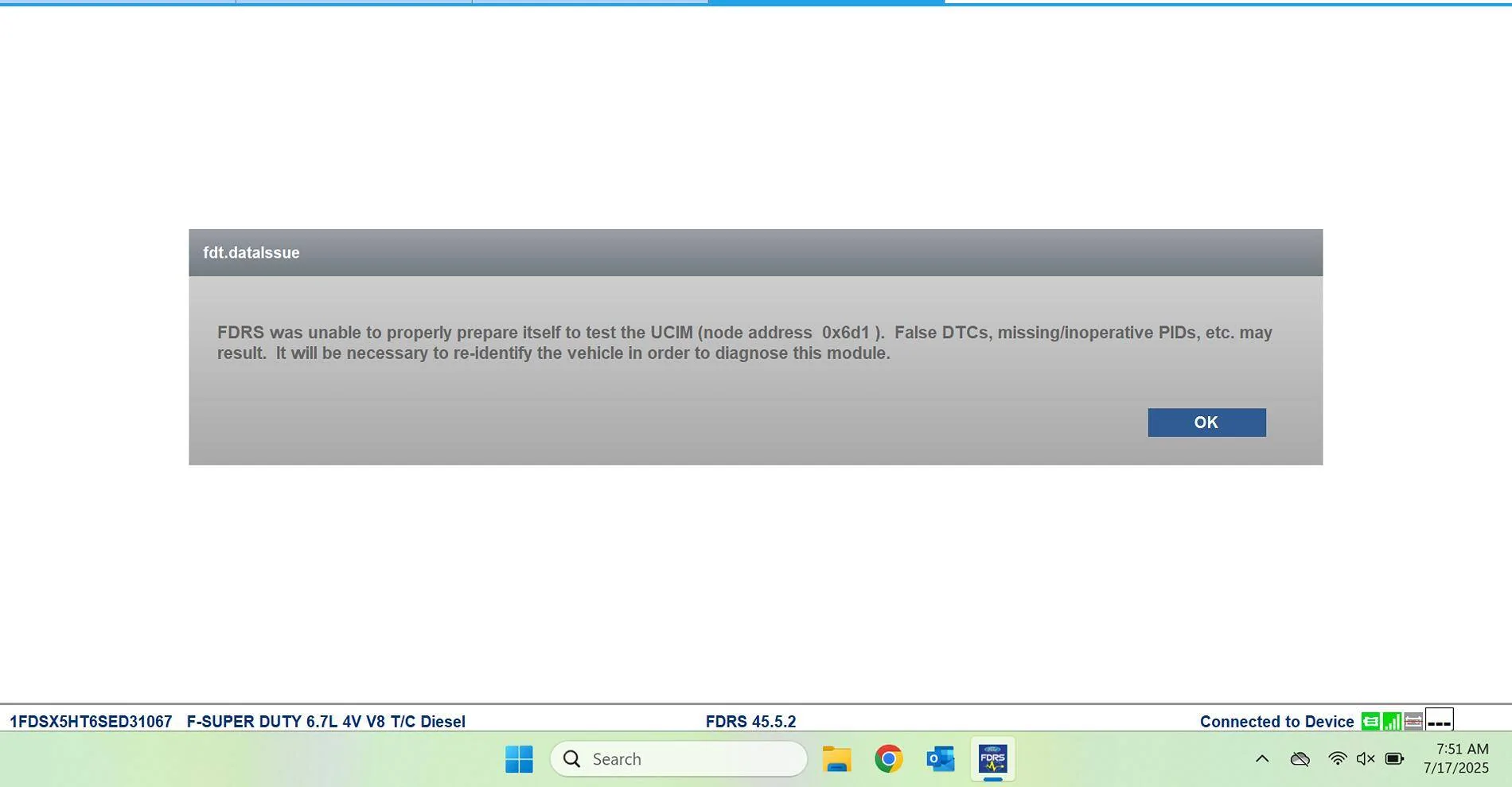

jfalat
joe
Sep 27, 2023
293
akron ohio
truck upfitter
getting this error also once connected to the vehicle, but
Ford F-150 ECU module programming guide using FDRS Screenshot 2025-07-17 075118
the self check still works
