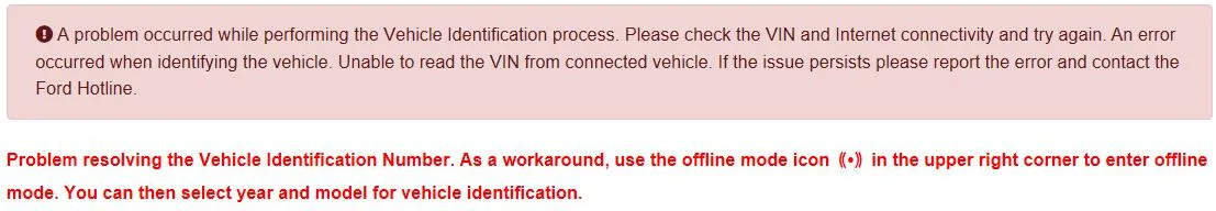

No more updates showing and I'm only up to 23291. And when I logged out and restarted my laptop and logged back in and hooked everything up, I get this error message from FDRS. The mongoose is connected because I have green status lights on the bottom and it's showing the correct battery voltage. Any ideas?
Hmmmm.....not sure. Can't say I have seen that before. I turn the truck off and let is sit locked for a half hour or so and try again.
It is possible you cannot update any further past where you are until Ford releases more updates for your VIN.

Just took it for a drive and came back and hooked everything back up. Now I don't get an error and it's communicating with the truck fine. But I still only have 2 updates available (not really), BCM and ACM (which I've done at least twice).
