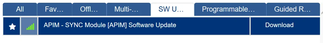

I had the BCM module in FDRS and held off after all the ruckus. Now it's gone; only thing left is the APIM. Any thoughts? Hopefully I didn't miss any previous posts.
They pulled the bcm update so nothing to do. The apim is 22293
