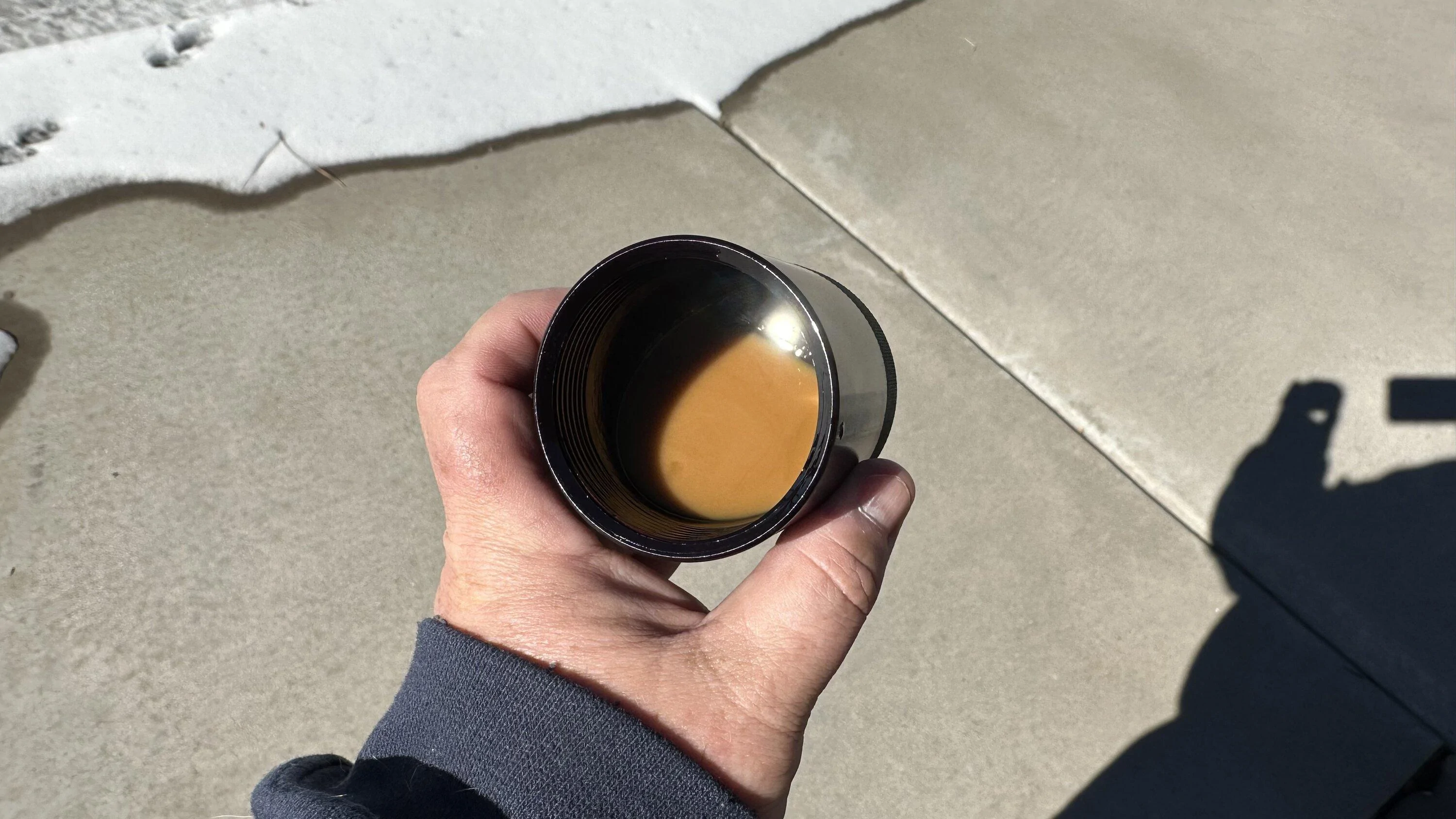

Checked my oil catch can after about only 500 miles… my truck has about 8200 miles on it. Looks like it caught about an oz. of coffee looking moisture. Yuck. Glad to see it’s working. But I can see why Ford doesn’t install these by default… it adds an additional maintenance item (especially in cold temps) and I’m guessing bad things will happen if not emptied.
Had the same amount in mine when I emptied it yesterday.
Let that moisture go back down the intake naturally. You could exhale all day through a catch can and collect quite a bit of moisture in it. You'd look mighty funny doing it.
