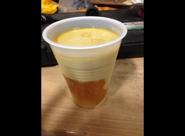

I'm not sure it is as critical on the newer 3.5 Ecoboost (and Powerboost) that have the direct and the port injection.
The port injection will help clean the valve and combustion chamber of the EGR PVC goop But It definitely cannot hurt to keep that crap from being put into the entire intake side, inlet tubes, intercooler, turbos, etc.
These pics are of a UPR kit I installed on my 13 3.5 Eco after i upgraded the intercooler and saw what looked like nasty oil change poor out of my stock intercooler..... My son still has this truck, runs great. Still screws?
I'll be installing a J&L Catch Can Kit on my 22 PB in the next week or so.
Good Luck
Ford F-150 Catch Can? IMG_7446
Ford F-150 Catch Can? IMG_7445
Ford F-150 Catch Can? IMG_7450
In colder temps it is not unusual for there to be a large increase in collected volume of liquid water and fuel, as a result of condensating vapors that otherwise wouldn't have liquefied, but rather passed harmlessly through the combustion chamber. So it can be a little misleading. And in really cold conditions the system could actually freeze and block/plug the flow.
As for potential negatives from a poorly designed catch can solution,........ a malfunctioning check valve, or collapsed or blocked lines, can result in unintended high crankcase (-neg)vacuum or (+pos)pressure that can wreak havoc on things like rear main seal leaks, ring pack loads, and oil flow irregularities.
As long as it's properly installed, designed to perform properly in all conditions, there's likely no harm. I'm just not convinced it's addressing a serious issue, but rather introducing a potential for one.

That came out of your intercooler? Around 8oz of oil??

No, that came out of the catch can, in @2500-3k miles.
It separates like that after sitting for a few minutes. Nasty mix of oil, gas, water.
Note: The PCV still works to let the engine breath to get rid of moisture, etc. Just the catch can gives the ability to trap most of the goop before it gets back into the engine.

Holy Sh** I’ve never seen that much come out of a catch can that quickly. Cold weather/short drives?
My PB barely covers the bottom of the catch can every 1,500 miles.
The desparity between the quantity and makeup of the contents of two similar trucks (engines), should at least make one wonder?

As stated, its from my old truck. 2013 3.5 Eco with mods.

As far as oil in the intercooler or charge piping, that person prolly has a bad turbo. Unless someone is dumping oil in their air cleaner, Really the only way for oil to get in there. The PCV system is in the intake, Which is where the goop would be. The charge piping and intercooler is between the turbo and intake. Far from the PCV system. A bad oil shaft seal could definitely leak oil into the charge air which would wind up in the intercooler.

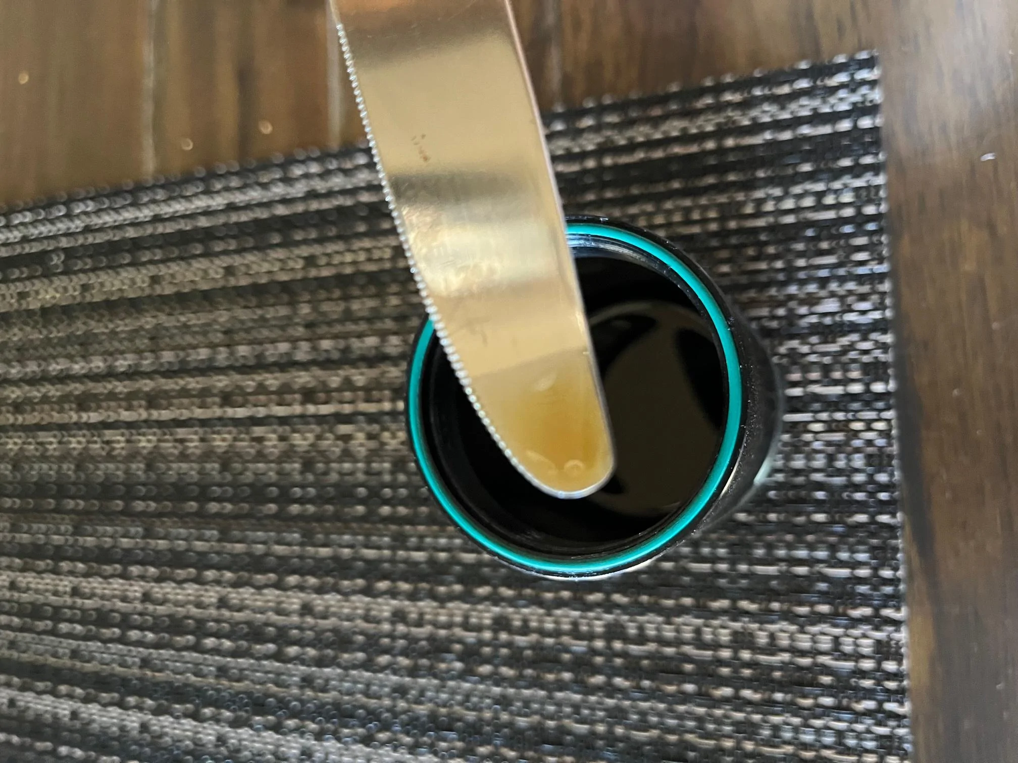

Finally got around to posting my 1K miles UPR catch can results. To my surprise, I don't see any indication of condensation mixed with the oil. When I emptied the catch can, it looked similar in color to the oil I drained from the oil pan; dark amber. Any way, I wanted to measure the amount of oil with a popsicle stick, if only I had one, so I used a kitchen knife (shhh don't tell my wife, yes I wiped it off and some times use them as a flat blade screw driver)...
Ford F-150 Catch Can? IMG_2608
As you can see, I have about 1/2" of oil as shown on the knife tip...
Ford F-150 Catch Can? IMG_2610
It may not seem like much and the port injection helps the intake valves, but I'm not sure where this oil would pool inside the intake manifold if I didn't catch at least some of it.....
