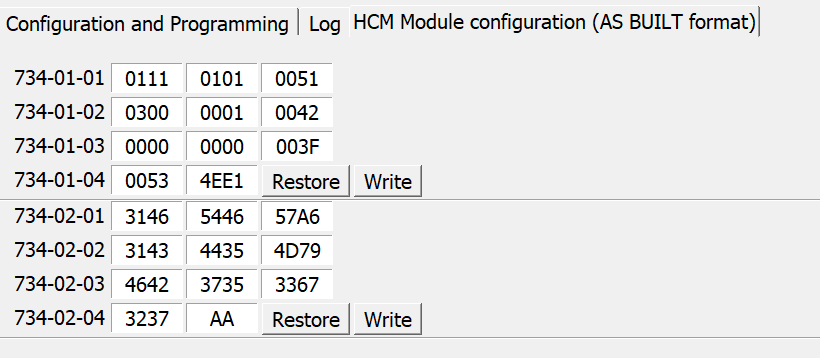

I’ve updated and no errors. Appears it is working but don’t see the menu option. Here are my settings. Did I miss anything?

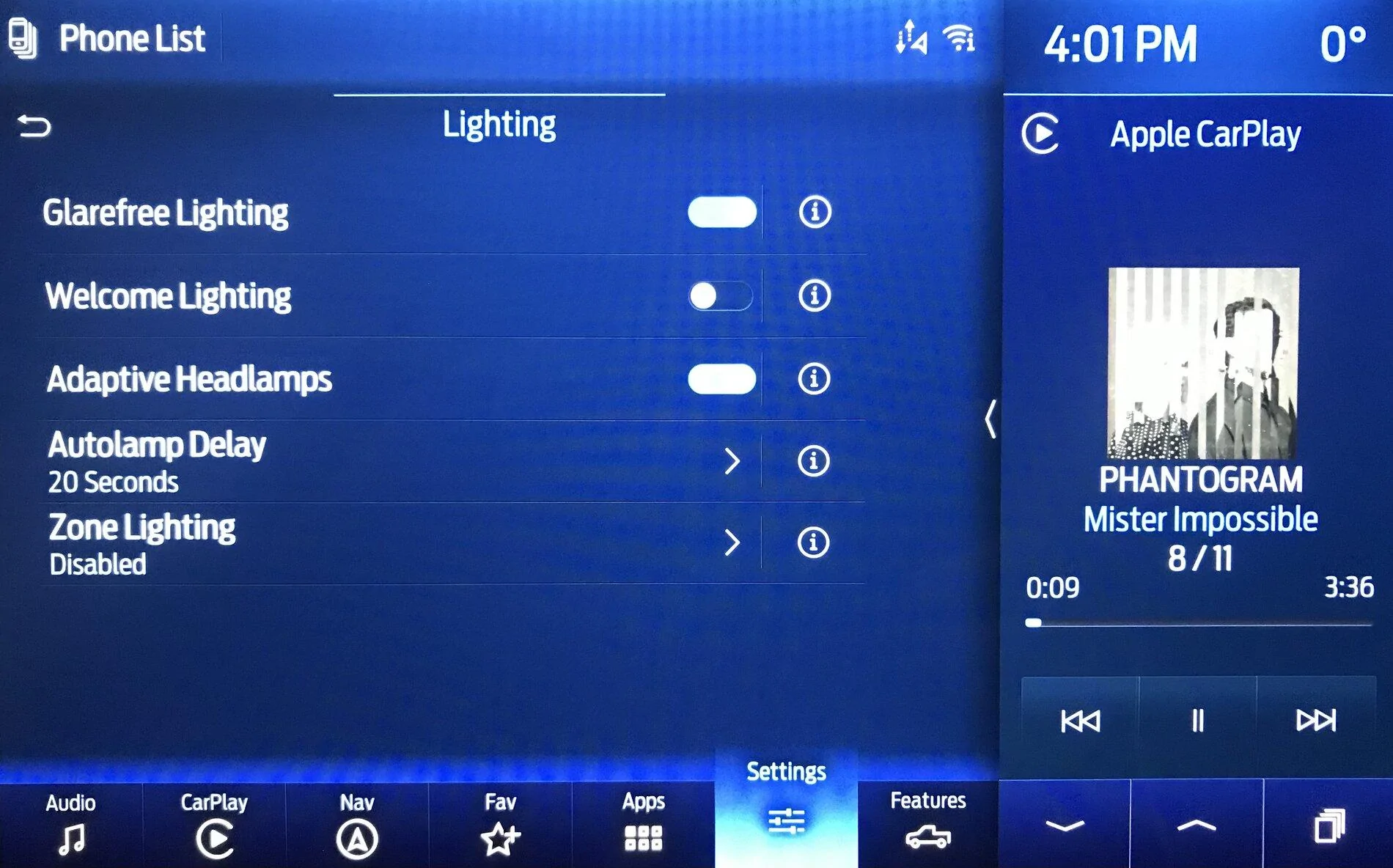

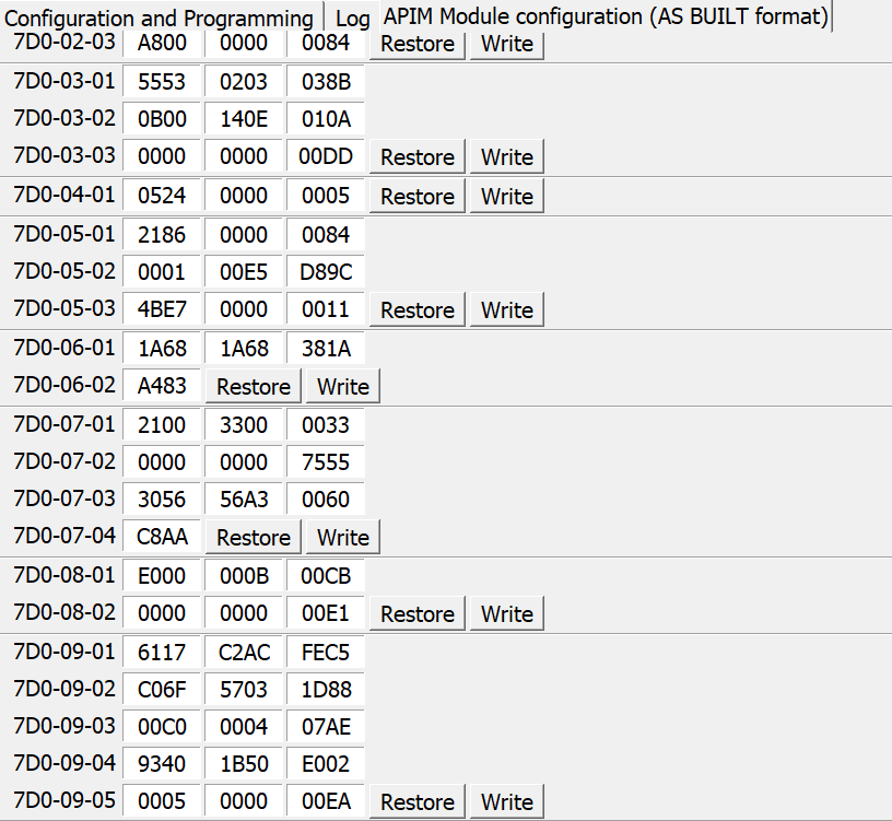

Changes to the APIM (Sync) menus take a power cycle or two to show up. The easiest / quickest way to make that happen is go to the wrench icon in FORScan and do a module reset on the APIM. It will cause the screen to restart and you should see Glare Free in place of the auto high beam selection.
The module does not power down immediately after turning off the ignition. The truck has to sit for awhile for it to happen “naturally”.

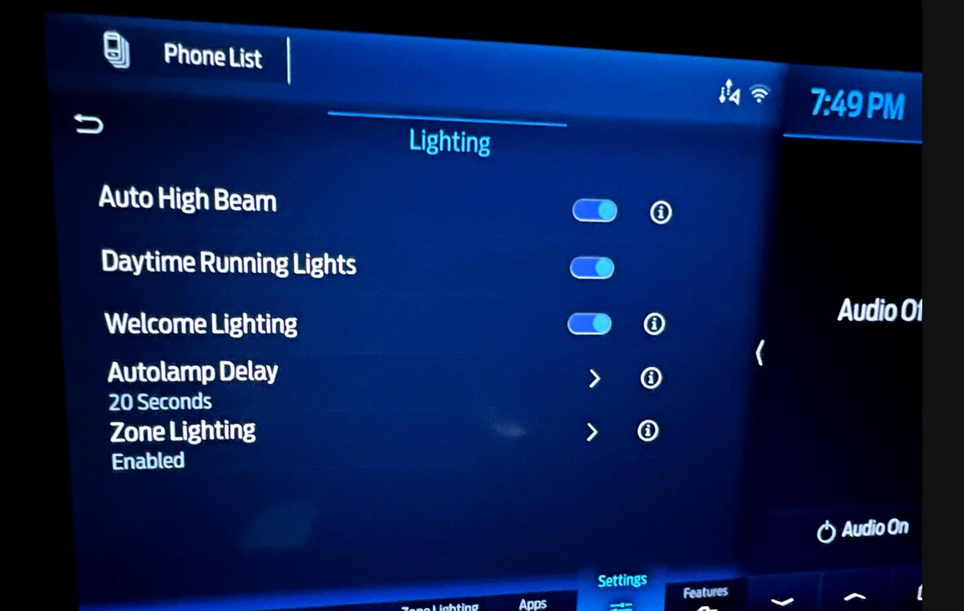

For those not comfortable with Forscan, another hack to enable anti-glare is to move to Canada and buy a truck here. I had no idea my truck even had this option until seeing this thread, and couldn’t figure out the weird and confusing highbeam dimming. Now that I know what’s going on, I’m impressed. I can’t imagine this not being rolled out OTA on US trucks.
