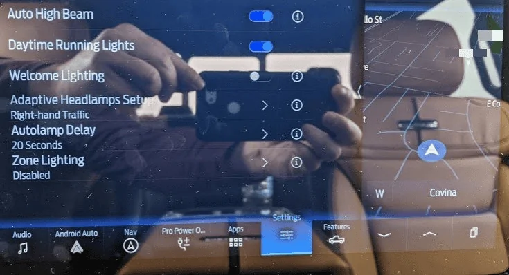

A few additional steps to try. If you haven't already go to the wrench icon in forscan and reset the HCM to force a power cycle.
The other thought I had is potentially the APIM is feeding the wrong steering / traffic direction. It appears earlier versions of sync had an additional menu option that appeared where the traffic direction could be selected. That is not case on later vehicles like mine, but I have no idea where the break point was.
Ford F-150 Adaptive Head Lights - Coming to the US??? 1637418009154
In lighting setting on the sync you should see "Glare Free" where Auto High Beam is in this image. If you have the "Adaptive Headlamps Setup" menu as above that need to be set to Left-hand traffic. That menu no longer appears on later versions.
