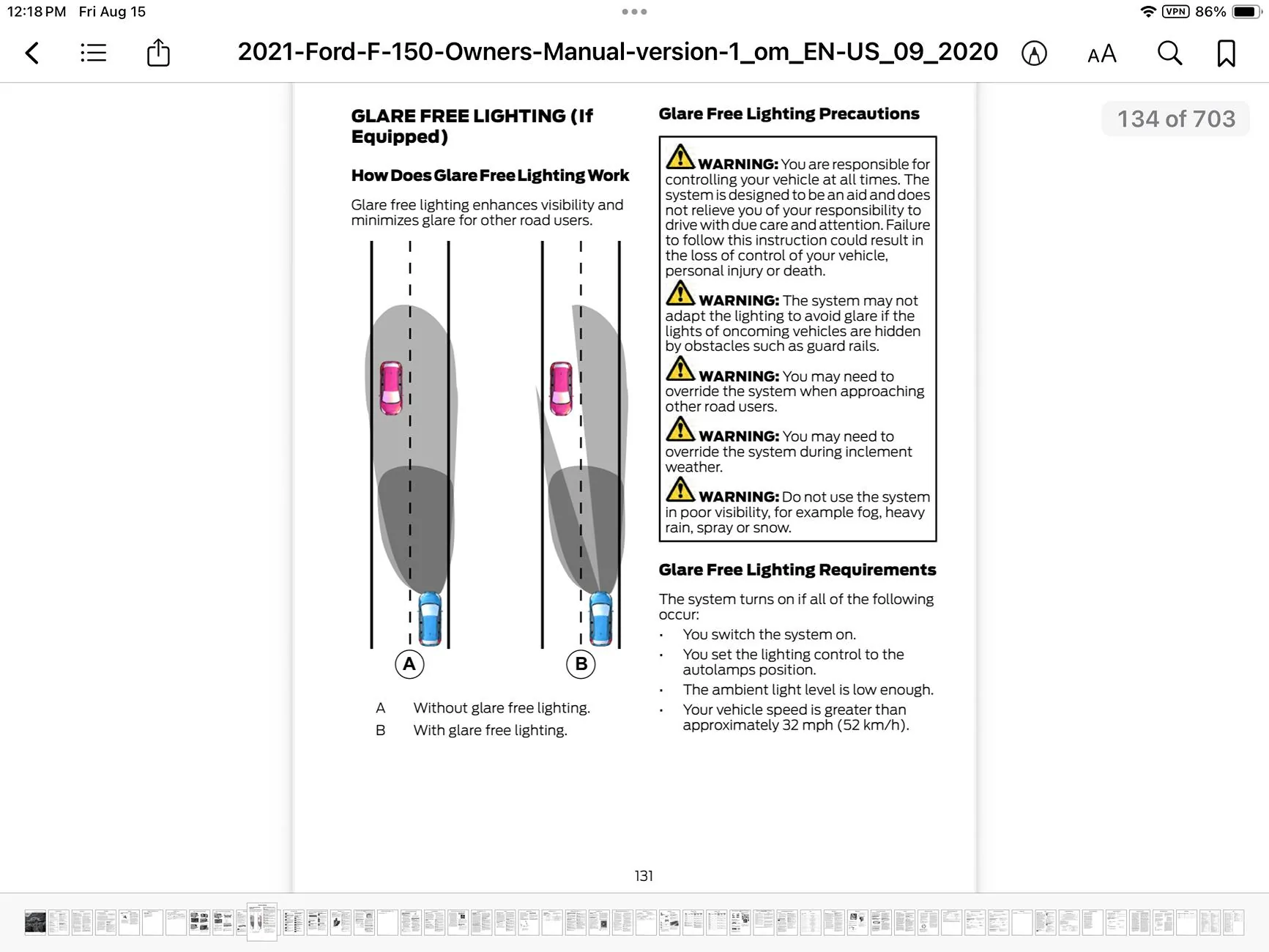

Can someone explain what the glair free headlight is? Not sure why it's so coveted.

On the very first page of this thread is this link
https://www.cnet.com/roadshow/news/adaptive-headlights-legal-us-biden-infrastructure-bill-law/
No need to read it just look at picture. If that doesnt help its basicly full time high beams that shuts off/dims sections of the headlight to not blind oncomming drivers.
And as far as I have seen 2024 and up removed the hardware for glare free.
^^^^^ this
That's exactly what you will experience and once you see it, you can't un-see it. 😁
It's borderline elegance, in my opinion. The fact it's possible, yet NOT mainstream in the whole world is crazy.
