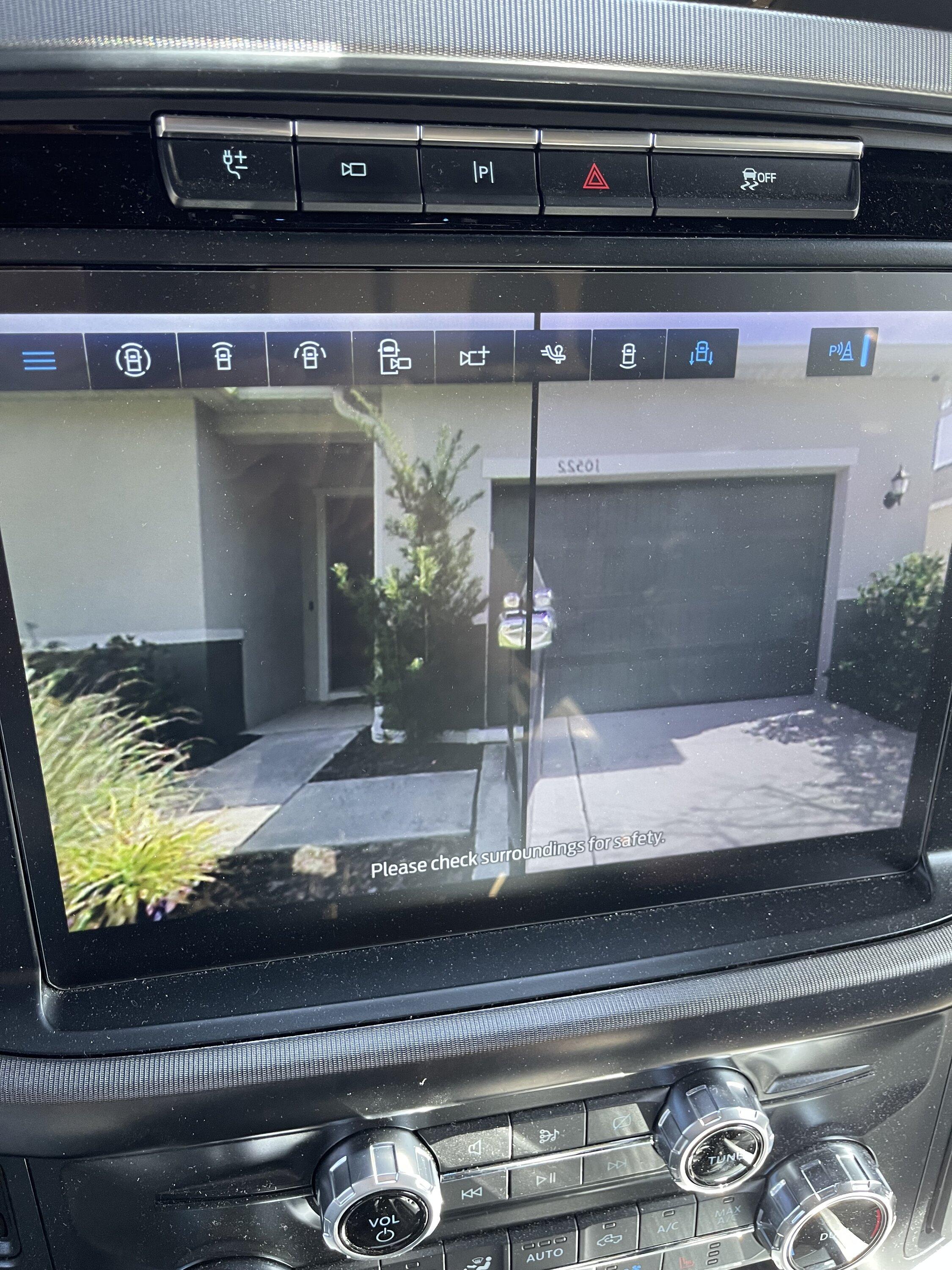

I only activated rockcrawl mode in rear view. Was this an error? Should I had activated in front as well???

You get a new soft button in addition the the existing rear view. So, yes you can switch between the two views.

how does one get all those damn camera views?!
are all those available in motion?
i feel like i cant keep up at times haha
Yes. All these are available while in motion. Now if someone can figure out 360 in motion faster than 6 mph that would be awesome.

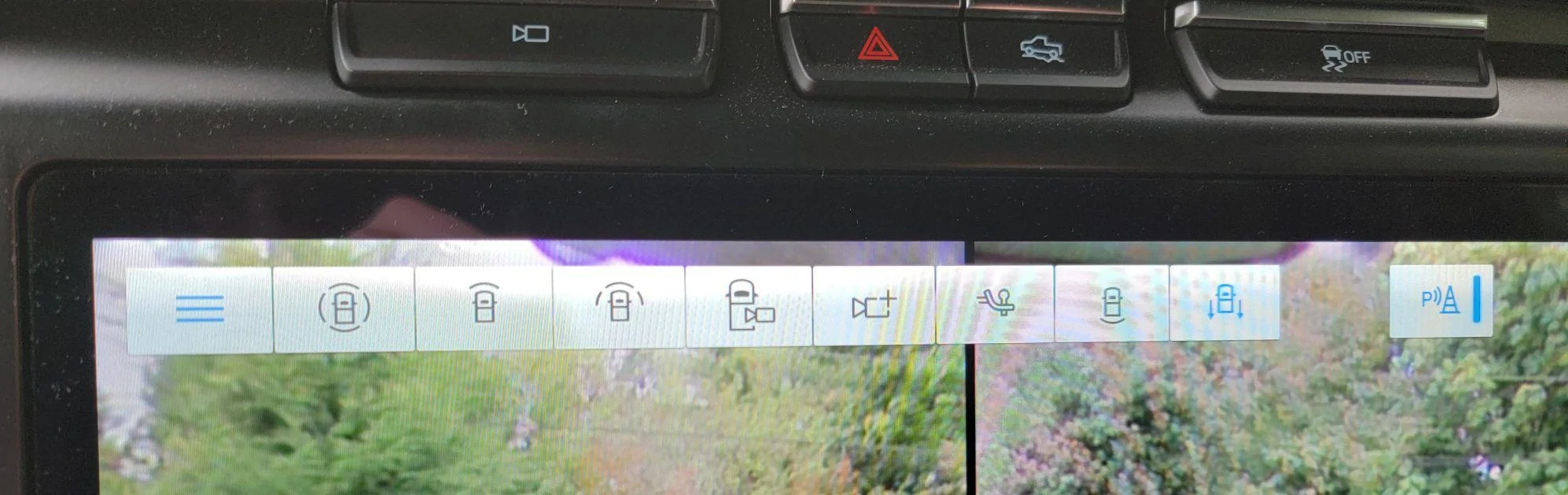

guess i need to go back and look at the forscan spreadsheet. other than the 50/50 are the others available without the newest IPMA update from FRDS?

The 360 cams came with most of those views. The one next to 50/50, the rear cam in motion came last year I believe over OTA. The Forscan changes for it are on the common tab at the top.

Other than 50/50 because I don't have the IPMA update yet I only have the rear cameras at speed, the others are only available at slow speeds or when stopped even with the forscan changes.

I’m trying to figure out the same thing. I think the IPMA update is needed for all of this including the 50/50 view at speed. I have everything enabled in Forscan, and have the soft button, but it doesn’t work just yet (I don’t have the IPMA update).
I can, and always have been able to see the 50/50 view when doing the trailer backup, but that is it.
Looks like mau47’s post above supports this.

That is my understanding as well. The 23s supposed have the required IPMA update needed for 50/50 view in motion while the 21s and 22s need the update through FDRS or OTA whenever that will be.

Just did the programming updates on my 22, installed the new IPMA software earlier this month. Works great, thanks!!!
