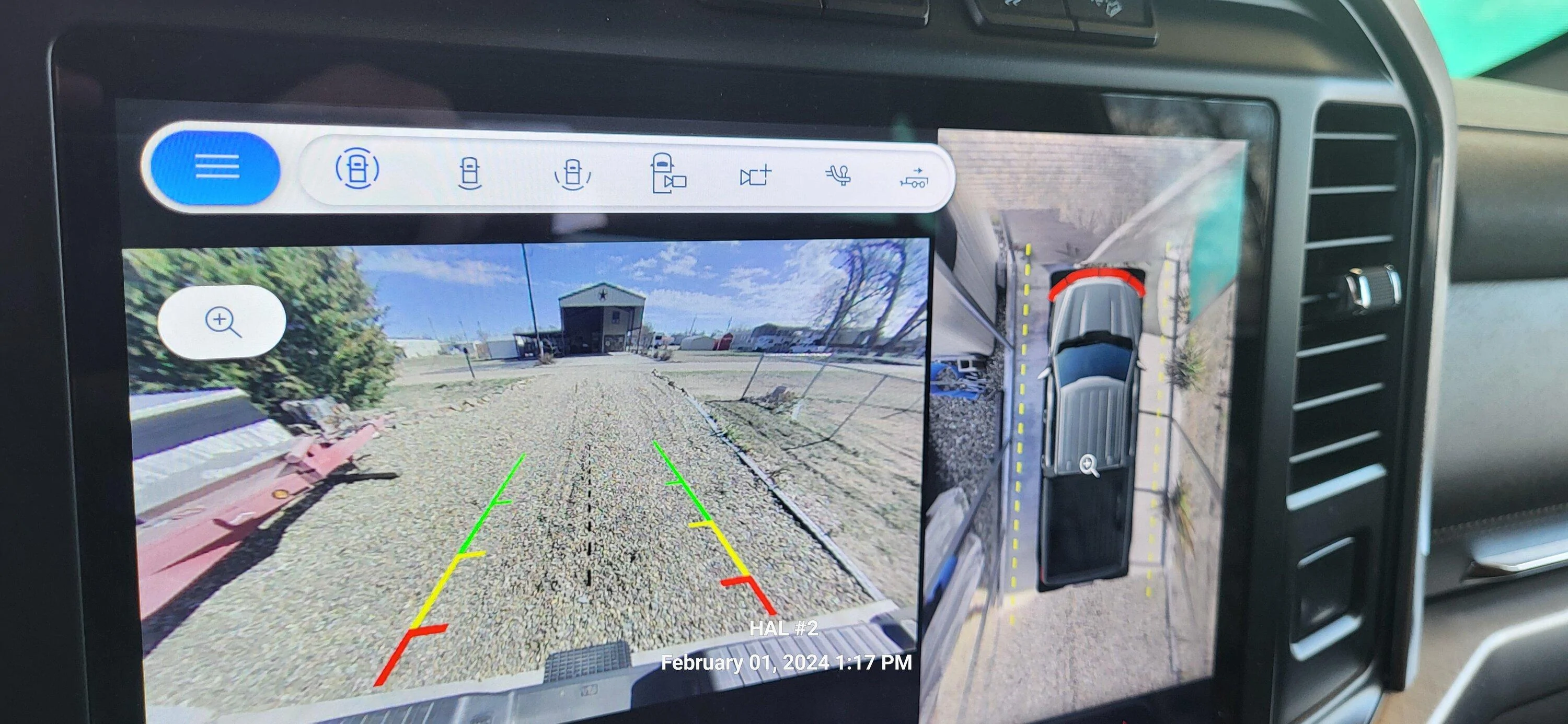

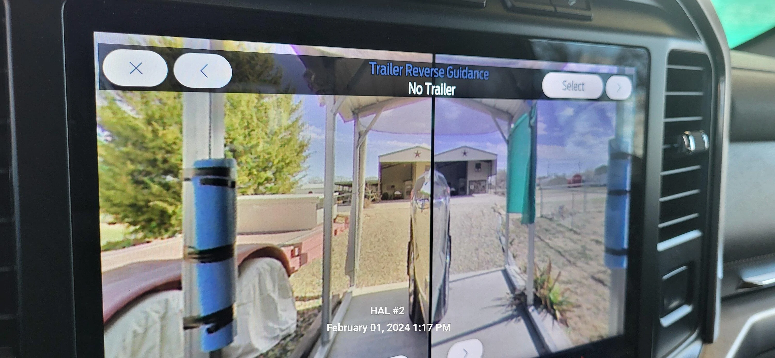

powerboatr
May 9, 2022
4,343
5,427
North East Texas, Piney Woods
2024 F250 King Ranch Chrome
Retired Navy Senior Chief
now i am confused
my 706 02 02 is E05F CE00 001E
THE 7DO 01 01 IS AO81 0802 BDC1
7DO 01 04 IS 02E4 FD20 603F
I tried changing the BDC1 in 7do 01 01 to FDC1 but nothing changed in the camera views
my on screen toggle does not show the above toggle on the far right
i still have to re-calibrate pr trailer back up assist from mondays APIM programming the dealer did as it wiped the gilbert trailer calibration
any guidance?
the split is truck running and in reverse
if i am in park, it does not pull up and turn signals in park or reverse or drive do not change screen views
thanks
