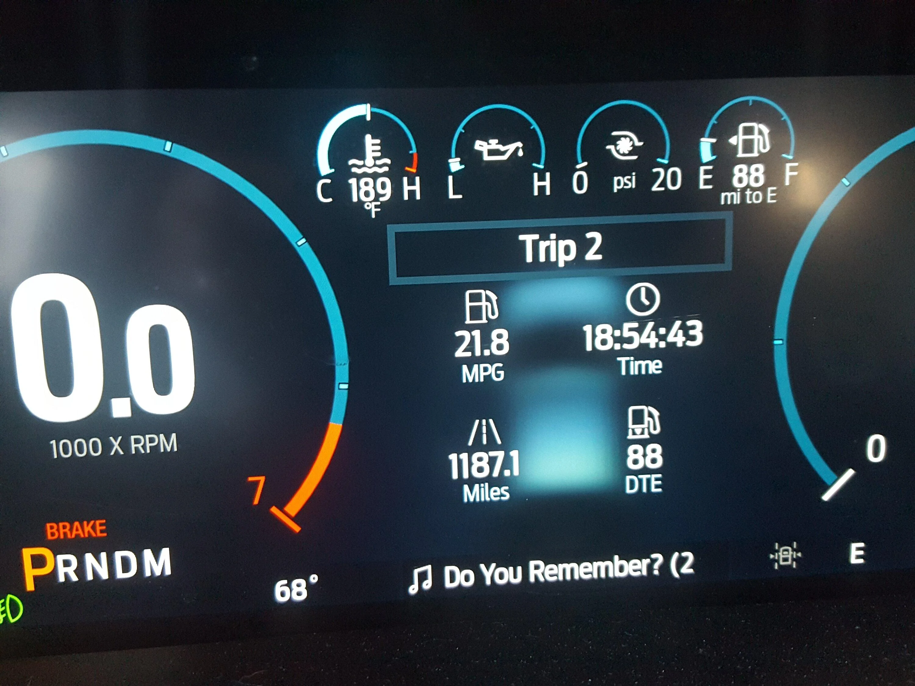

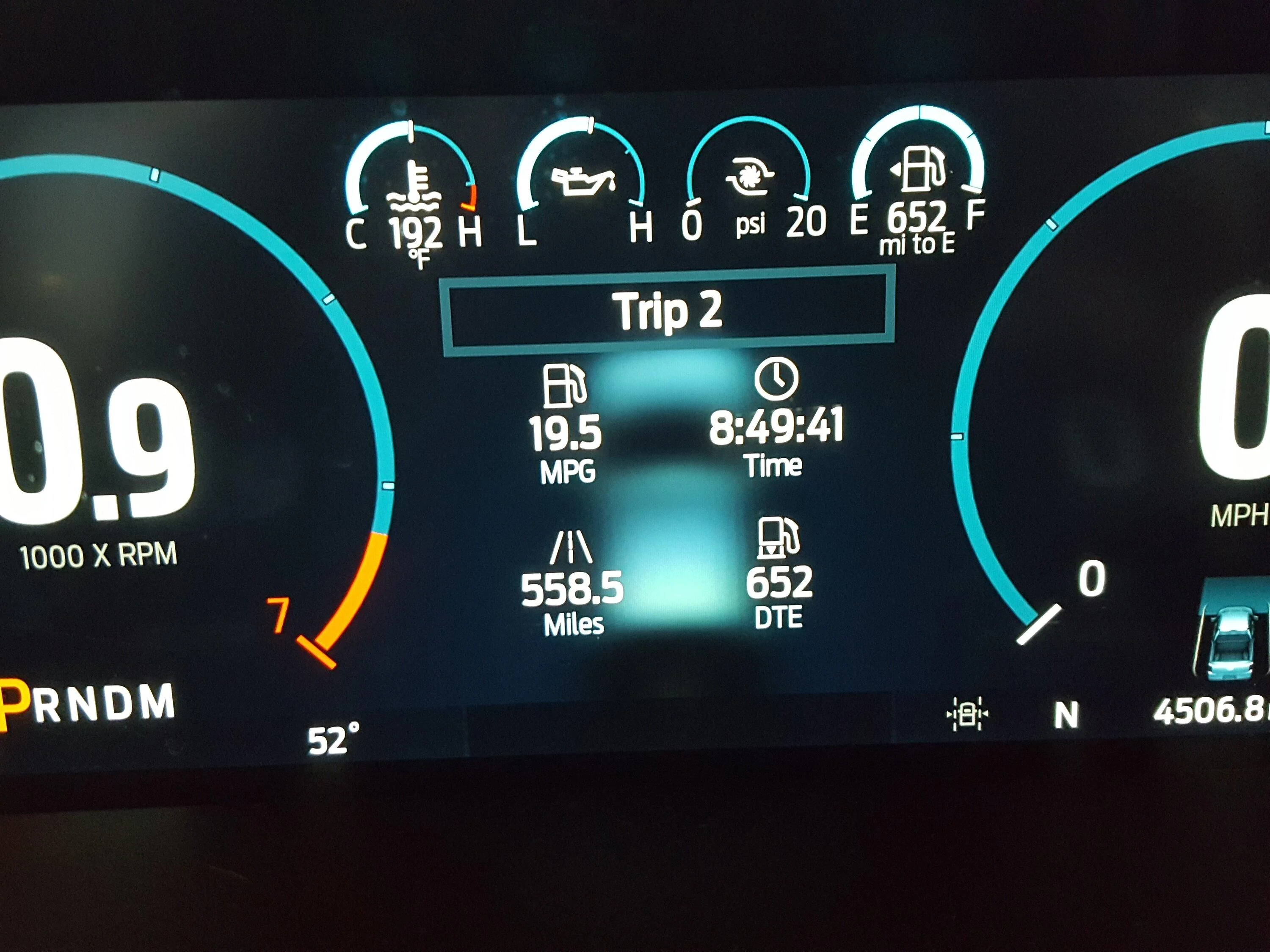

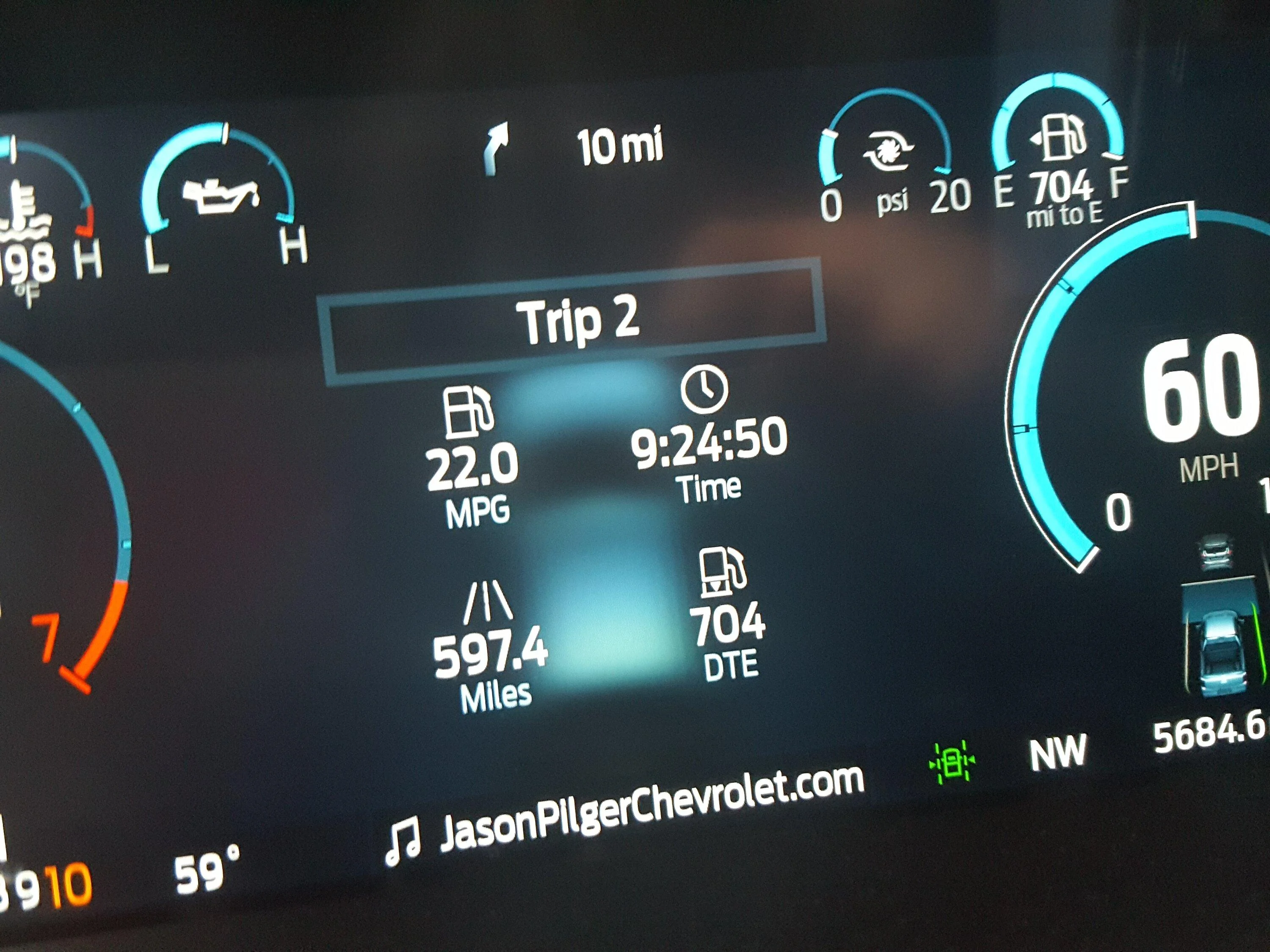

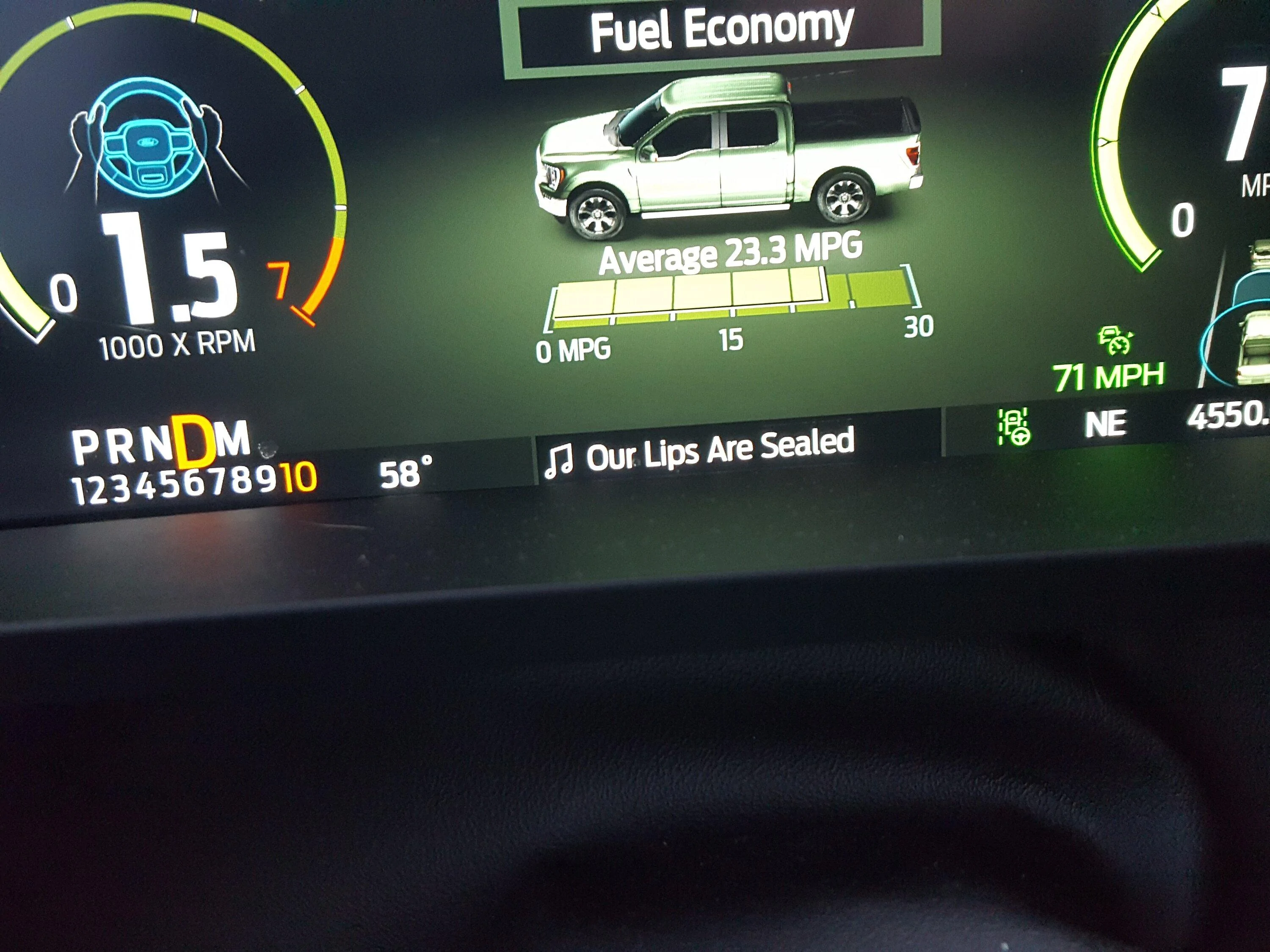

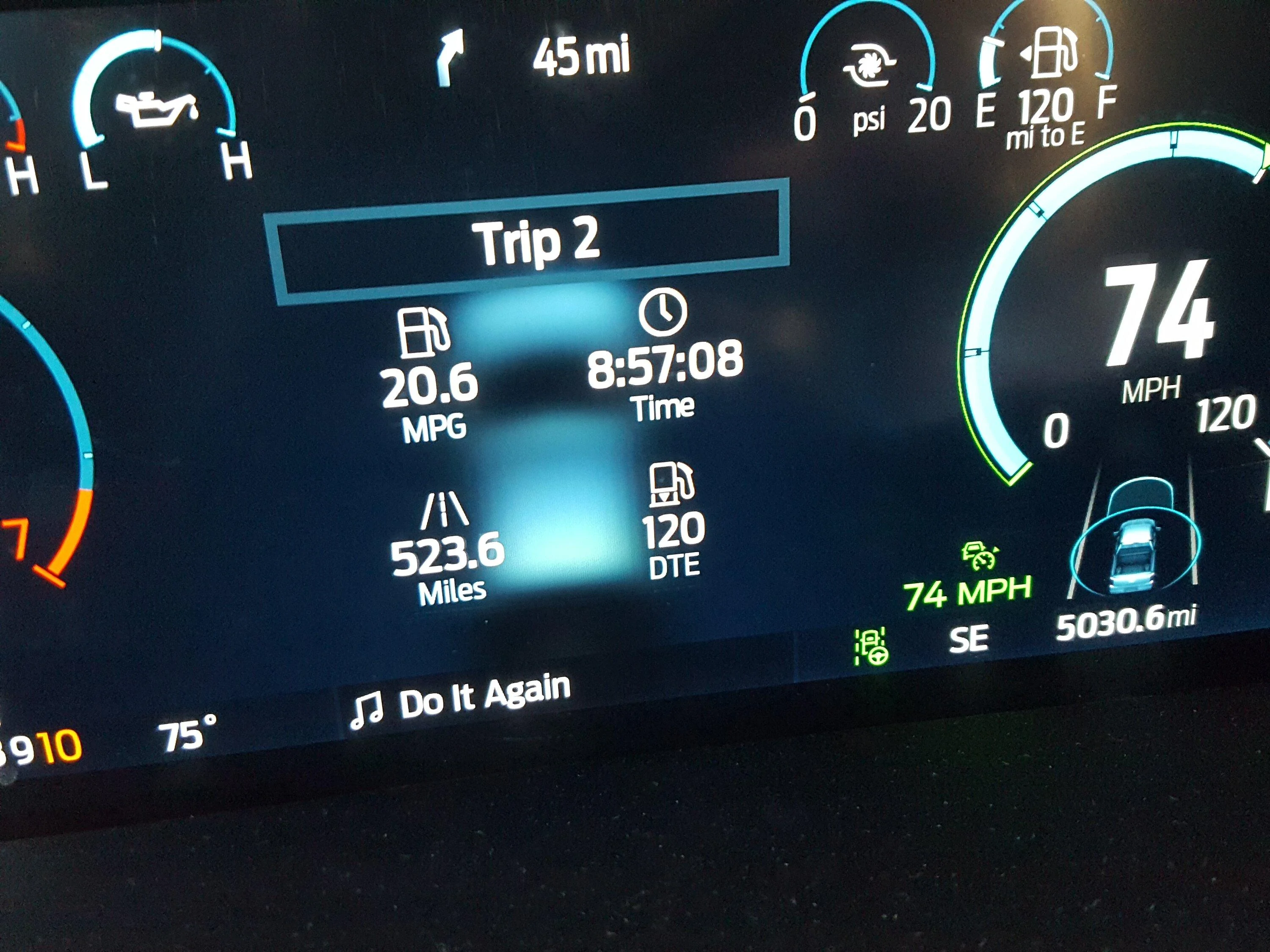

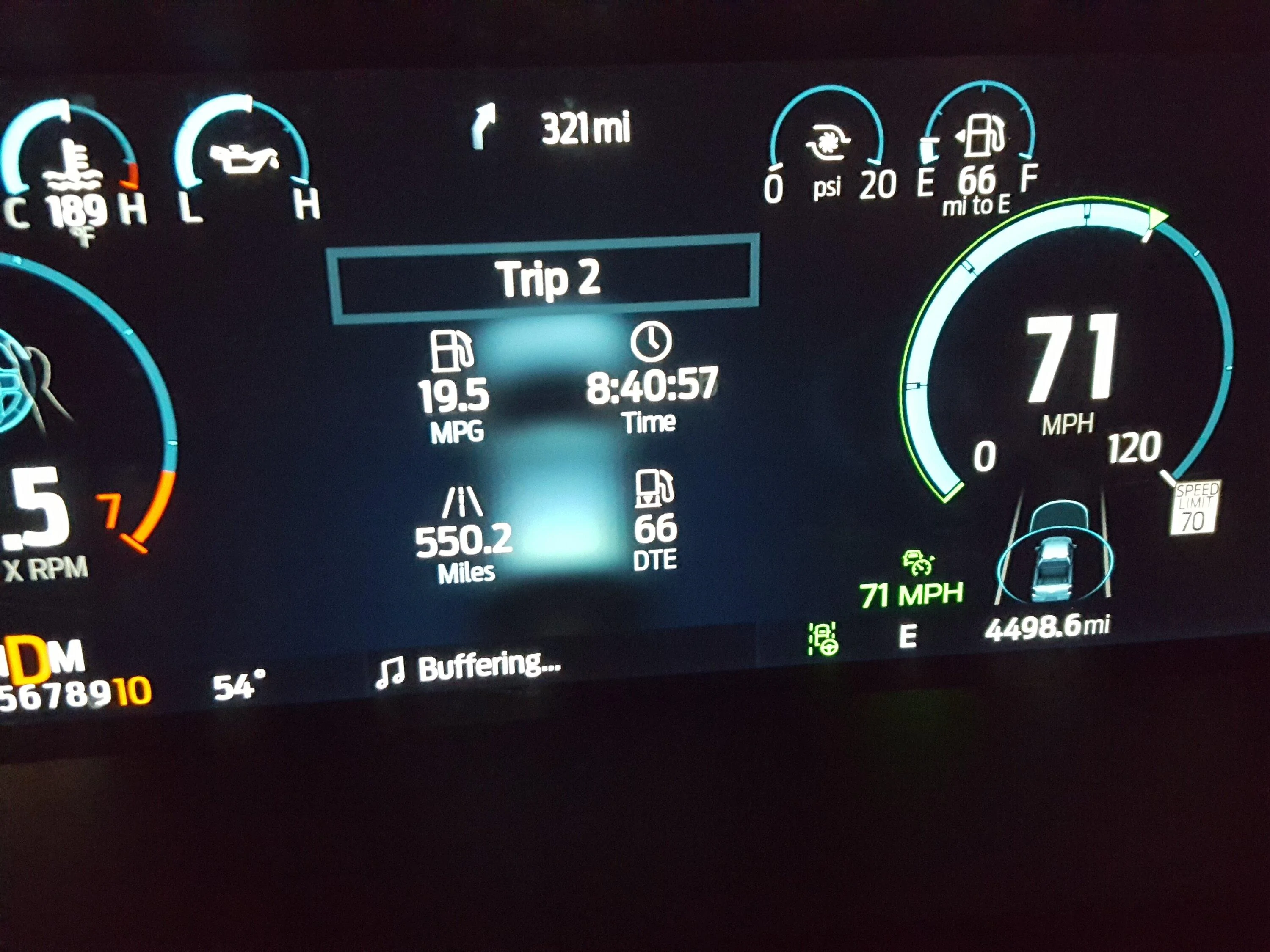

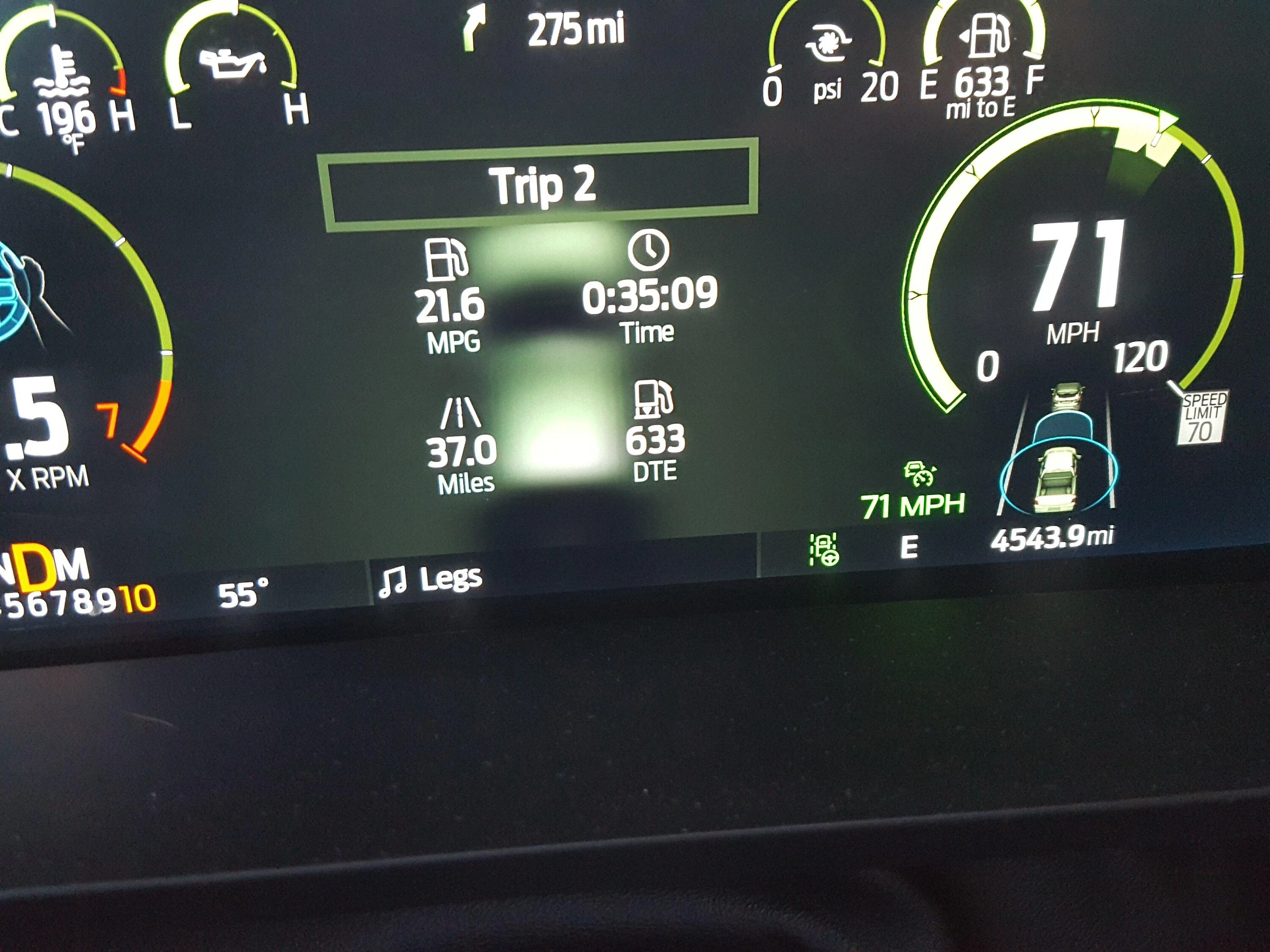

My local E85 pump tested at ~60%(?) if I recall.
I mix about 4 gallons in with 26 gallons of E10. (Powerboost has 30 gallon tank) I did the math at the time and it left me with a comfortable cushion under E20. Like you, I don't want to tax the oem calibration beyond E20
My main purpose for doing so is my fanaticism with KR/OAR/Timing on the ICE. The PIDs clearly indicate that there is harmony in the combustion chamber and the truck is happy. And since the Powerboost still gets me north of 650 miles a tank, I don't think I'm giving up enough fuel economy to spoil the party.
I absolutely love the torque management software Ford has on the Ecoboost. I've owned a few of them over the years and they have dialed it in nicely for an oem calibration. Truck is amazing!
