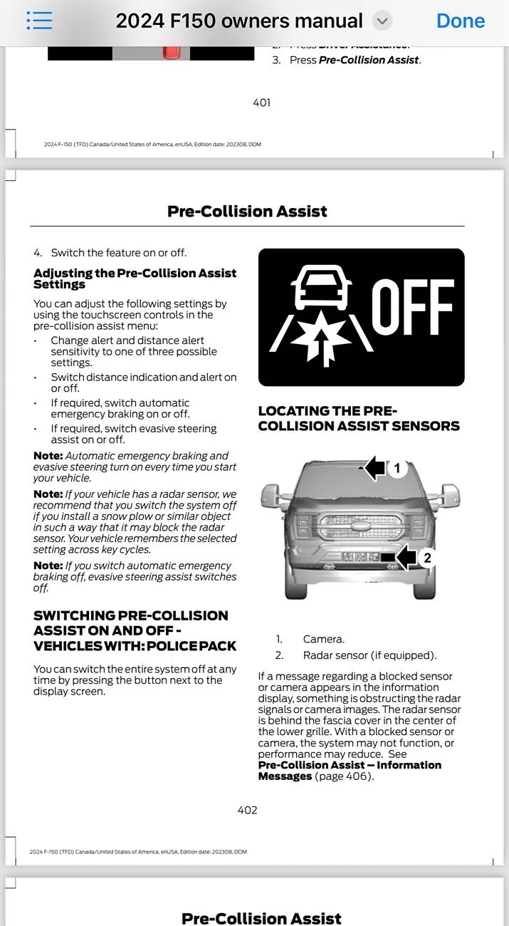

Noticed this warning light was on and off very randomly yesterday. But when I restarted the truck it went away completely. Anyone know what this is?

IDK for sure but I think it means collision avoidance is off.

This made sense because I remember now at the time the truck was driving toward the setting Sun, a lot of reflections facing us. Maybe the front collision camera lens got comprised momentarily.

Tail pipe fire ???
Or like mentioned rear Collison detection is showing a fault
Did you have tailgate down or a trailer ?
Backup assist and or sensors are dirty

Another one that has no idea how to open the user manual and read
