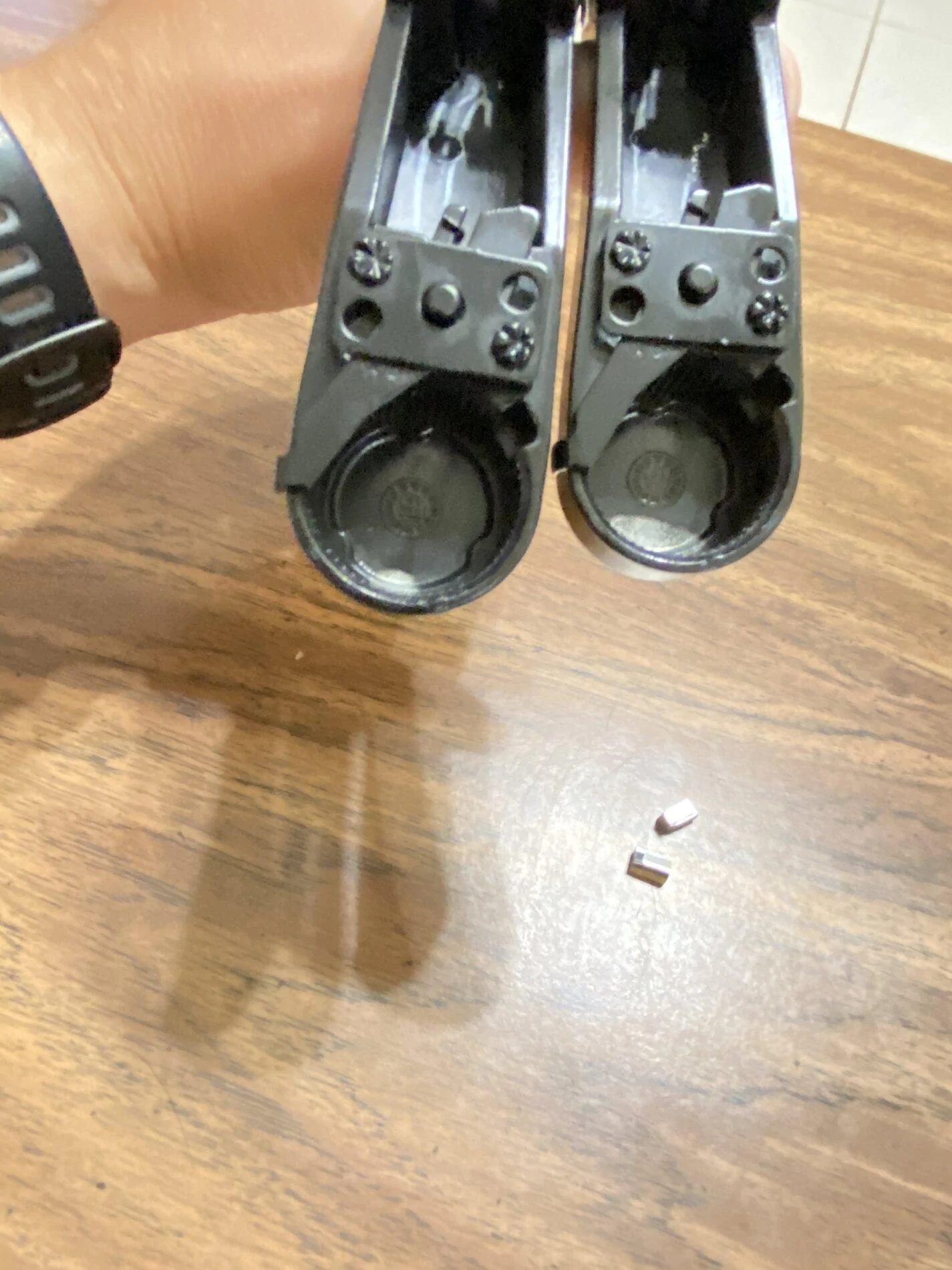

You guys were dead on. It was a wiper shim. I took off the wiper arms, and sure enough, there was no silver metal piece on either arm.
Ford F-150 $64,000 Question - What Is This? CAF0CEB6-60E2-479C-A9D9-891E523B4652
The shims didn’t seem like they fit in there snugly. They pretty much fell out as soon as I put them in and the bottom half was facing the ground . I’ve left them out so I won’t lose them. I will keep them in the glove box in case I need them for future use unless you all can advise if that piece is integral or not.

  • When reinstalling, it is it is possible to secure them in place either too high or too low on the windshield.
I originally put them way too high where the blades were way up on the windshield, instead of at the bottom. They both went on just fine, so I assumed they were on correctly, but it just didn’t look right to me, so I took them off and tired again.You have to be careful to put them back in the correct position.
I’d bet a dollar to a donut that there is a slot in that splined wiper post and that is what that key slips into for proper alignment.
Being splined, probably no big deal when positioned properly.
A dab of silicone sealant or crazy glue to keep it placed in the wiper arm would probably be just fine—not going anywhere once that arm is on the post.
I can see where that key protrudes beyond the splines, so there has to be a corresponding slot in the post. If I recall, my Crown Victoria was the same.

I was thinking some super glue to get them to stay. Was just reluctant to try that as my first option.

You're not alone, I found the exact piece on mine in the exact area.

Mine all fell out of my 2016 as well. I never put them back in, and never had an issue.

Thank you for the info. My only fear was getting into a heavy rainstorm where I would have to put the wipers through their paces, and one or both comes flying off because of those little pieces missing!

Just found both of mine had fallen out. Luckily they were both in the indent for the driver's side wiper.
Time for some super glue!
