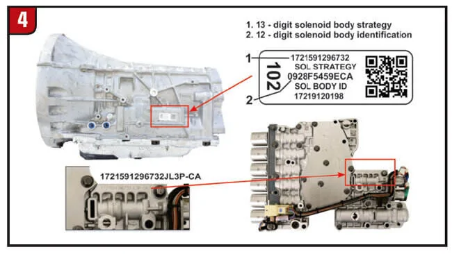

On the Ford 10R80 transmission models, the solenoid body/strategy identification is as follows: The 13-digit solenoid-body strategy number consists of only numbers (1). Letters are not used. Compare the solenoid-body identification and strategy to the solenoid-body identification tag located on the left side of the transmission case. If the solenoid-body identification and strategy displayed on the scan tool match the solenoid-body identification tag or replacement tag, then the solenoid-body identification and strategy are correct for this transmission and a solenoid-body strategy data download is not required. If the solenoid-body identification tag or replacement tag is missing or damaged so it is not readable or does not match the identification or strategy displayed on the scan tool, remove the transmission fluid pan and filter and locate the 13-digit solenoid-body strategy etched on the main control casting (Figure 4).
Ford F-150 Transmission Issue 10r80 (no more re-flashing?!) TD201810_SouzaSezz_04
The 13-digit solenoid-body strategy number displayed on the scan tool must match the solenoid-body strategy number etched on the main control. If the numbers do not match, damage to the transmission or driveability concerns can occur. If the new main control was not supplied with a replacement solenoid-strategy identification tag, DO NOT INSTALL the main control as all required programming information is missing. Compare the solenoid-body strategy identification etched on the main control to the solenoid-strategy identification tag on the transmission case. If the solenoid-body strategy identification etched on the main control does not match the solenoid-strategy identification tag, then a solenoid-body strategy data download is required. If the solenoid-body strategy etched on the main control does match the solenoid-strategy identification tag on the transmission case but does not match the 12 digit solenoid-body identification and strategy displayed on the scan tool, then a solenoid-body strategy data download is also required.

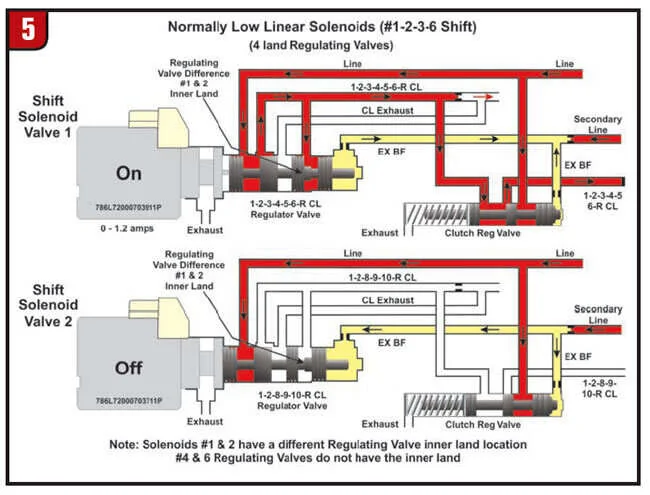

Let’s take a quick look at the hydraulic functions. Solenoids 1-6 are normally low linear solenoids for shifts and regulated line-pressure clutch control (Figure 5). When these solenoids are off; they provide pressure to stroke the clutch control valve allowing controlled line pressure into the apply clutch circuit. When turned on, no pressure to the control valve (stationary) line pressure will be blocked from entering the clutch apply circuit. The solenoid accumulator keeps the solenoid-signal pressure smooth. Both the power and ground circuits are controlled by the TCM. Note: Although these solenoids work the same way, each has a different part number for different flow rates and should be installed at their original locations.
