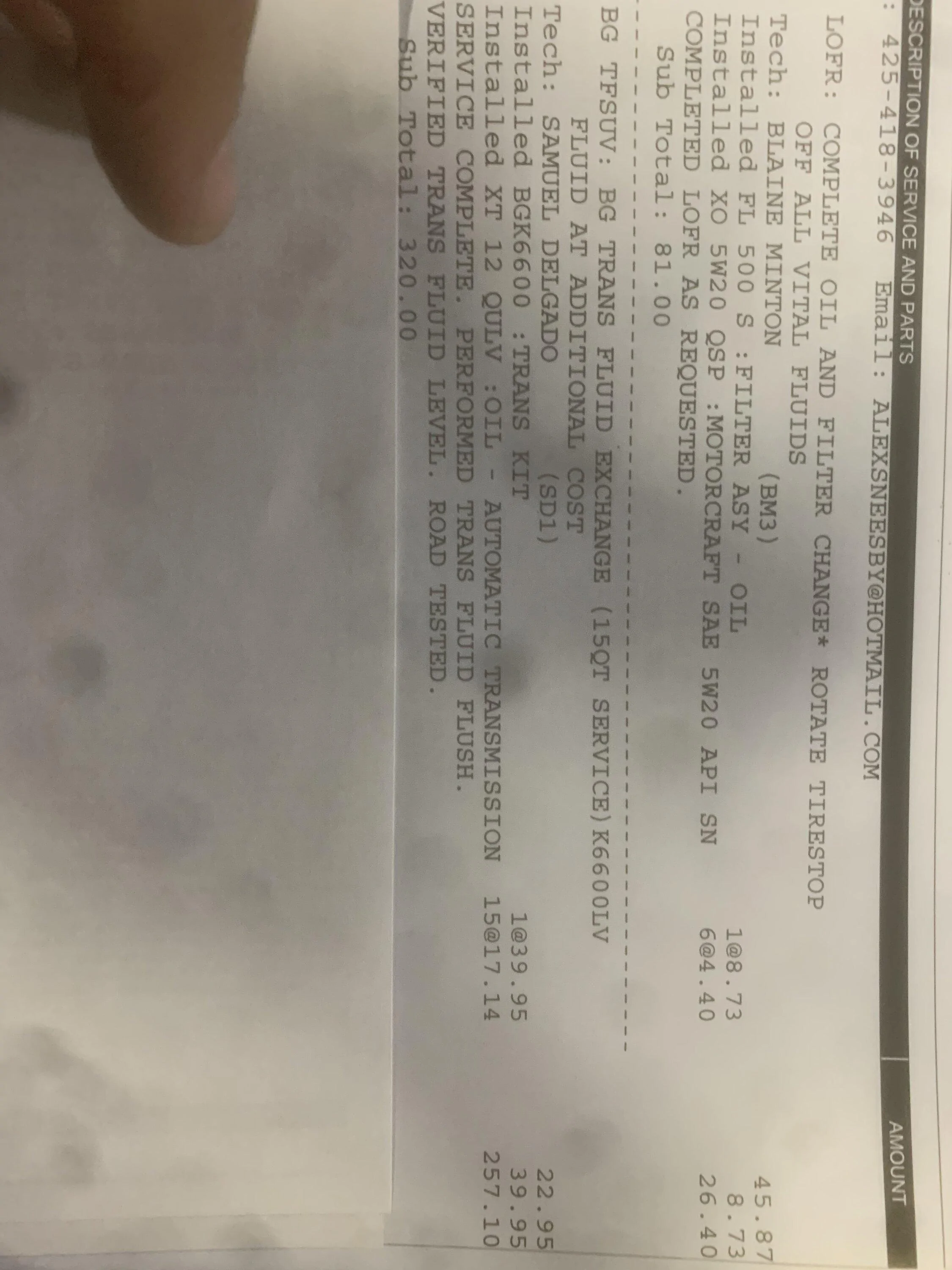

The labor time to replace the transmission fluid and filter is 2.6 hours, in my area that's $429 in labor alone. After you add in the filter, pan gasket, 6 quarts of Mercon ULV, shop supplies, and sales tax, the total price winds up being about $650. A fluid exchange only calls for 1.6 hours, so that's $264 in labor and roughly $350 in total.
Mine came to $443 after tax with an oil change done as well but this was just for a flush not a filter replacement. I’ll do filter every 60k and fluid every 30k

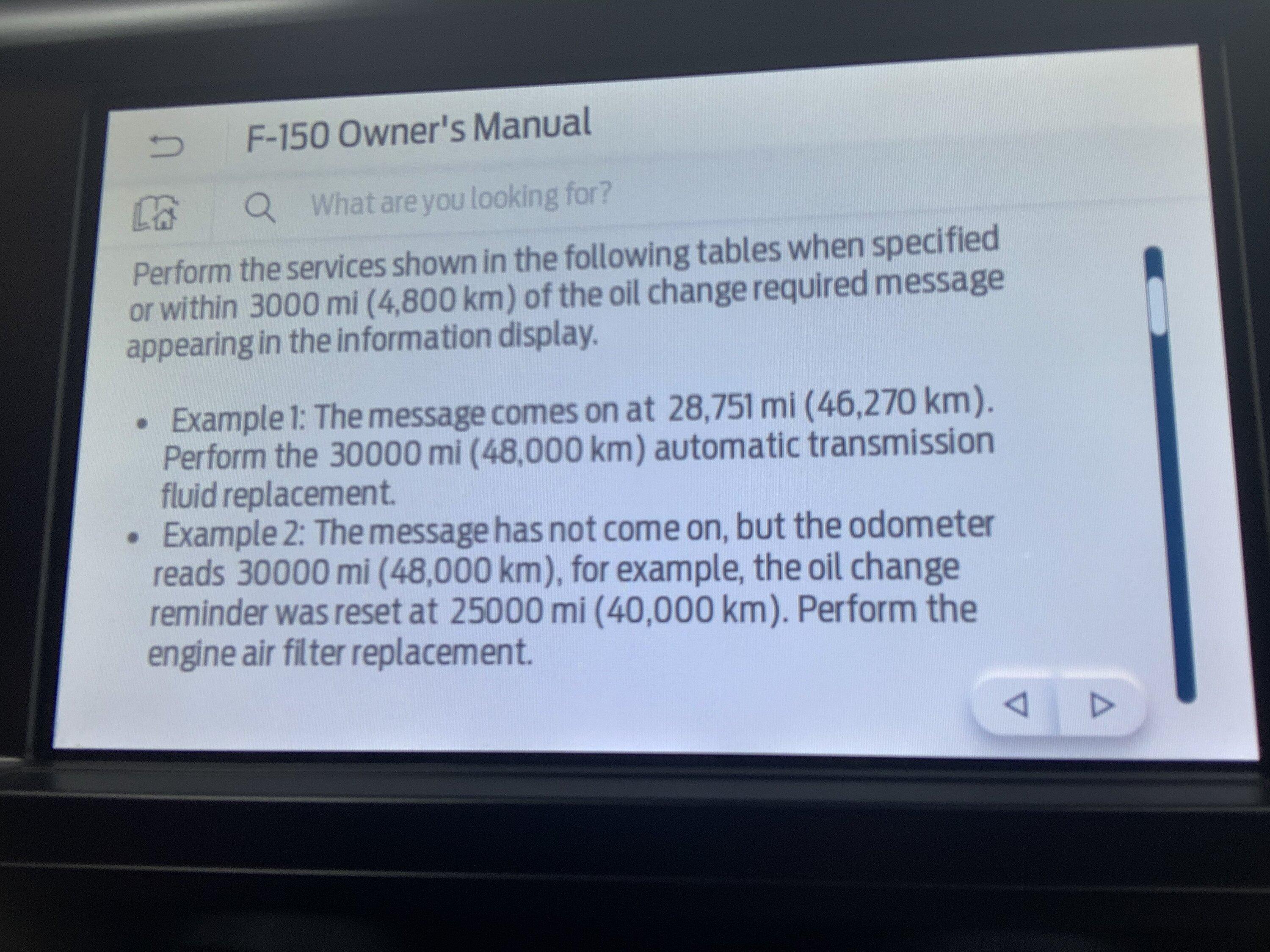

With the F-150 the recommendation is to change the fluid at 150,000 miles. The machines that would do a transmission flush are notorious for damaging seals and forcing a transmission rebuild.
I personally haul 1200-1500 lbs of payload everyday since I bought my truck for my business. The owners manual still recommends a fluid exchange every 30k for severe duty cycle (towing/payload everyday, taxi use etc).
You are totally correct though about a truck just used for daily driving and occasional towing only needing it (according to the manual) at 150k miles. As well as the potential for fluid exchange machines to introduce dirt into the system. I keep my engine bay and undercarriage pretty tidy to avoid any potential contamination when it needs servicing, and I’m fortunate to have a good relationship with the mechanic at my local dealership who I trust. I personally accept the risk, although each individual should definitely weigh the pros and cons
