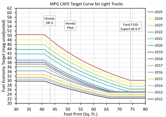

Folks have no idea what's going on, this explains it right here. This sharp sudden increase is changing everything. F150 sized trucks have to have a ~25% bump in efficiency going from 2021-25s else they're fined / have to pay someone like tesla for the offset. Literally funding rivals if they can't meet the fuel economy requirements. More hybrids and electrified platforms are coming.
Ford F-150 Transmission Fluid Change Reaction 1699841760906
A better chart by vehicle size and year
Ford F-150 Transmission Fluid Change Reaction 1699841965358
These numbers can be a little confusing as there's different standards here vs stickers. What it comes down to is the F150 needing ~26MPG sticker by 2025 else they're fined $$

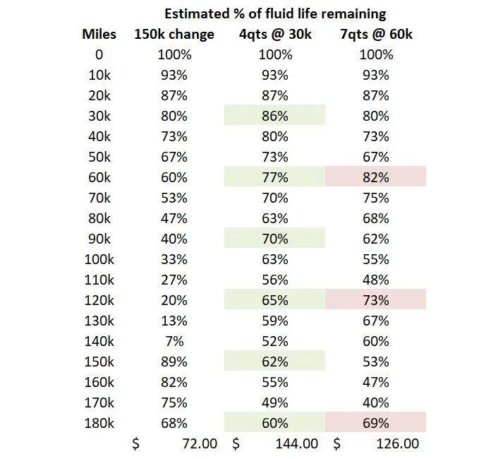

Does type of daily service change anyones mind on this? I'm not arguing either way, I am just curious. For instance, let's say you have someone who never hauls or tows and drives their truck on the hwy 100 miles a day and that's it. Truck sees city driving only briefly to fuel up once a week. Would you consider that "light" enough to wait and change the transmission fluid at 150,000 miles?
150k miles is a long time for an oil. Here's a little spreadsheet of estimated additive pack life. Not sure what happened to make ULV so cheap, but it's really a no brainer to use these types of service intervals at $6/qt pricing.
Ford F-150 Transmission Fluid Change Reaction 1740092366659-ha
