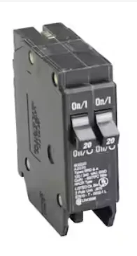

I do not know how it could get to 10
You take out a single breaker and put in a tandem breaker. It turns one slot into 2 breakers. I used a couple of these to have 10 circuits in my Generac transfer switch.
HA! Thanks for the picture. I did know this was even a thing. :)
