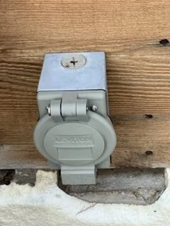

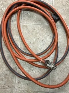

I suspect the interlock is panel specific since each panel is somewhat different. This is a big deal because you don't want to inadvertently back power the grid. I bought a ready made 240VAC truck to house cable from Home Depot. As to the input box you can get them and put in the kind of plug needed. Again Home Depot (& others like Lowes I'm sure) will have them. Just get a weatherproof box, doesn't need to be fancy. I'll post a picture of what I did later in the day
