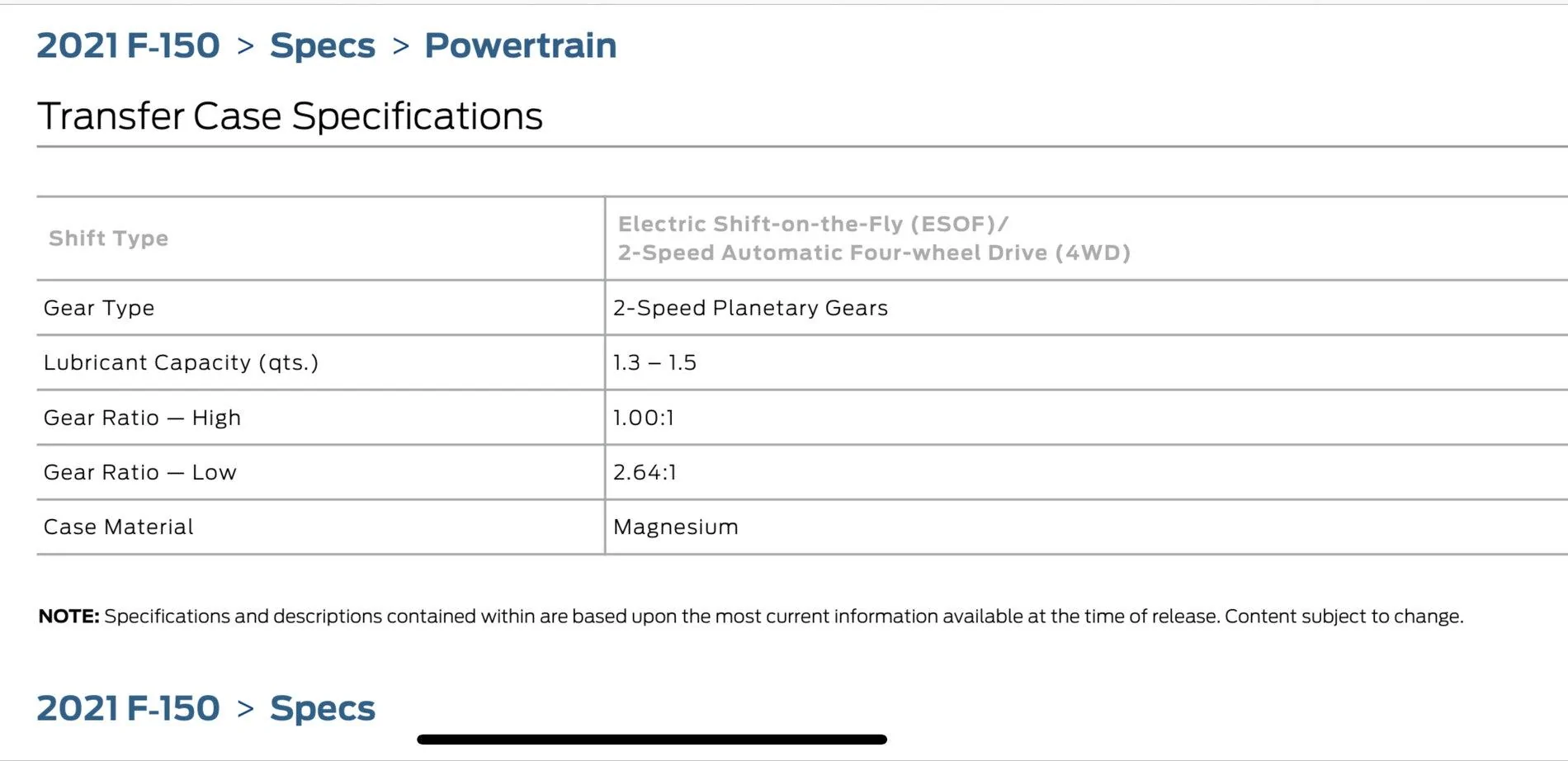

Hi all
I've looked all over Ford's websites including the Ford body builder's website, and I'm unable to find any printed documentation regarding the 4x4 transfer case ratio. I'm pretty certain 4x4 high is 1:1, but what is the reduction when shifted or" switched" into 4x4 low? Ratios for the transmission and axles are all published but nothing on transfer case for 4x4.

Here you go man. From the eSource F150 Specs book. It covers everything in serious depth down to how many find are on each tube of the radiator ?

Thank so much! Pete
That's exactly what I was looking for. Where where did you find the eSource F150 Specs book? I would like to get a copy or download it for my own reference.
