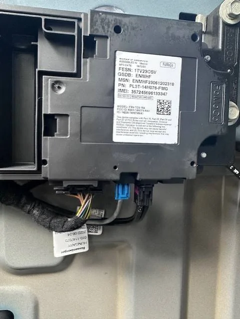

@DrivinTheTruck Do you know where the TCU is to check?
I do not... but I follow directions very well....I will need to research to find out location (I believe behind the rear seat) but I will check for a loose connection and report back. :)

Here you go. It is behind the rear seat on the passenger side.

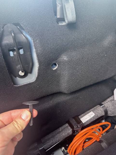

So I looked (see below) and did not see anything suspicious, I did find this plastic piece, but I believe this is to cover hole in carpet??? except, they forgot to replace the broken piece and left this in the truck. I can unplug and reseat the connectors if you think I should but, I wiggled them and they all seemed secure.
On a side note, I just purchased FORScan for a year and Amazon.com: OBDLink EX FORScan OBD Adapter : Automotive I do realize if you are not careful, one could seriously break stuff so I will use with complete caution n care. Learned this through many years of computers :)
