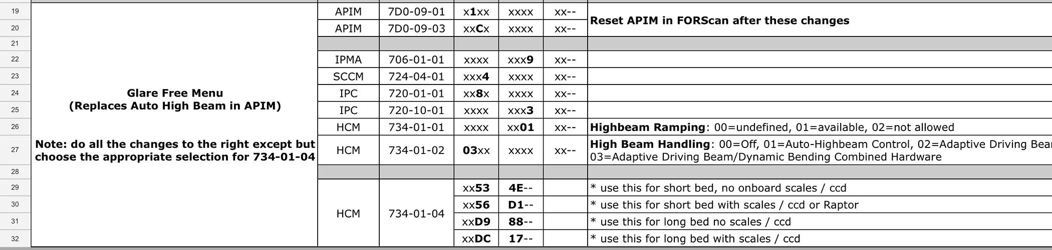

Hey every one. I upgraded to the projector head lights with the hcm and harness for that. I did the forscan changes in the bcm I have the start up sequence when turning the truck on. But don’t move with steering input. And high beams don’t turn on automatic. Even though it’s set it. And when I turn the high beams on my low beams turn off. I feel like some thing is confused. And the plugs are on the right side because I know they are labeled The pig tails.

Heres they changes I did back in the day but might not apply to yours if the HCM is not right.
Yes I popped off the plastic and I see it there with the wires plugged into the drive mode as well I think my problem is I didn’t program the hcm with those values I see in another form I’m going to do this tonight
This is the changes for the 8" IPC
For ipc that photo goes bcm and hcm. I also upgraded to the 12” cluster witch is working now.but I’m going to put these values in for the hcm programming I don’t think I did that thank you

Hey so I did those changes I actually did do them. But for the first row where it says short medium and longest what is that for I did longest because I have the longest wheel base not sure if that’s how it works but I still can get it to work. I don’t have the hyper flash any more. And when I start the truck the head lights do the start up sequence but won’t move with the steering wheel input and they are pointed down not really lighting up the road ahead and when I put the high beams on the upper projector light turns off light
This is for wheel base, really don’t think it will make a difference.
The headlights move with the steering wheel when going above 20mph.
You may need to adjust the headlights to get the proper beam.
On the LED projector headlight, the top is always on but never changes brightness. The lower led does the low and high beam.
