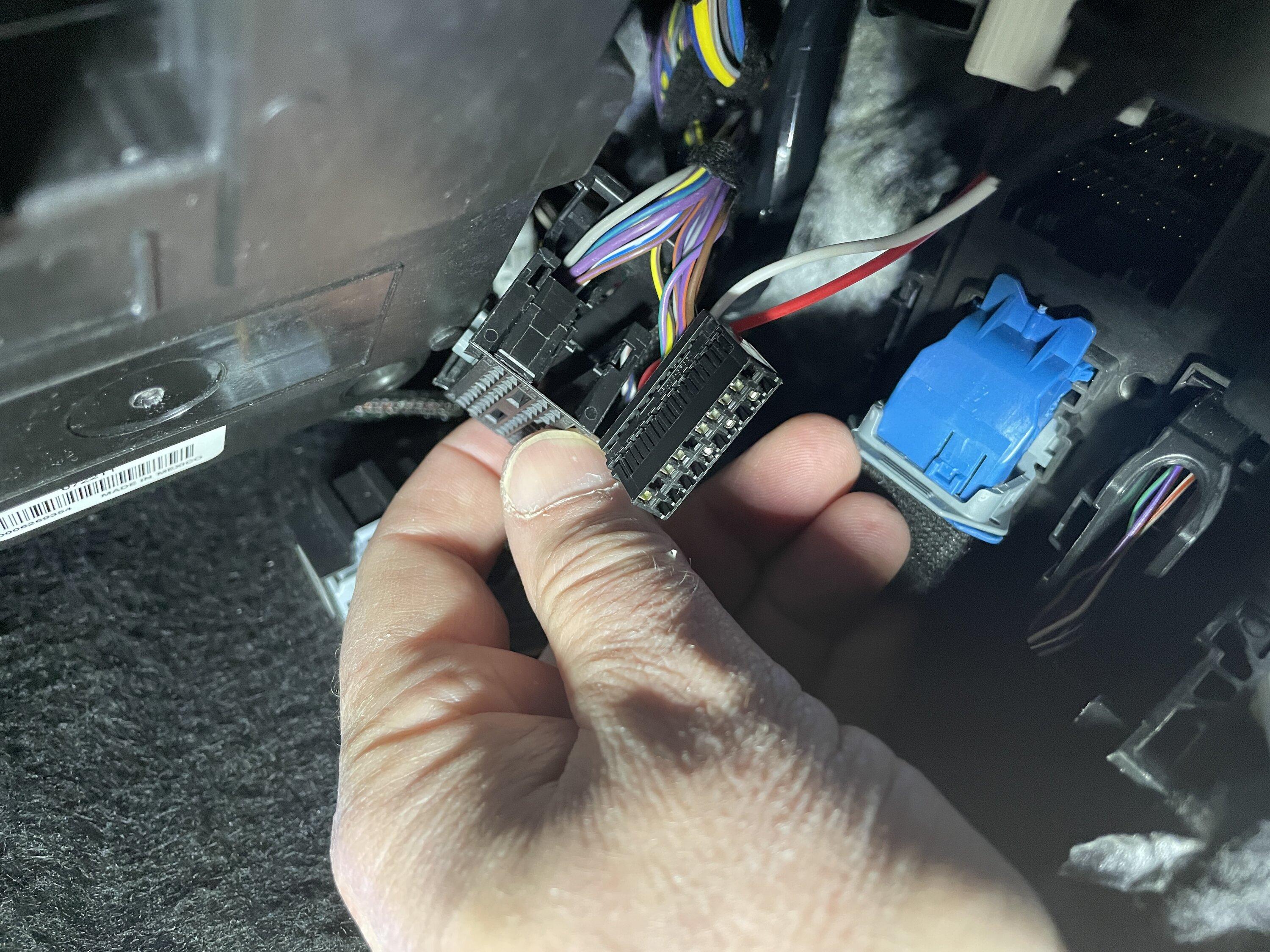

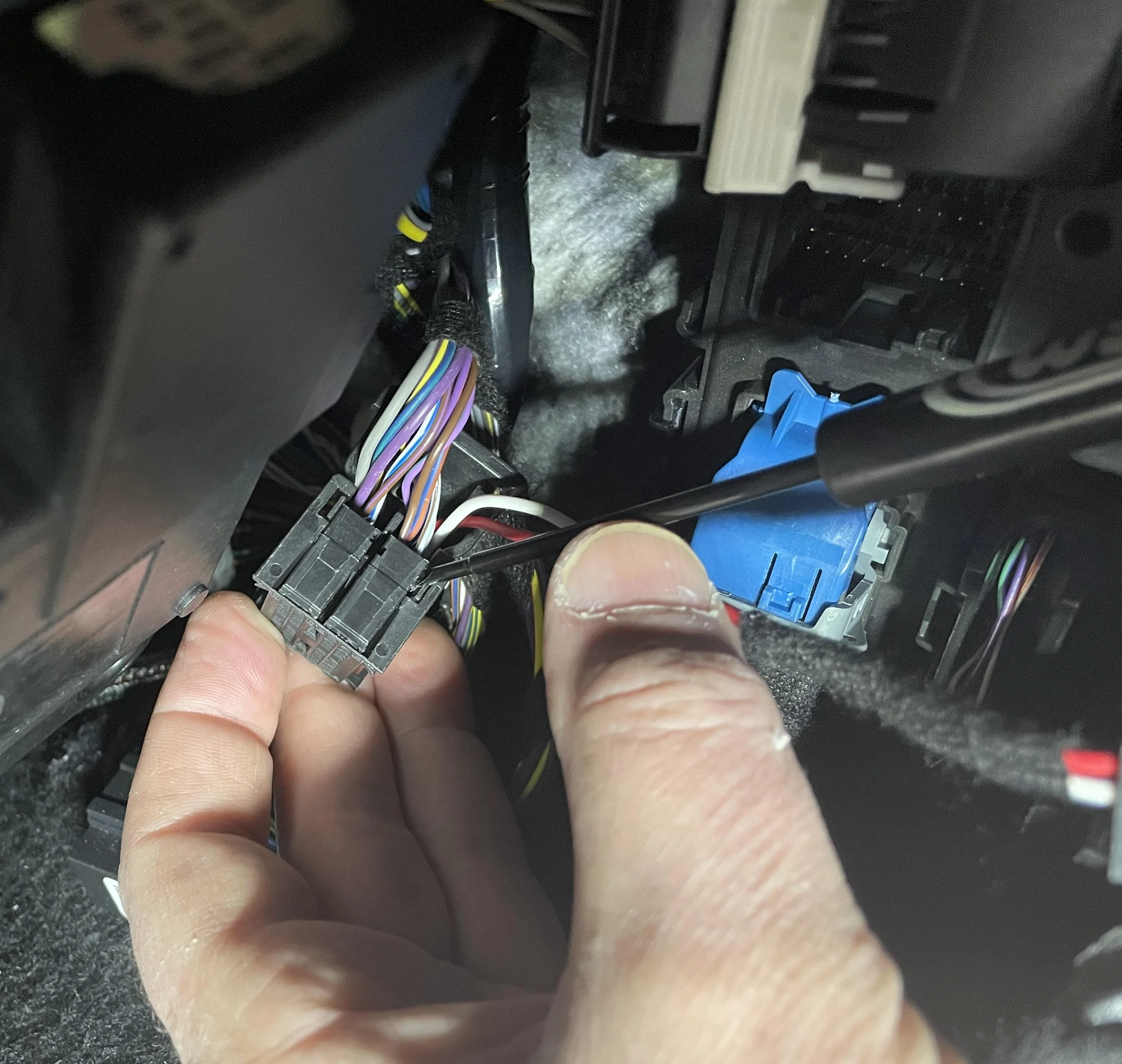

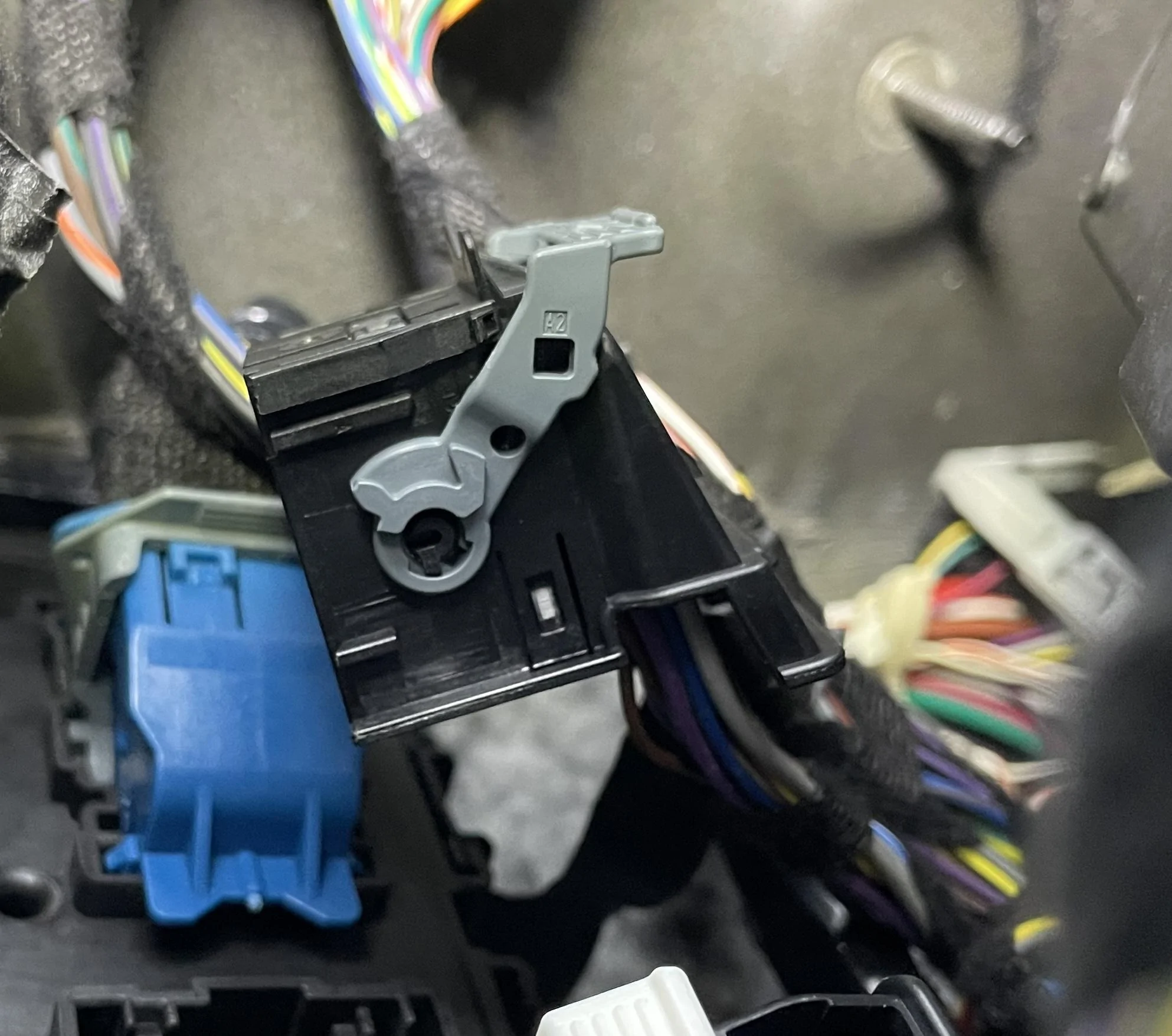

@Gbp1232
The hardest ones to pin are C2280F. Here are a few pictures and PDF's to refer to.

Ford F-150 Another LED reflector to LED projector thread C2280F-1
Ford F-150 Another LED reflector to LED projector thread C2280F-2
Ford F-150 Another LED reflector to LED projector thread C2280F-3

@Gbp1232
I'm in Woodstock Ga and see your in Ga to, you close by?
I pinned those with the A pillar trim still covering the BCM because I didn’t know how to move it ? that was a major pain. I’m a big guy and it’s hard enough for me to fit down there
