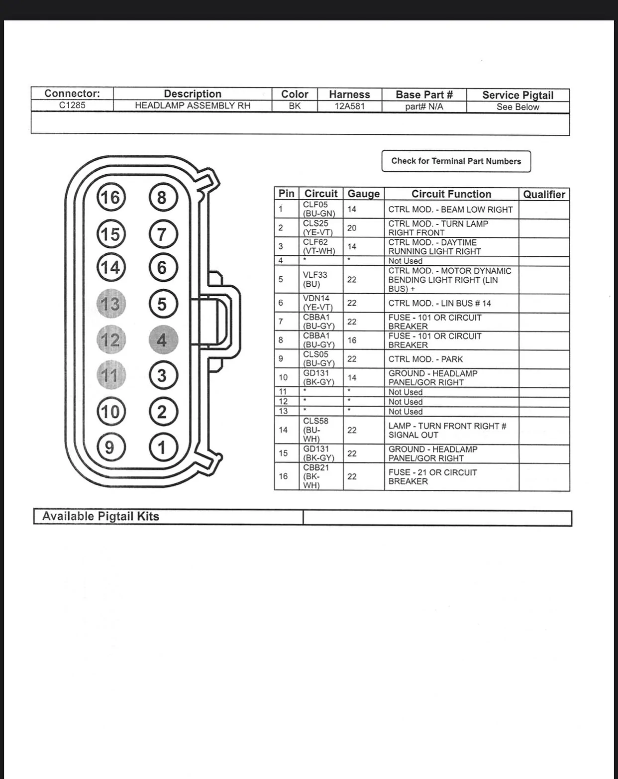

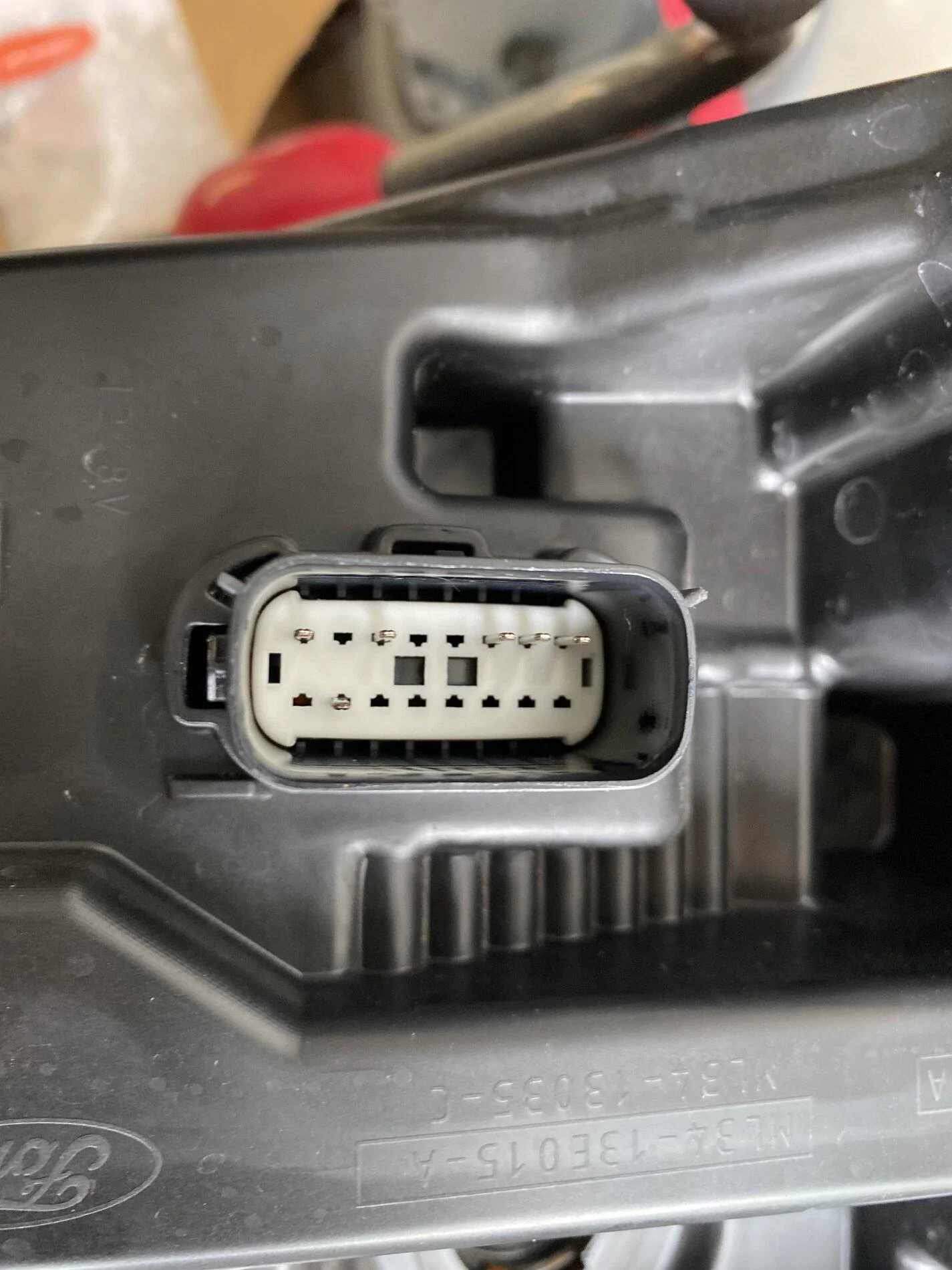

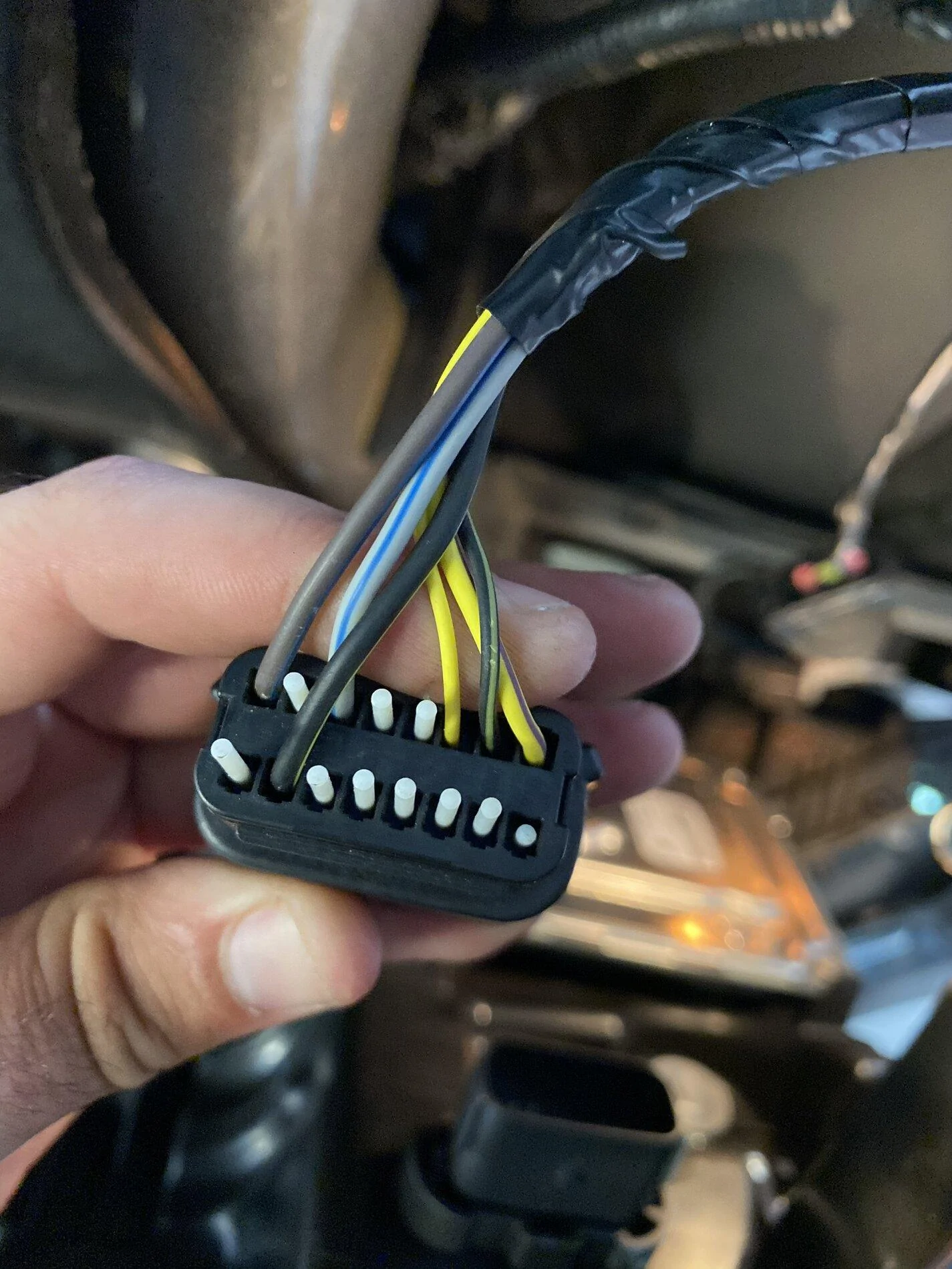

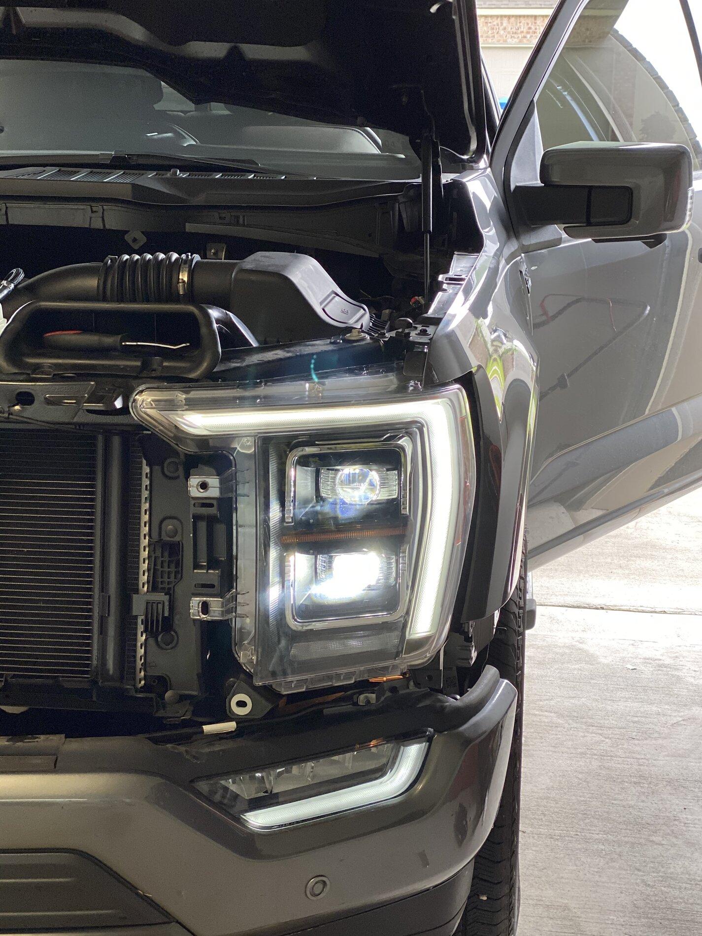

OK, I made sure to look everywhere else before making a new thread.
I have a 2022 XLT, I made a conversion from bi led to projector led, got both the harness as well as the module from precision retrofits.
I followed their instructions to the letter when installing.... problem is the coding I believe. or the HCM MODULE.
After all was installed, and correctly did the coding only 1 high beam works. the driver side.
The passenger side high beam does not work. but they do light up. Its just the high beam not working.
I did notice that when changing the codes and after trying to save them to the module they went back to the original code. So, I couldn't really save them for the high beam functionality.
Can someone please help get both high beams to work?
I just dont know what else to do.
whoever helps me with this I will pay $100. via paypal.
i prefer to do this over a cell phone.
If not please pm please!! thank you!
Thank you in advance for your help.

I had a very similar issue happen with mine, turned out the conversion harness was pinned wrong. Check continuity from end to end on the harness. I can’t remember which pin I had that was off but if I dig through some of my old posts I may be able to find it. The pin I had that was incorrect I believe got the signal from the HCM to the headlamp motors

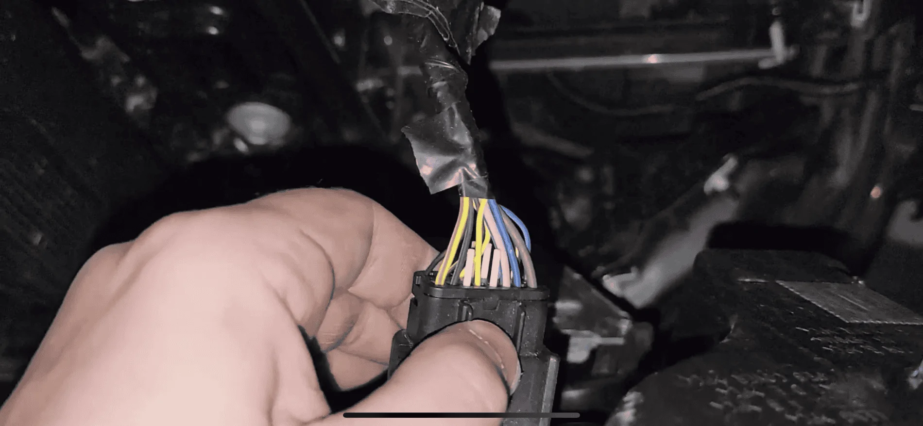

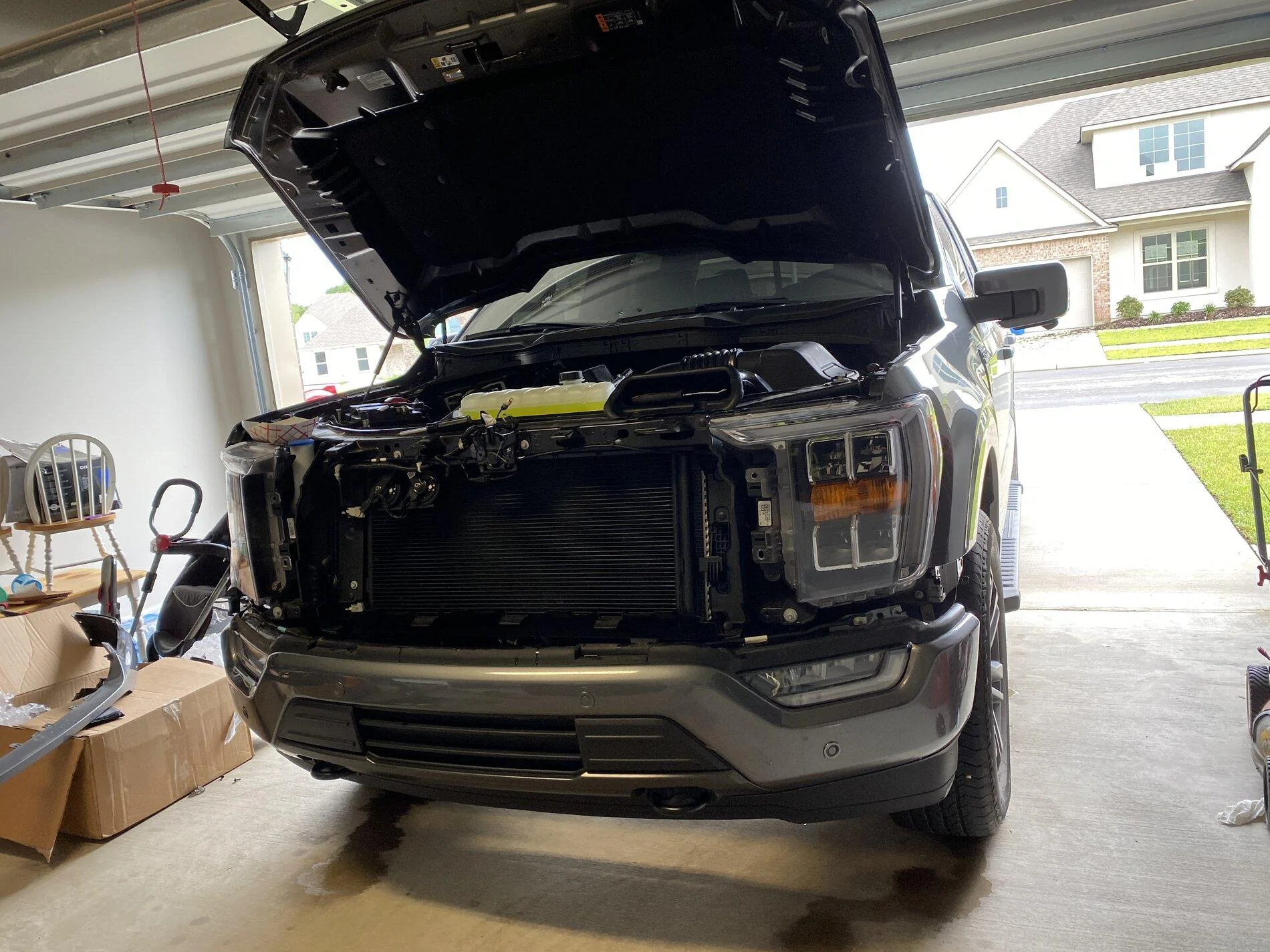

where you able to get it working? I got the same problem. XLT reflector to full led from lariat conversion, Im kind of stuck right now because of this.....
hey did you get it working I’m having a problem with the lights not bending but doing the start up sequence. And low beams turn off when I do the high beams. I have the hcm and harness is it possibly that I pinned them wrong?

your right this weekend Il going to pull the grill of to look at these connections and look a where they were pinned on the passenger side inside the vehicle. Thanks.
