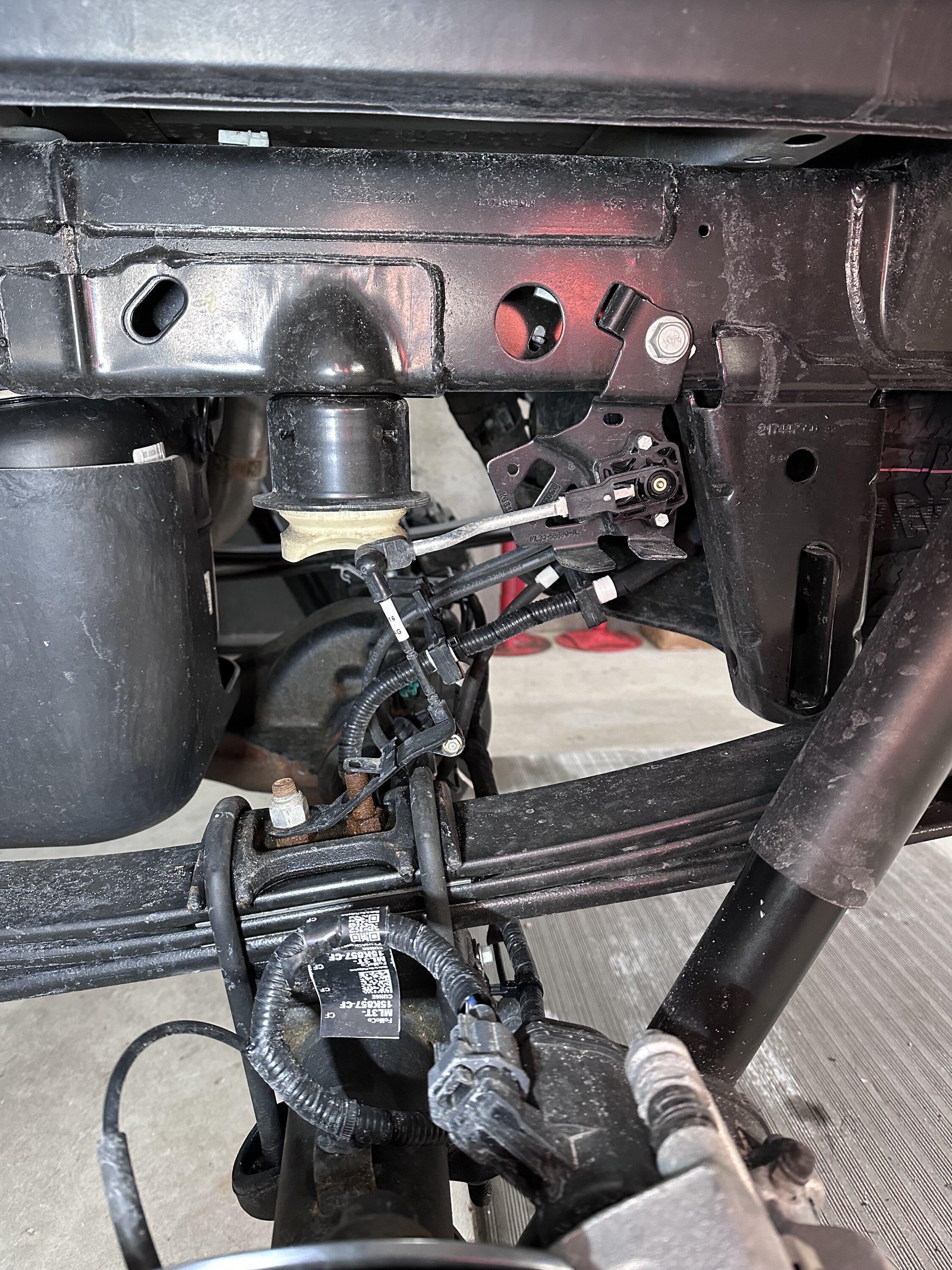

Seems we all have similar goals. I ordered the headlights from PR two weeks ago. I got a tracking number this past Thursday, but they haven't moved yet.
I also went with Ryan for the required harnesses and HCM, and I second the advice on going this route. I worked with Ryan about five years ago when we were all coming up with how to get LED headlights in our F250/F350's. He has started a business making harnesses, so I am inclined to help a fellow forum friend. Sounds like JScaro will also be a good option for you.
I found my truck already had the rear height sensor, so I call that a win. I will order the front, get the required plugs and pins, and make my own harness for this.
Ford F-150 Another LED reflector to LED projector thread tempImage7tjjF1
At the moment, I do not plan on doing the glare free mod, but that's just a Forscan change anyway. I will make every effort find a way to avoid the DTC.
