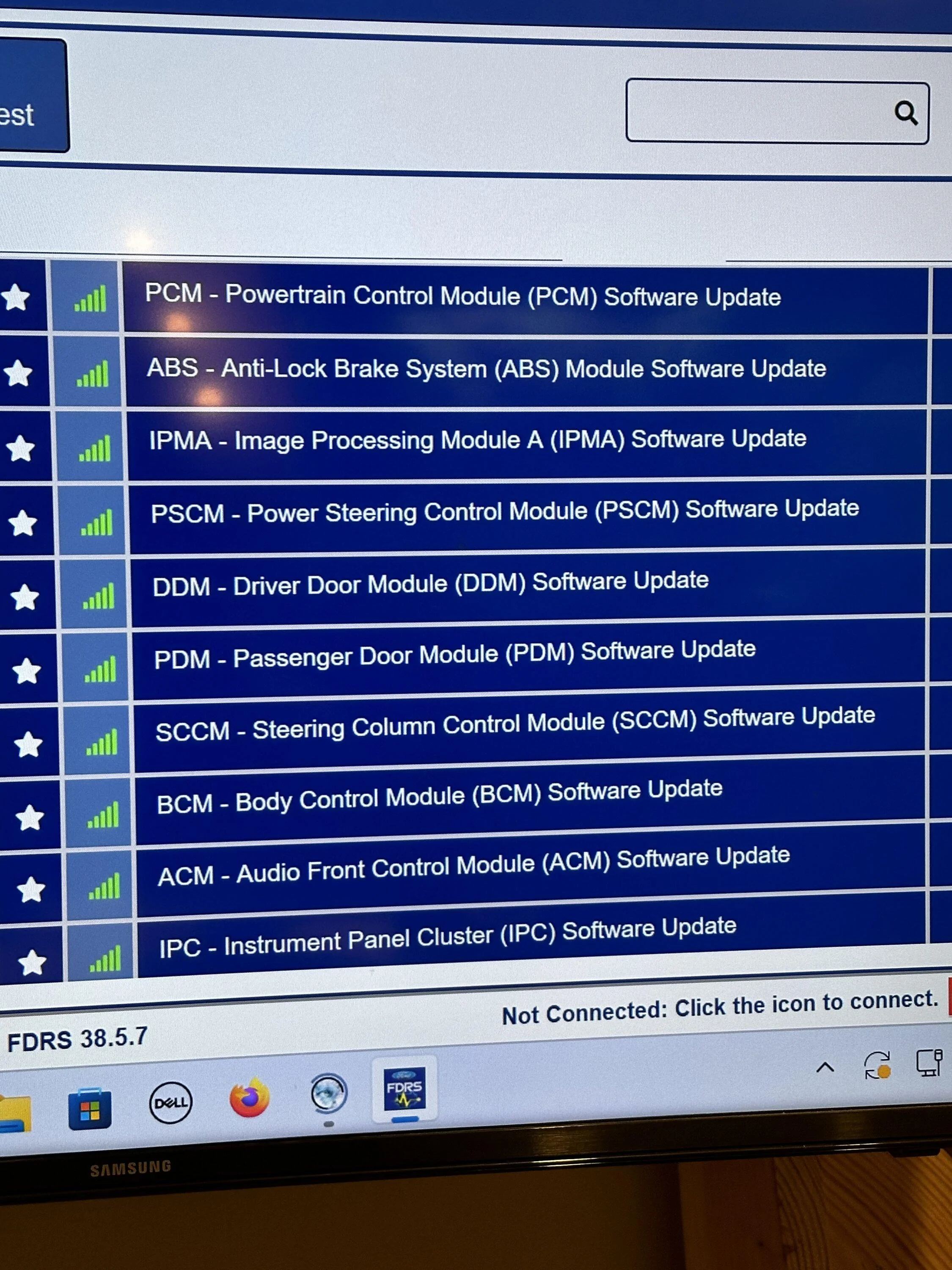

I ran the updates on mine today and had issues with the BCM.Thank you ! That one isnt mine, its a friends.

Dam! Skier, I'm sorry to hear that! At least it didn't blow out any of your modules. I'm glad that Jesse was able to bail you out. He's helped me out before as well. I don't know what we'd all do without him. He's a true asset to all of us here.I ran the updates on mine today and had issues with the BCM.
@Big Dog Daddy I did not survive the great BCM update of 2024. ? Jesse had to roll mine back.
