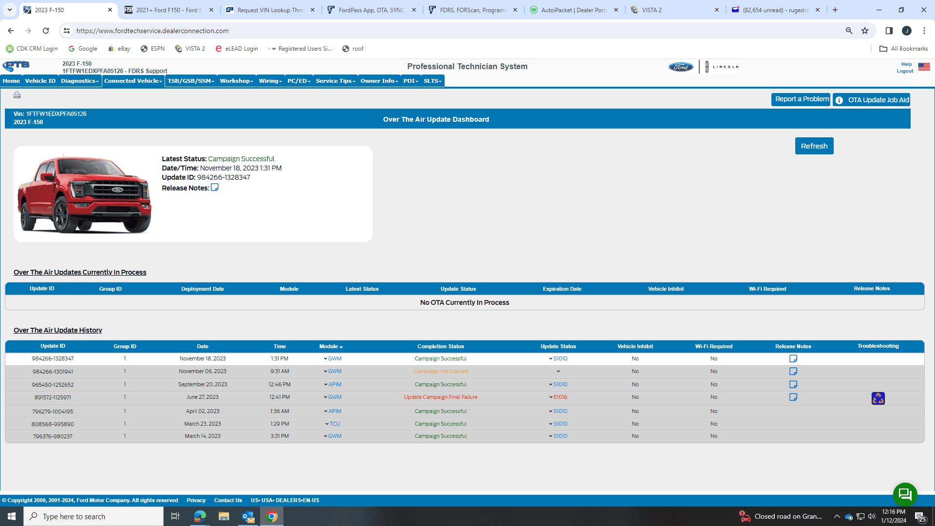

I posted this in another thread without seeing this thread first. I'll head over and update my other thread shortly.

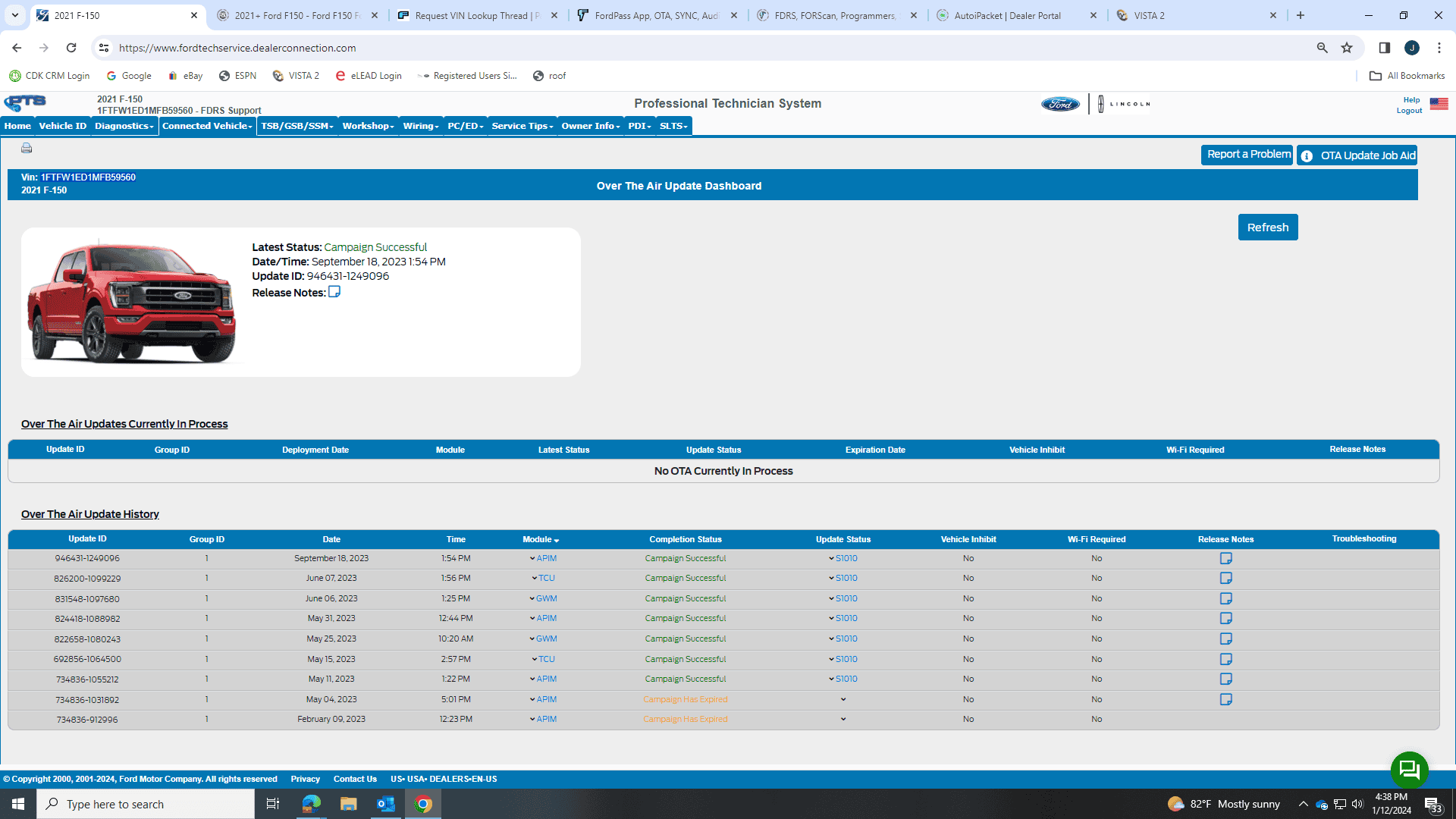

Purchased my truck in late December (20th-ish).
Trying to learn as much as I can about the OTA status and other updates that it did or should have received.
VIN 1FTFW1EDXPFA05126
Thank you so much for help.
OTA history is below. The last one you got was 6.1.0 on 11/18. You are not terribly behind.
Thank you very much - is there a best way to get caught up? Assuming I cannot do it OTA.
