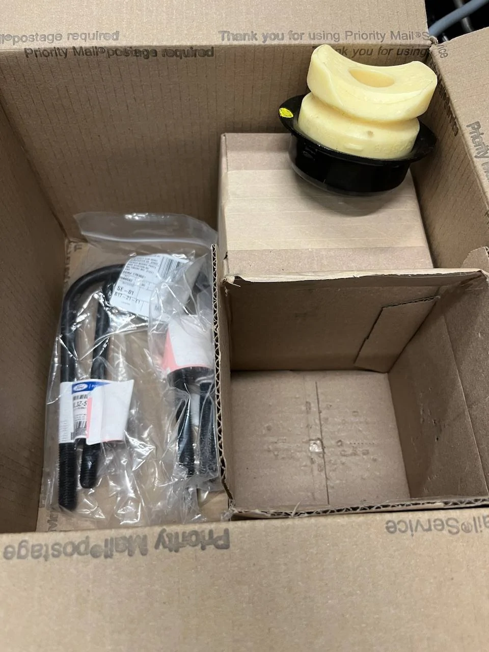

I received my 2WD U-bolts and nuts yesterday and as I had suspected they don't come as pairs but are sold as singular units, so I had to order the other two U-bolts along with the 2WD bump stops. ? I should have those by next week. ?
Ford F-150 Rear blocks removed - alignment way off IMG_8152

Look what showed up yesterday.
Ford F-150 Rear blocks removed - alignment way off IMG_0230
