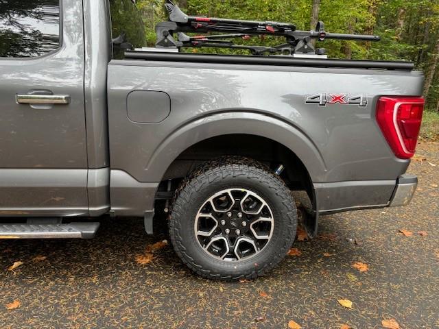

I just removed my Blocks, it went really smooth, HOWEVER, when I was done I went and checked my rake on both sides and I have a 2" rake still on Driver side and barely a 1.5" rake on passenger side, I thought maybe I did something wrong, so I went back under and double checked everything and everything seems fine. All my tire pressures are right and the fuel tank extra weight is on the driver side so you would think it would the side lower, not higher. Any suggestions, or anyone having the same issues?

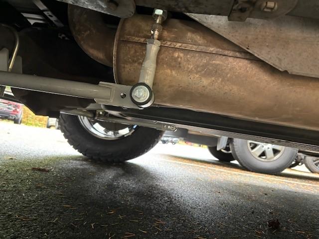

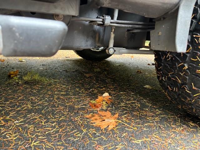

Sure. Check out this swaybar string. There’s a lot of discussion about 4 pages in on the endlink length of the 4wd versions that are more generous to afford those that lift the rears. The 2wd end links are several inches shorter by design. For us who chose to drop or keep stock heights in order to adjust per the manufacturer’s suggestion the bars cannot be made parallel to ground without modifying the end links (read: cut).
I chose to drop my rear by removing blocks and took a chance that there was enough thread in the rods to afford a level bar adjustment - and there was more than enough. I think I had about 1” of thread engagement on both sides of the endlinks.
If you don’t intend to lift I think this is a better choice. Probably (maybe) even with the blocks left in. As often said though, do as you are comfortable.

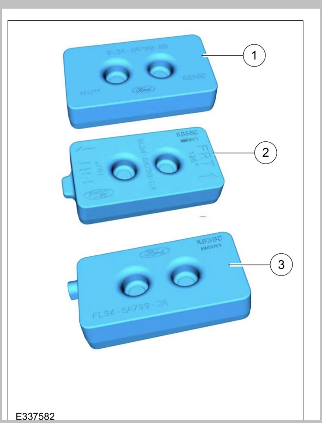

Not, yet. But I plan try it soon. I'll see how I like it, and put them back if the boat makes its squat too much for my liking. I just want to verify I have enough thread on the U-bolts. I can’t seem to find the oem 2wd ones anywhere...yet.
I believe only the 4wd has blocks, but there are 3 different blocks for the 4wd based on wheelbase and payload configuration.
Do you happen to know the different sizes of these blocks?
