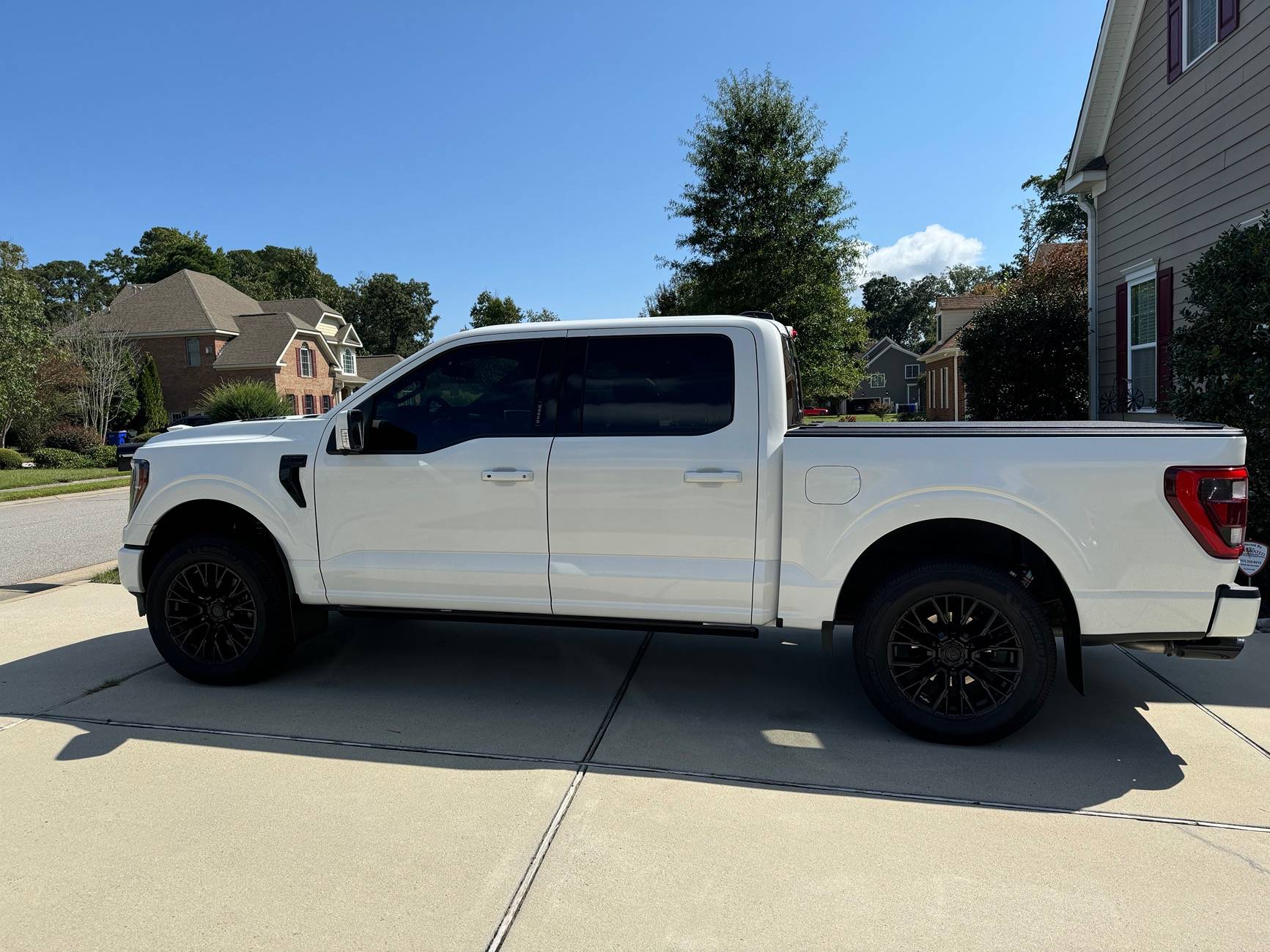

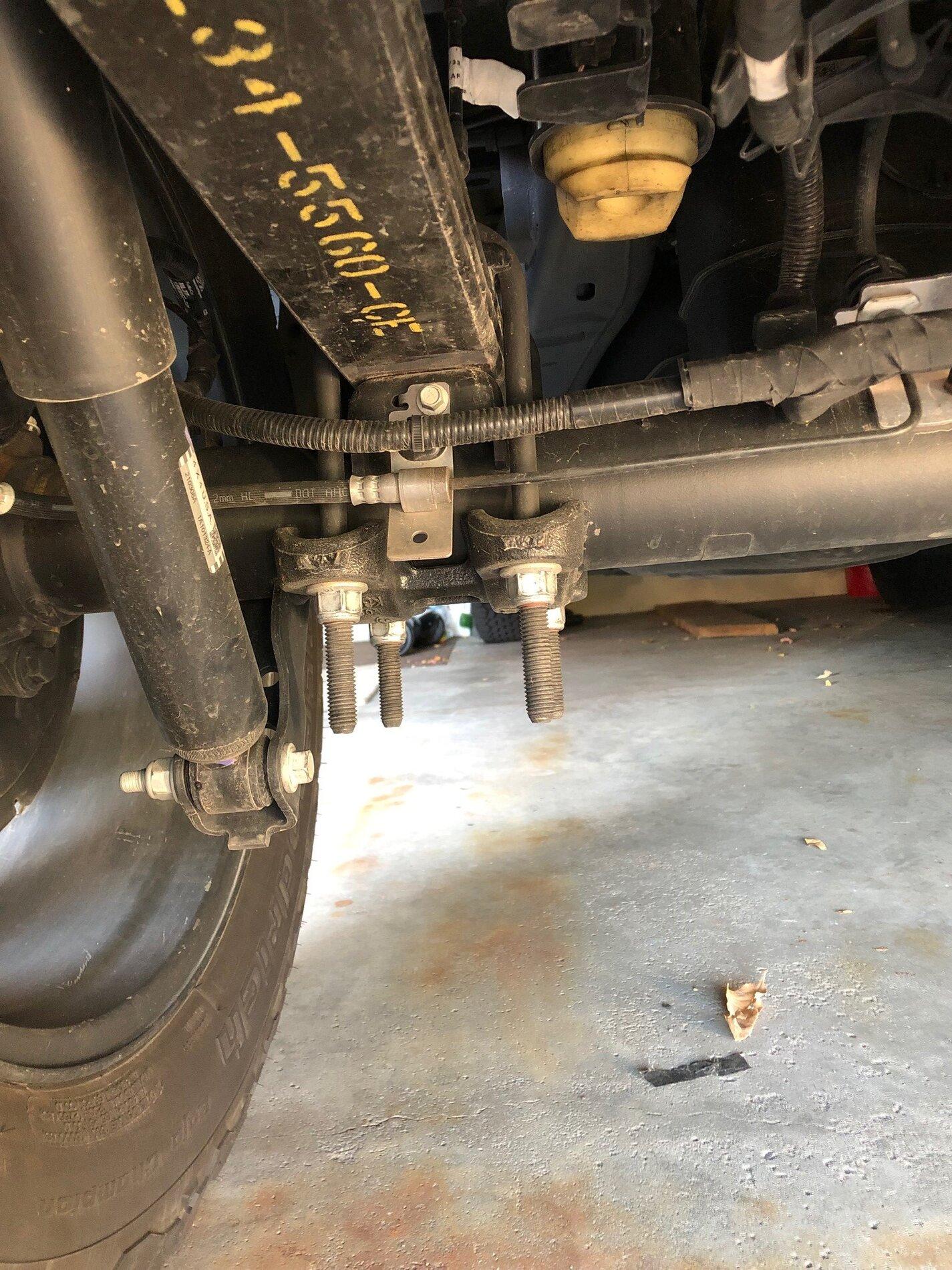

Have a 2024 king ranch f150. Wondering if I take the rear blocks out if I’ll be able to reuse the same u bolts or if I’ll have to get new ones
vinnie45acp
Vince
Oct 5, 2023
51
Virginia, USA
2022 Ford F150 Lariat Sport/Sport appearance Package/502A
Logistics
You can use the same ones, however they will be long and stick down and look odd, but it’s up to you. I spent the money on the 2x4 u-bolts and looks like OEM, and I kept the blocks and bolts just in case I ever wanted to go back. But I’m completely level and it looks awesome and with the Eibach pro suspension it feels awesome as well.

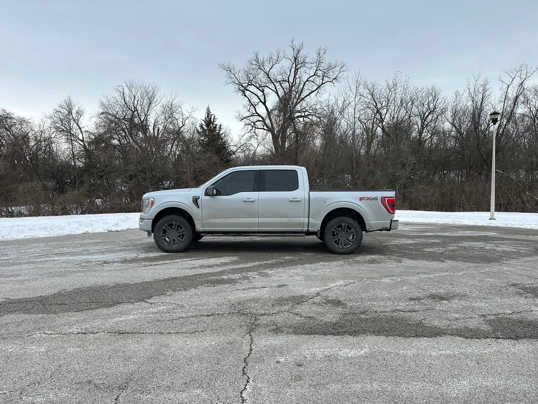

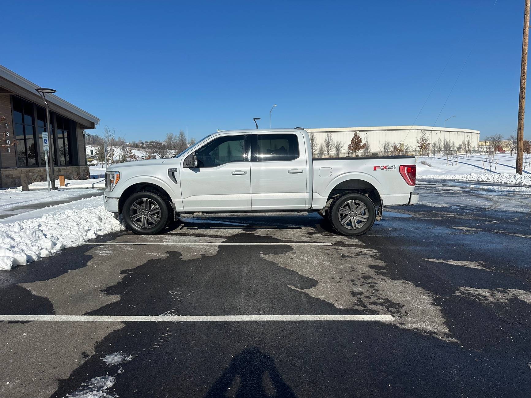

I couldn’t find this exact combination anywhere online, so thought I’d share.
1.5” motofab front puck
1.25” rear block removed
275/65/20 Toyo AT3’s
Ford F-150 Anyone remove rear blocks? IMG_7197
Ford F-150 Anyone remove rear blocks? IMG_7470
