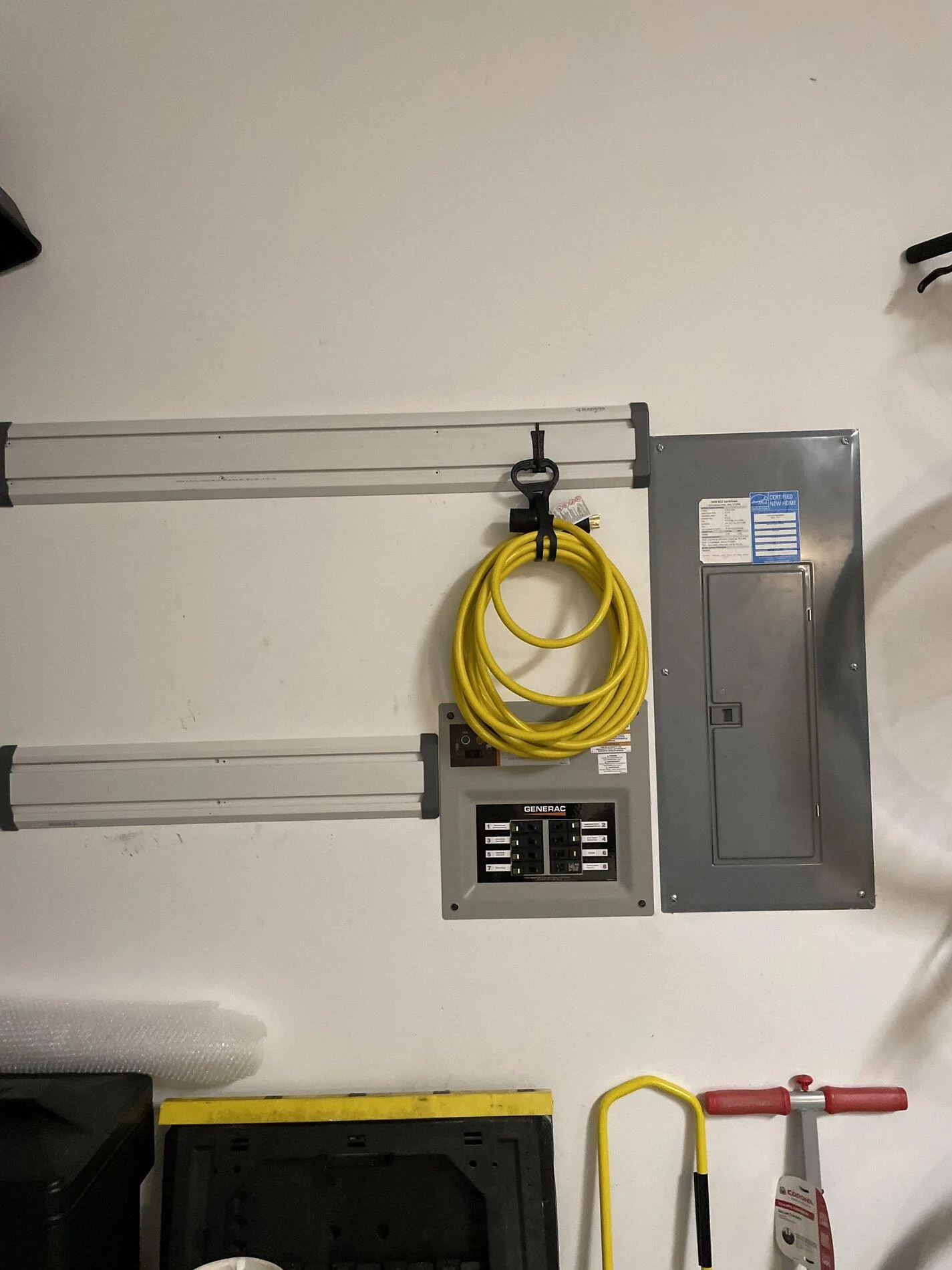

My electrician installed the Generac transfer switch yesterday. The final cost for the installation was $950 which included two duplex circuit breakers and a 50 amp double pole breaker, all of which he provided, plus the $550 or so for parts that I mentioned before. The job took about 4 hours all together, and his helper had to leave after a couple of hours so that slowed things down. So the total was about $1500 installed.
So now I can talk about it. First of all, our truck is amazing! The Generac comes with 8 circuits which can be expanded to ten which we will do with the duplex breakers this afternoon. But using just the standard eight we connected almost everything in my 2400 sq ft house and had hundreds of watts to spare. We have a gas dryer, stove, and water heater so they don't use as much electricity as electric appliances and that left a lot of watts available. Bear in mind that even though you connect to a lot of circuits they aren't all working at full capacity at the same time, most of what is connected is just sitting there. We didn't try to run my central air system, that's probably not going to work, but we did connect a Mitsubishi Mini-Split in the sunroom and that only drew 900 watts and will keep that large room cool. If we need to sleep there we can and during the day it will be a place we can hang out. We experimented with different circuit combinations and always had plenty of watts.
He mounted the panel on the wall, but in hindsight I think we could have done a flush mount and it would have looked better. There is a sub-panel next to the main circuit breaker panel and that meant he couldn't use the best space so he mounted the Generac panel below the main panel and came up through the bottom. The Generac is pre-wired and the wires are color coded and also numbered so even though there are a lot of them you can keep them straight. I would say they put a lot of thought into how to simplify the installation but even though YouTube videos suggest it could be a DIY job I wouldn't do it. Hire an electrician.
One bit of confusion after the install was complete was that the green light that indicates utility power didn't light up. We couldn't find anything wrong and re-read the instructions. That light only comes on when you're using generator power and then utility power is restored. So it's really just a visual alert that utility power is available and you can switch from the generator, it's not a light that stays on all the time. It's simple to make the change, just flip the control switch the other way.
I bought a 50 ft extension cord and then thought I'd bought one that was more than I needed. It turned out though that it was exactly long enough to reach my truck from the inlet box, if it was a little longer it would have been better. It's the right length but I wanted a little extra so I could park my truck in different spots depending on the situation. I could buy a short one and add it on but I don't think I'll bother. If you're shopping around for one measure first.
So all in all I'm very pleased. This adds an emergency feature to the truck that I might never need, but we've been through two hurricanes where the power was out for more than a week. With this and the 700 mile range of the truck we have a choice, ride it out or evacuate.
