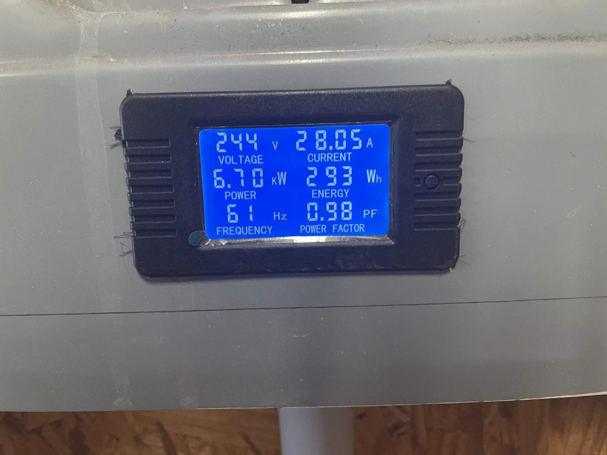

7.2kW is sufficient for “most” homes. My 3600sqf house draws 6.7kw with every light, fan, tv, fridge, and the downstairs AC on. I don’t normally have every light, fan, and TV on at once, I was just load testing my generator. I have a meter on the incoming line from the generator.
