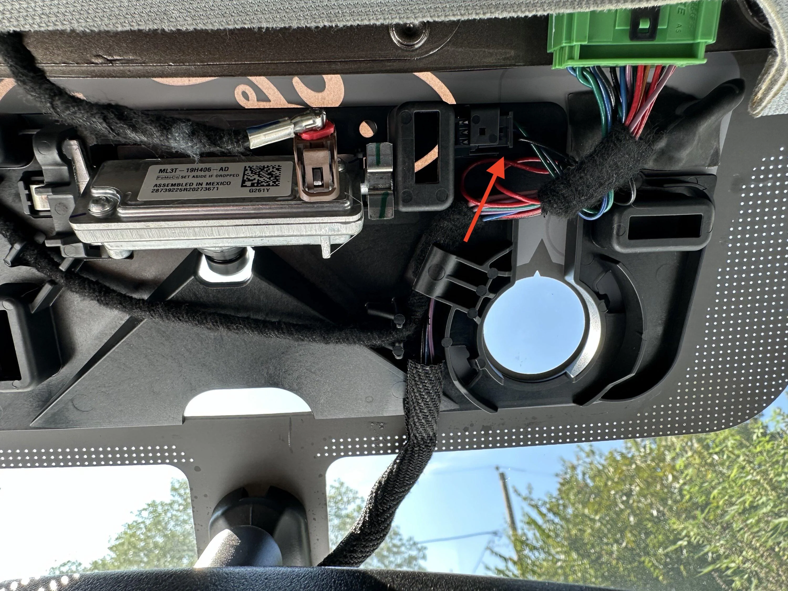

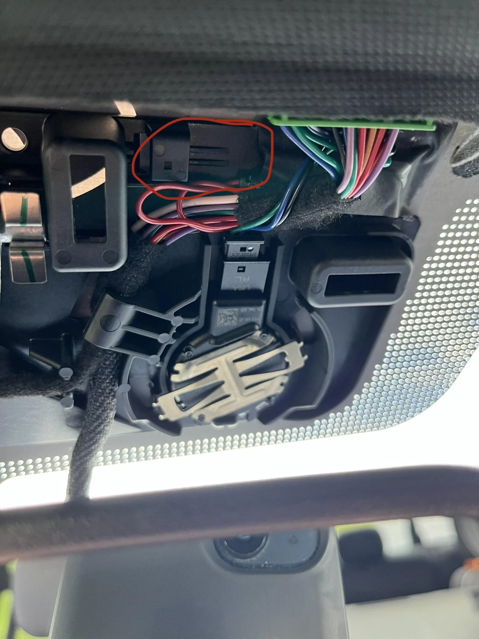

@TJSparky, I popped off the cover above the rear view mirror and saw that I have the three-pin connector with the green/white, black/white, and blue/white wires tucked into a holder (see photo). Does this in some way imply that my 2022 Lariat is wired for the rain sensor? If so, do I need to replace the stalk switch or as you suggested, just keep the existing and change the necessary values in Forscan? I've seen several somewhat uncertain comments throughout this thread. But, I do appreciate everyone's input. It's what keeps my reading skills alive ?
I would try installing the sensor and making the forscan changes first. You may also need to purchase the stalk and an additional harness as well if that does not work. I only needed the sensor and forscan changes for my '23 302A.

It depends. All models appear to have the plug. However, all don’t have power going to it. You have a lariat so it probably has power going to the plug. On some of the ‘21 XLT lower trim models it doesn’t appear to have power going to the plug.
I believe if you turn the wiper to the first delay setting and put a multimeter to the plug you can see if you have power for the sensor.
