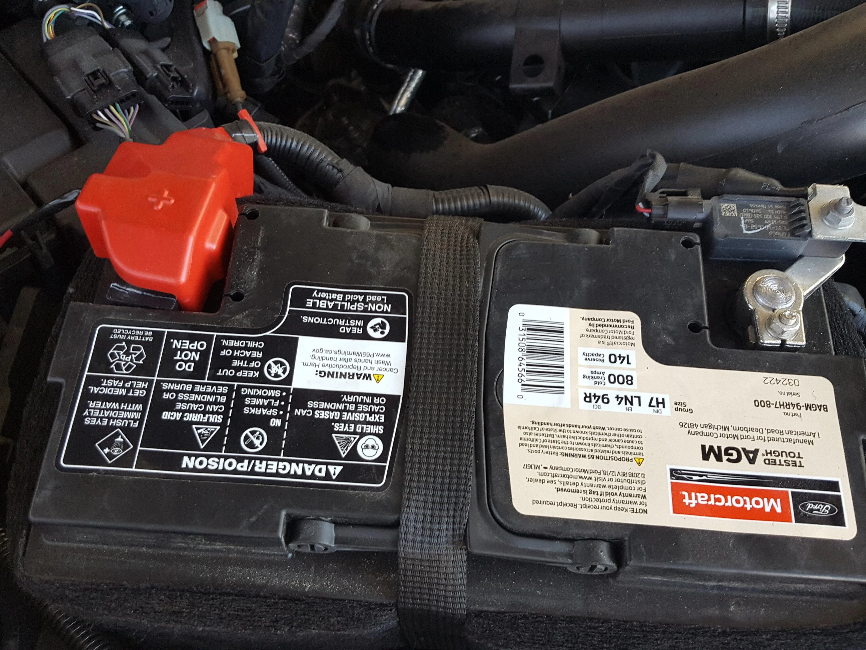

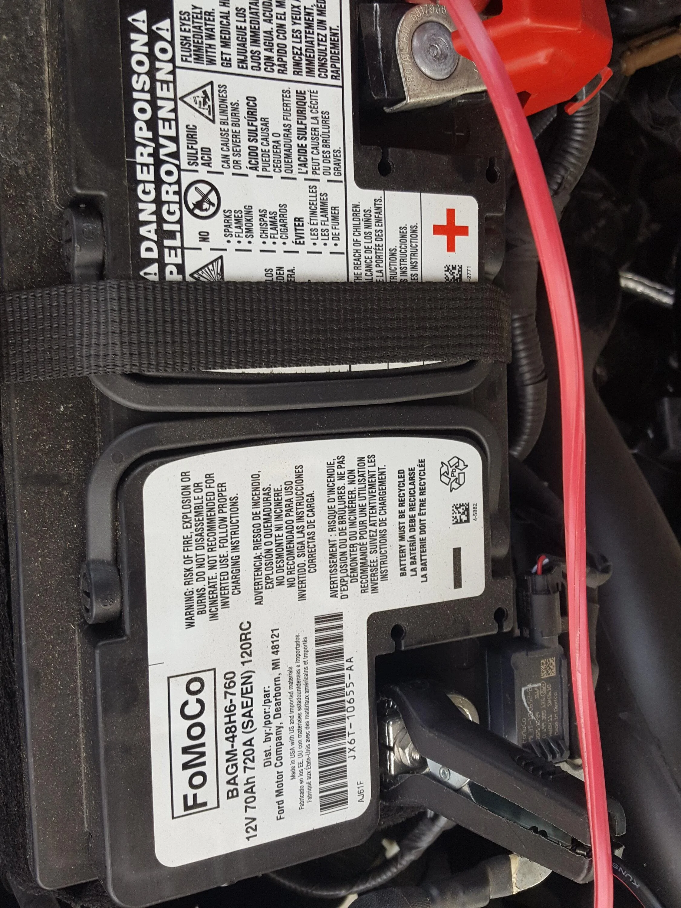

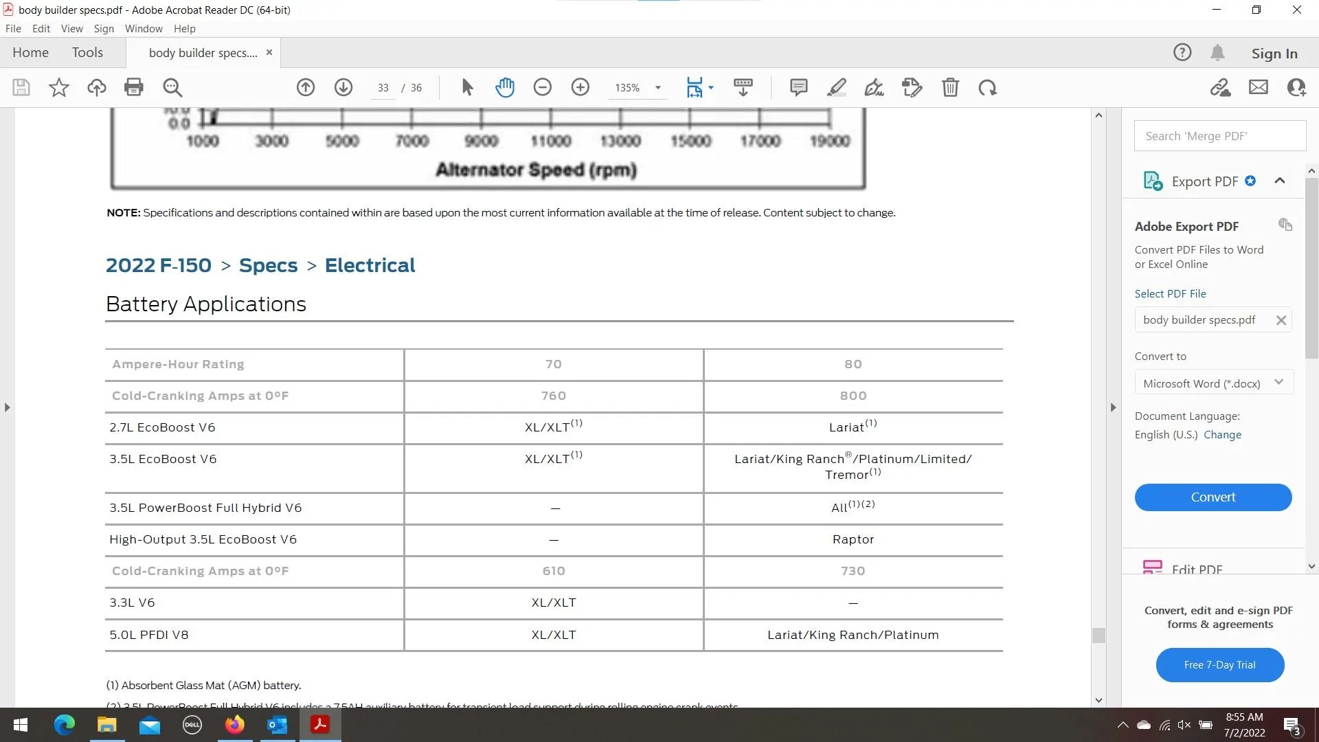

AND to toss a bit of stuff on the pile.
look at the building specification sheet for model year 2022 battery might not be what was supposed to be installed
mine was the lesser and ford changed it to the 800 as per the table and help here from the ford people watching and soc was raised to 95%
zero battery issues since . i am happy camper

Fortunately, mine came from the factory as an 800.
