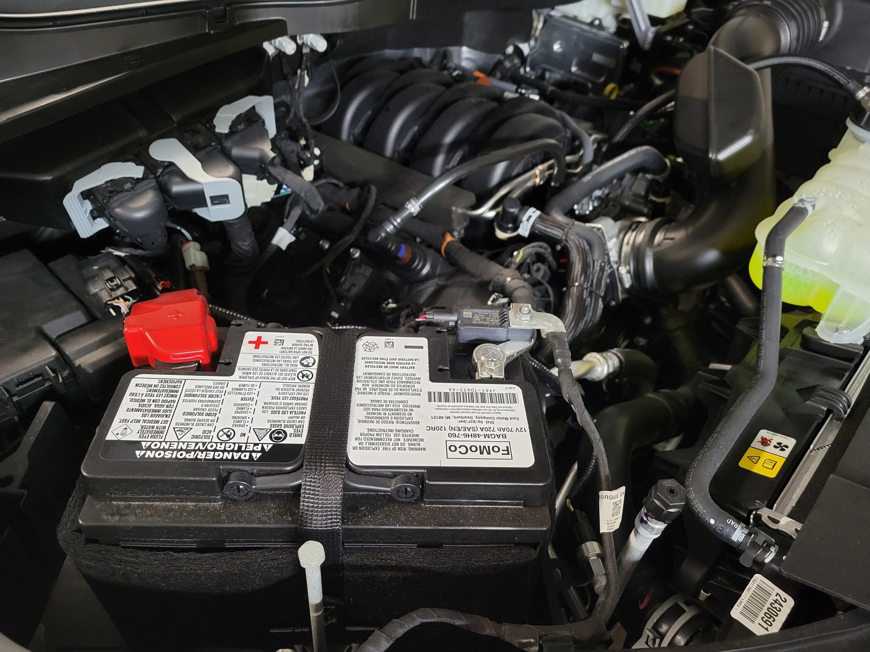

Yeah, that was my lazy attempt at being helpful. No shade intended. I went out and looked at my 5.0L Battery. Its Ford Part Number is BAGM 48H6 760. Its also very small in the tray for the 5.0L. We can put a lot more battery in here.
