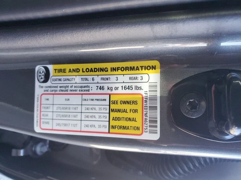

I will try to attach my window sticker. I ordered a new 2022 Power Boost, XLT 302A. Knowing the payload capacity limitations of the PB's, I tried to be very judicious with the options I ordered.
I ended up with a PB with 7.2 Kw generator that has a payload capacity of 1645#.
The trailer I tow has a max GVWR of 6,000#. The CAT scaled weight is 5,660#.
