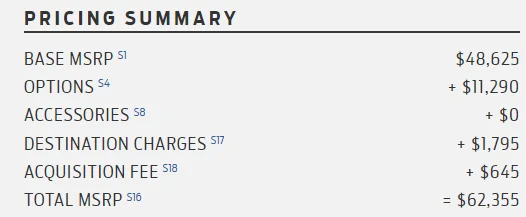

On a well optioned XLT, the tow package adds literally nothing. In fact the checked options vs what's shown on the bottom sheet isn't even aligned. Ford's configurator is a complete mess. What a joke. XLT high + Ford Co-Pilot360™ Assist 2.0+ 360 camera package = tow package literally adding ZERO...
Well it adds to the price, but doesn't actually include anything -- wow

OMG, what a scam!

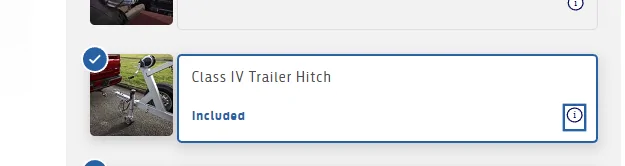

^^^ has no "tow package" on it, already includes everything^^^
So then I add the "trailer tow package", price increases, but it actually doesn't add anything to the truck. I'm going to get in touch with ford, I want my money back.
Here's with the trailer tow package option that literally adds nothing to the truck
