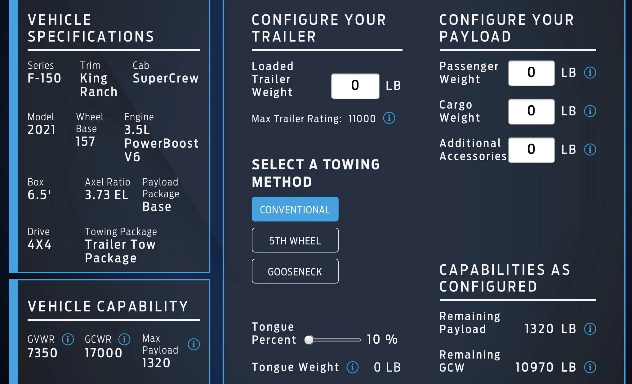

This is about where the Powerboost Payload starts:
Ford F-150 New Order POwerboost expected payload 20220902_115938
Ford F-150 New Order POwerboost expected payload 20210909_131652

FWIW to you, here is the payload on my truck from the factory, with nearly all options except the 7.2 output, absent spray in liner, tonneau cover, heavy weathertech floor mats. You are on the right track to look at the 250 if you want the payload you are looking for.
Ford F-150 New Order POwerboost expected payload F7426CFB-10E7-4636-B613-46B7581985B0
