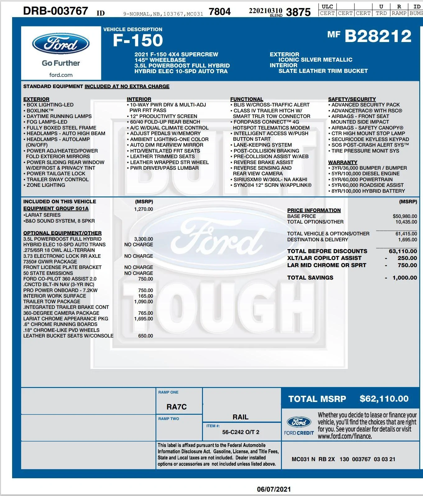

Here's my 501A:
Ford F-150 New Order POwerboost expected payload 1663867763496
My trailer is an Escape 21NE. When we travel with it I have between 400-500 lbs in the bed + cab, which works out just about right for the capacity of the truck.

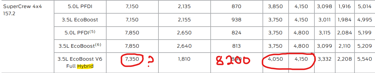

You're over thinking it @SRMD, while overlooking other particulars. The truth is that all of the manufacturers of "1/2 ton" trucks use a magic wand to inflate / create their numbers. There's no rhyme or reason to it either outside of paper racing. There's certainly not a strict adherence to strength or safety margins. Perhaps their stickers are endowed with magic powers via the wand?
Ford F-150 New Order POwerboost expected payload 1663911873105
Ford F-150 New Order POwerboost expected payload 1663912627894
(Note about the front axle ratings - 145" PB = 3900lb, 157" = 4050lb)
When the hybrid was announced and displayed, Ford went well out of their way to mention how they torture tested the hell out of the hybrid components, particularly the battery. I'd put $100 on the reason they won't make the marginally stiffer springs on the HDPP package available is the fact that, when empty, it will beat on the hybrid components more and they want customers to validate their numbers (tested and projected) before giving it a little more abuse and thus its actual engineered GVWR sticker. That's it. The powerboost has the highest weight-rated front axle of all F150 variants including tremor and raptor (I believe the diesel, which is now discontinued, had the same 3900lb rating -- above is 2022 figures).
The only thing of note the PB is missing from the HDPP for the increased GVWR on the sticker is the ~10% marginally stiffer rear springs (arguably not even needed as seen from squat testing). Everything else is present in the manner it needs to be (wheel / tire loading, HD frame, larger axle, proper gearing, etc...)
All of the hybrid's components of notable mass, as well as that of the 4WD system are at the lowest possible position on the truck, ~24" from the ground and between the axles. There isn't a safer position to add mass to the vehicle with bed payload, or trailer to approach the GVWR limit.
The focus shouldn't even be on the rear end for the purposes of this thread which is that of the GVWR missing the 500lbs, that the truck already is provisioned for as it sits. Watch any of the towing / payload tests, she squats the least. Those who do it are surprised because the truck's GVWR is engineered to 7850, it's just arbitrarily marked at 7350 for reasons only known by Ford.
The route I've taken to maximize safety while towing, and to increase the unladen ride is a good set of airbags and adding an adjustable rear sway bar (every truck should have a rear sway from the factory, as well as the ability to option in-cab disconnect if desired).
TLDR: The truck is already #7850 GVRW engineered -- Ford just needs to give us our stickers; there's nothing to fret about.

"PowerBeast" - our 2021 F150 Lariat 4x4 Powerboost
You can get a well equipped PB with a reasonable paylod.
Our 2021 Lariat 4x4 PB 501A comes in at 1653 Lbs payload. We find it very comfortable, even for long hauls. It tows our 5K (loaded & ready for the road) Lance 2184 trailer well.

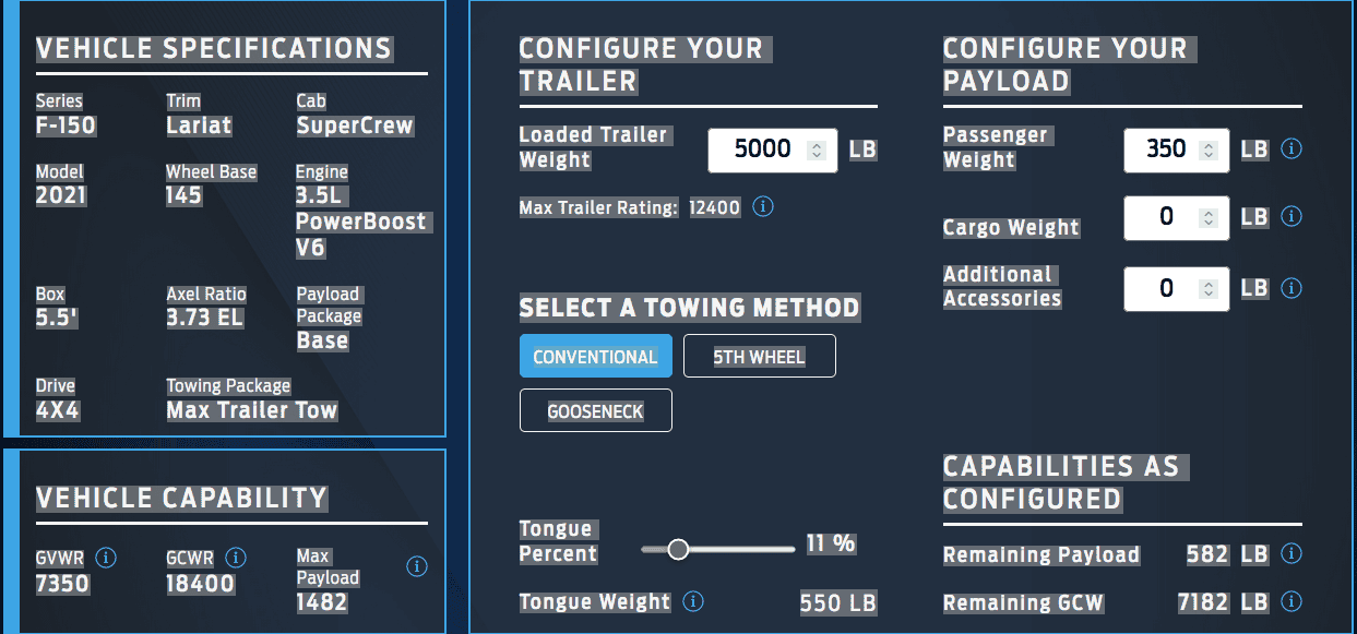

Will the bed be loaded with gear as well or is it just the passengers and tongue weight that need to be factored into the payload?
A nice feature the F150 offers if you are concerned about payload is OnBoard Scales and SmartHitch.

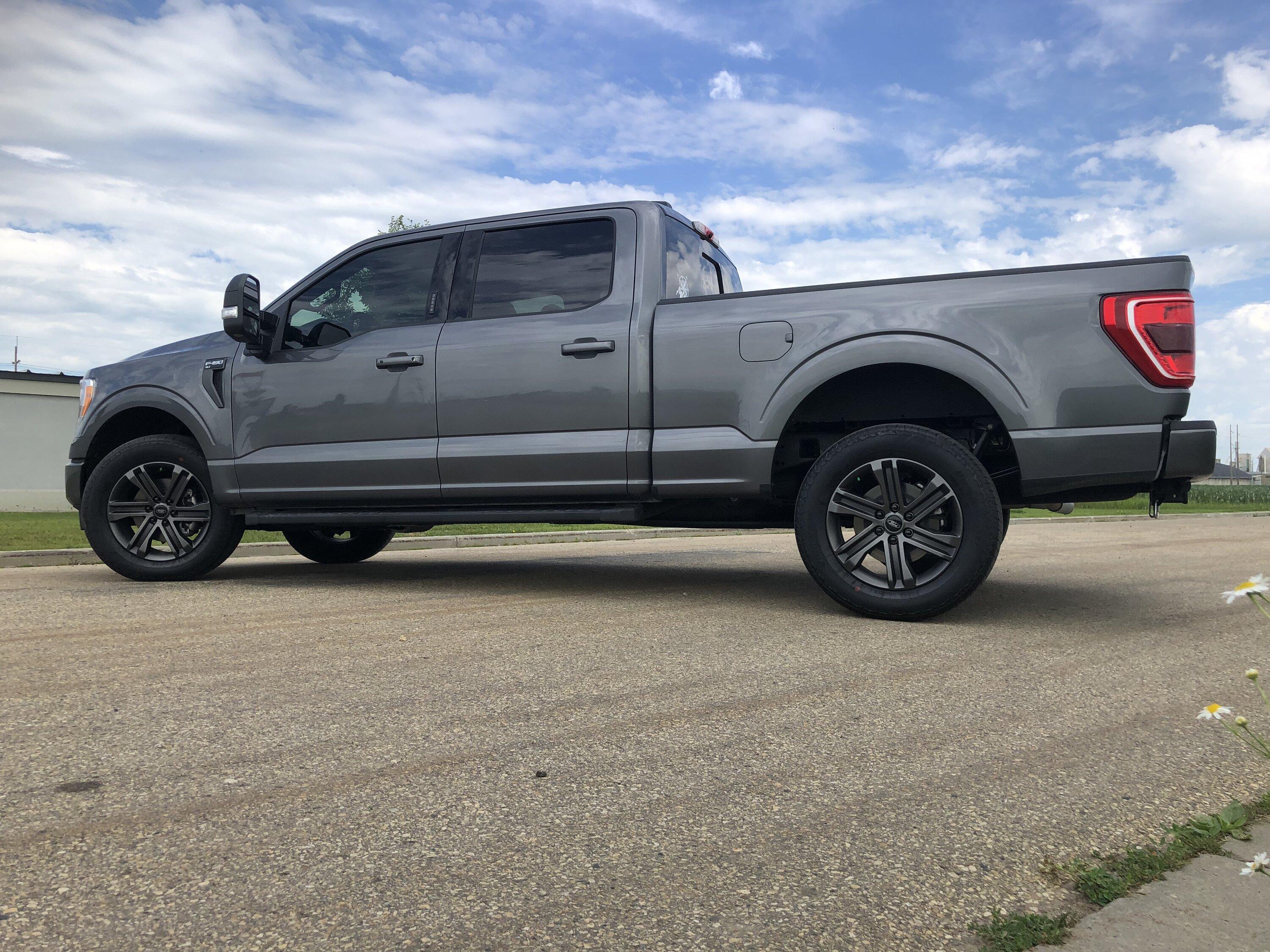

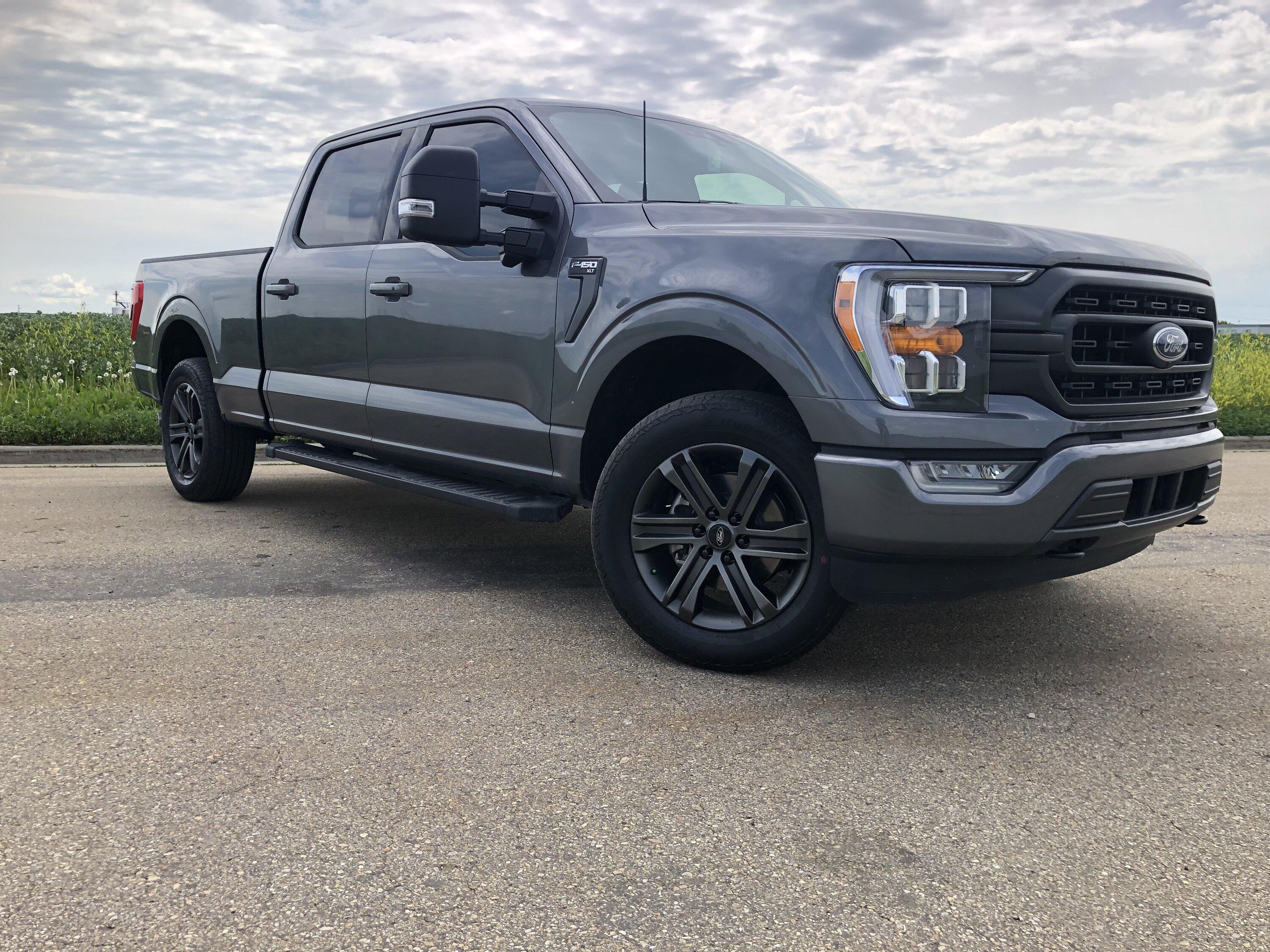

I went shopping today to check out payloads on various local F150s. Interestingly I found a dealer that had a well loaded XLT 3.5 eco-boost without the power boost that had a 1773 pound payload. It had most all of the options (302A) including max tow, FX4, utility package, etc. I’m trying to understand why that truck had such a high payload with a 7050 pound GVWR. It was a 5.5’ bed and I need 6.5’. Can anyone tell me how much payload reduction to expect with 1’ extra bed length?
Huh. Well my truck sounds like the one you describe (302a, Max Tow, FX4) but I have the 6.5" bed. No power boost or moonroof though. Payload is 1,777 on mine. I believe the 1' longer bed reduces payload by about 21 lbs.
