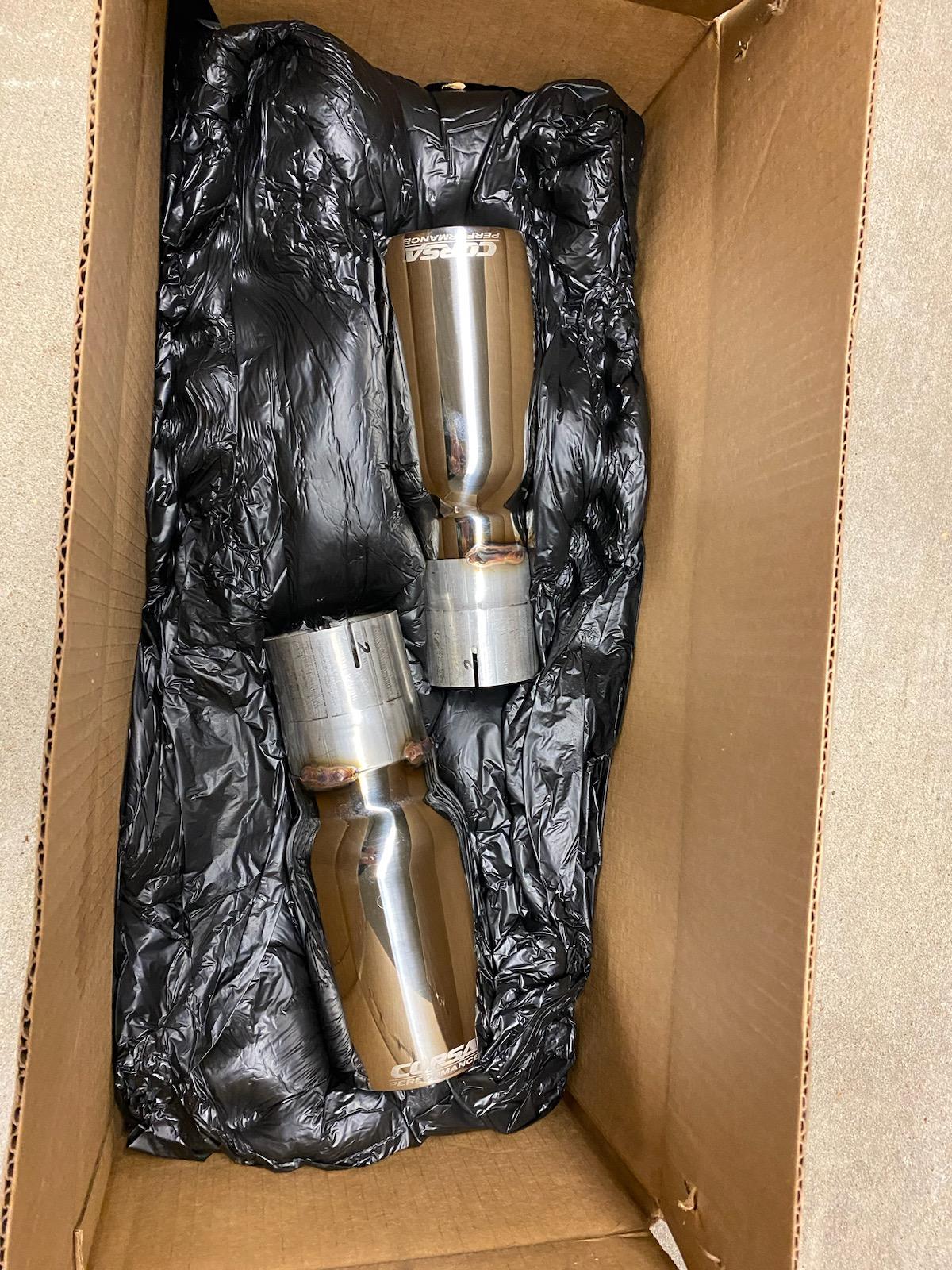

Ford F-150 Muffler swap vs cat-back pros and cons. IMG_2465

How much would you sell it for? Shipping up here might be pricey. I'll have to convert it to canadian pesos to see if it's worth it.
$150 muffler
$75 tips
plus actual shipping.
have the boxes packed up
