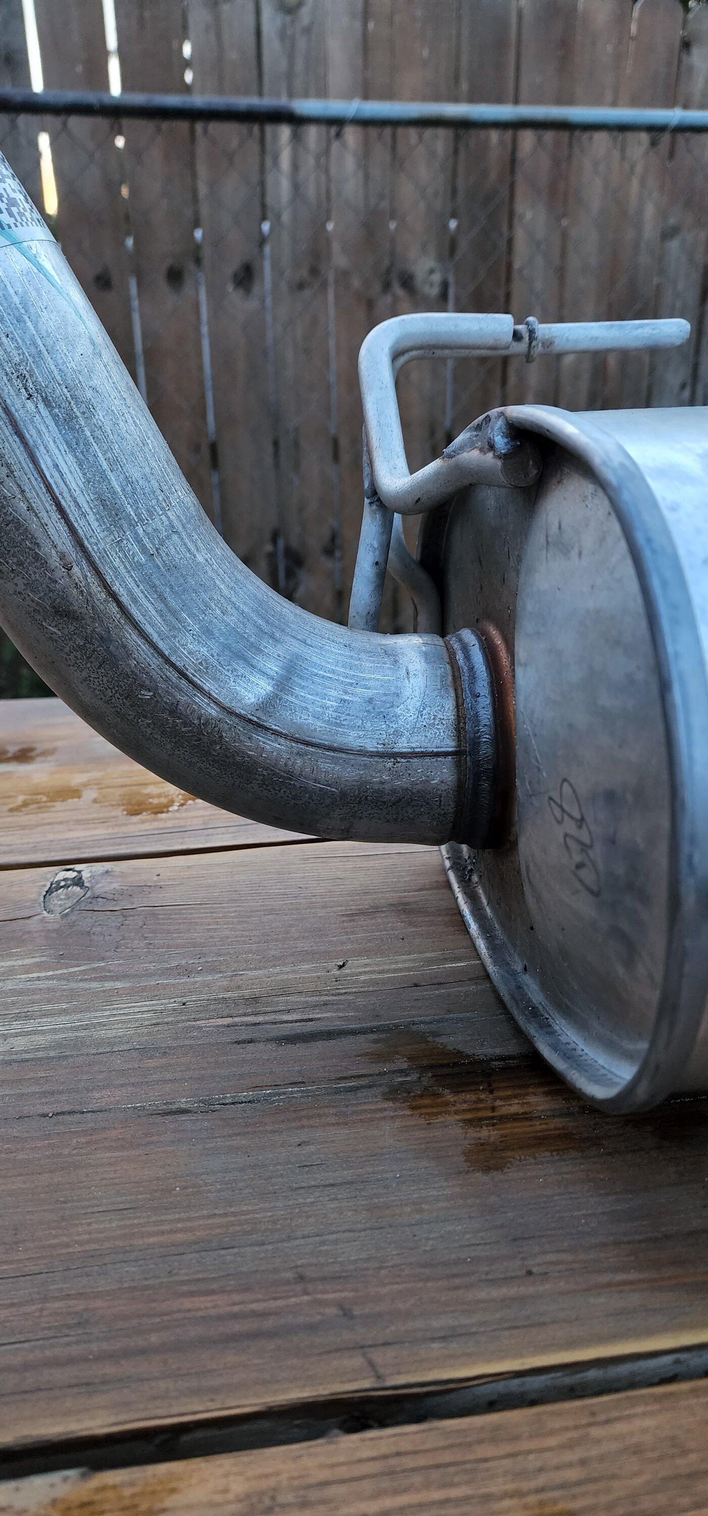

I thought the problem with trying to reuse the factor tail pipe is the almost immediate curve it takes leaving the muffler. Pic is from another memeber/post.

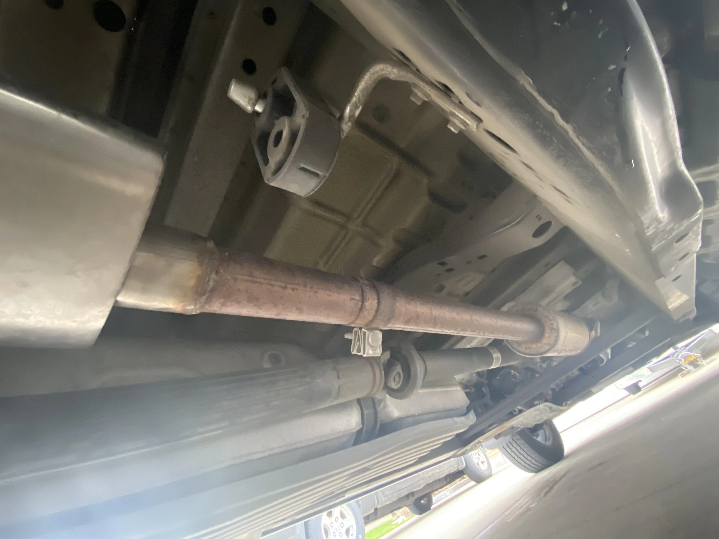

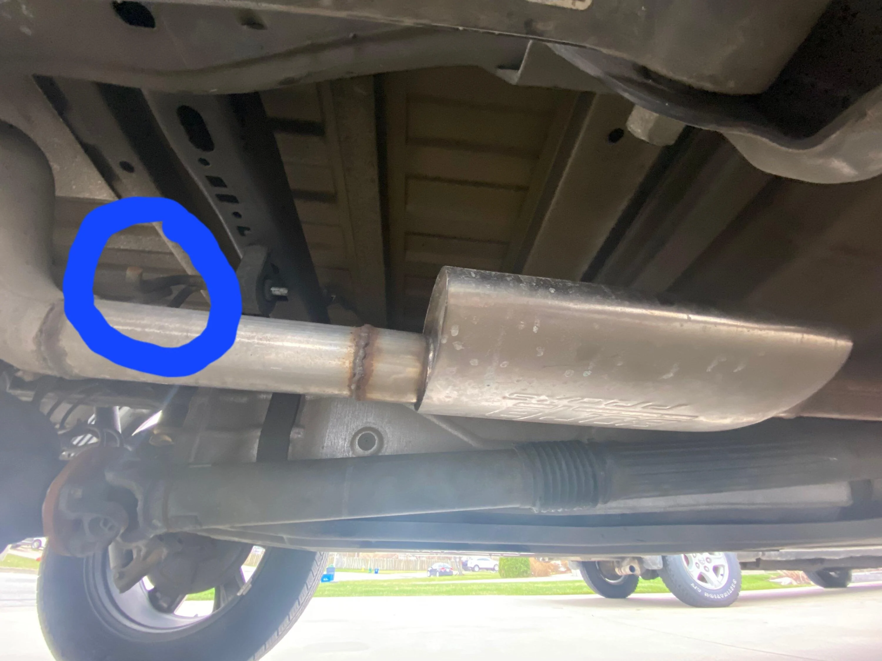

Should my tailpipe be shaking like this ? this is at idle, truck is warm. I got the Borla pro xs installed, I get a very loud built up humming sound (it’s hard to describe) in the cab at very low rpm or when lightly getting up to speed (seems to kick in at 3rd gear or held in a lower gear) . Definitely doesn’t seem like a normal sound for a muffler. As soon as I get on the gas a little harder it returns to its normal quiet rumble. The noise is way louder than what the exhaust sound is even when accelerating through the gears very hard. The two tails pipe hangers are in tack, but the original muffler hanger is gone, no hangers from where the muffler welds in to the tailpipe all the way up to the resonator which is a pretty long run. Figured I’d ask before I start sound deadening my interior back wall and floor.

Yeah it appears that they eliminated a couple hangers that hold up the exhaust that should definitely be added back.

Yeah they eliminated 2-3 hangers that hold up the exhaust that should definitely be added back.
Think it’s just the one that can be seen hanging in the photo. Where the old muffler and tailpipe attached is still in place, just a 10” pipe was added in front of it. Guess I’ll have to add one in on the pipe coming from the resonator

Is the one below welded to the pipe but you just can't see it from the angle of the photo? A decent exhaust shop should be able to weld a hanger onto the pipe in front of the muffler so you can use the existing frame hanger and insulator.

Yes that hanger was left connected. Not sure why they didn’t weld a rod on and use the factory hanger, now it’s a pretty long run to the res. I wonder if that’s why I’m getting these weird humming and drone noises
