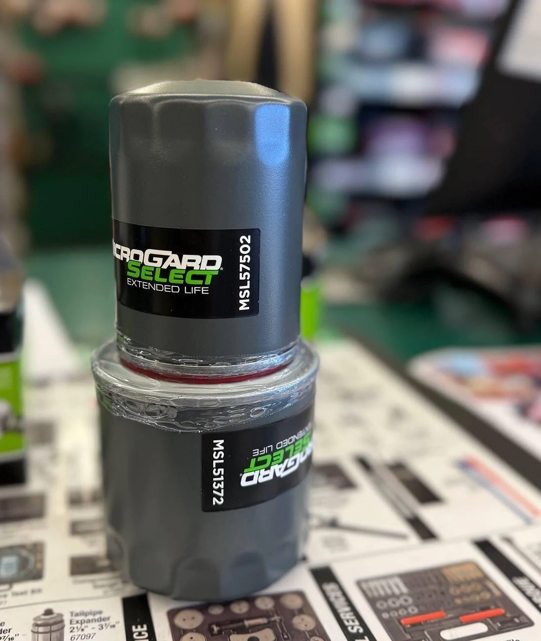

The Microgard Select and Carquest filters have consistently been the top reviewed filters on lots of "cut open" videos and the reviews on BITOG confirmed this.
I bought a couple of the OEM fitment since I was still under factory warranty. I also bought several of the larger FL820s version to have an extra half quart of capacity with more filter media. I ran one of these during my first OCI with Valvoline restore and protect.

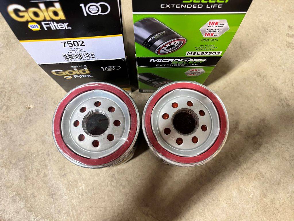

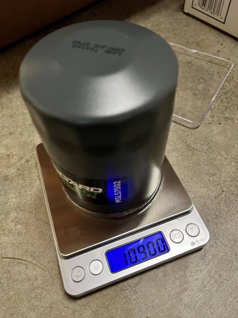

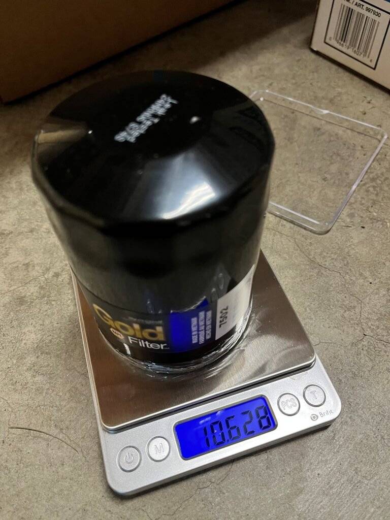

Picked up NAPA Gold 7502 yesterday. "Made in Vietnam" is right on the filter label.
Question still remains if the Microgard Select MSL57502 is also Vietnamese.
I won't cut them open but from looks and weight, I would guess these are the same filter...
NAPA: " Laboratory Test Performance per ISO 454812: 18 Grams Dirt (NAPA Gold # 1515), 99% Efficient At 30 Microns (Based On NAPA Gold # 1515, 1356, 7060) "
Microgard: " 99 percent efficiency (Laboratory Test Performance per ISO 4548-12 at 25 microns). "
I won't cut them open but from looks and weight, I think these are the same filter...
Now take a walk on the wild side and buy the FL820s fitment. More media, more capacity, no noticeable difference in oil pressure. It was a win-win for me.

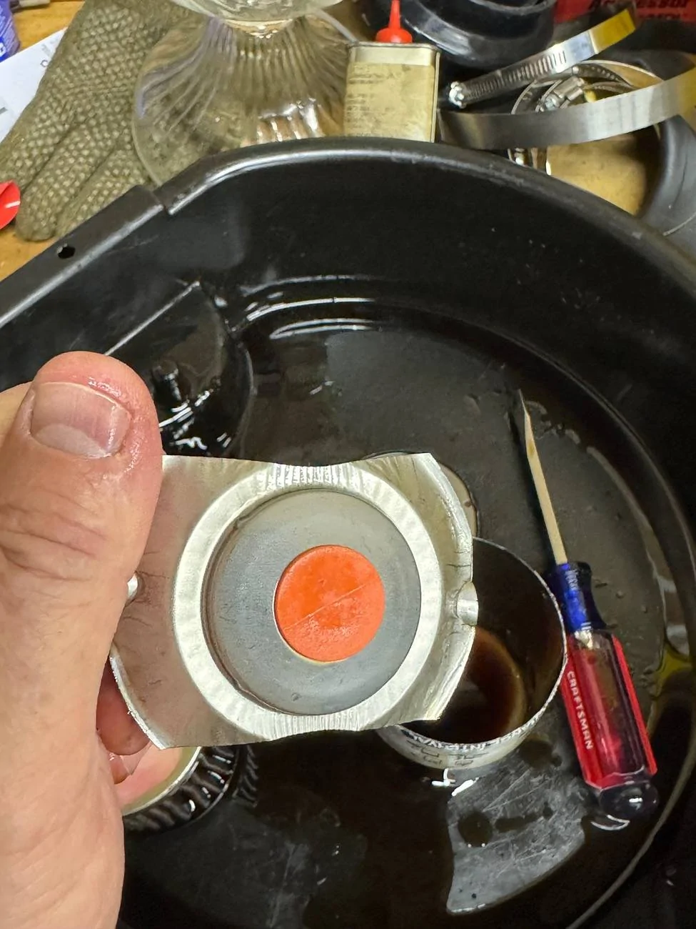

Microgard Select is the only one I’m running now.
The AMSOIL AEO17 let me down badly……
The Fram Endurance suffers the same flaw. Ripples on the spring plate do not allow it to sit properly, so, it leaks allowing unfiltered oil past.
Finally got around to cutting open the most recent FRAM endurance in my truck, no ripples thankfully, gives me some faith in the remaining stash I have, but I will likely explore the microguards when my current stash is depleted.

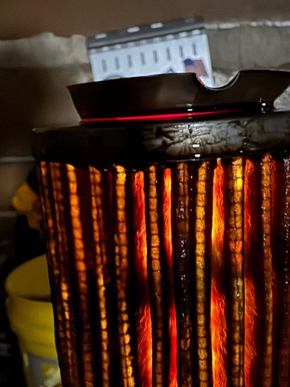

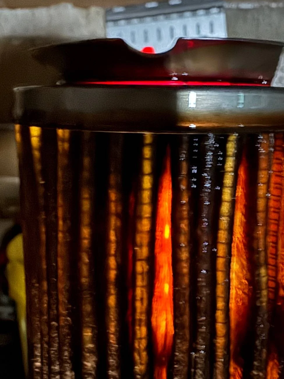

I did the same thing when I heard about the Fram Endurance, now there may be a bad manufacturing issue and I have one I’m waiting to finish emptying to cut open and see if I have a bad batch.
Basically, this is shows light escaping where there should not be any at the spring plate stamping that is faulty.
it’s not just a frame problem. There are more than a few brands affected with this, including Amsoil
Be aware, if a failure is developing, by the time you can see it in the filter, it is beyond saving.
I understand what both you and @FaaWrenchBndr are saying.
I’m saying that the ripples in the spring plate that appear to allow unfiltered oil past the media aren’t apparent in the FRAM I cracked open, I haven’t been able to do the light test to see if it suffers the same bad stamping.
I’m not going to sit here and say I no longer have any reservations regarding the FRAM, but I’m not about to rush out and replace the new one I put in the truck either.

Is the bypass valve psi rating the same on the 820?
I’ve seen even ratings from 8-20 psi on all the filters I checked out
I can’t find the link right now, but IIRC both of the filters from Microgard that I took a picture of were rated at 16-20 psi. That info was from an independent test I think, since Microgard/O’reillys don’t have it listed.
