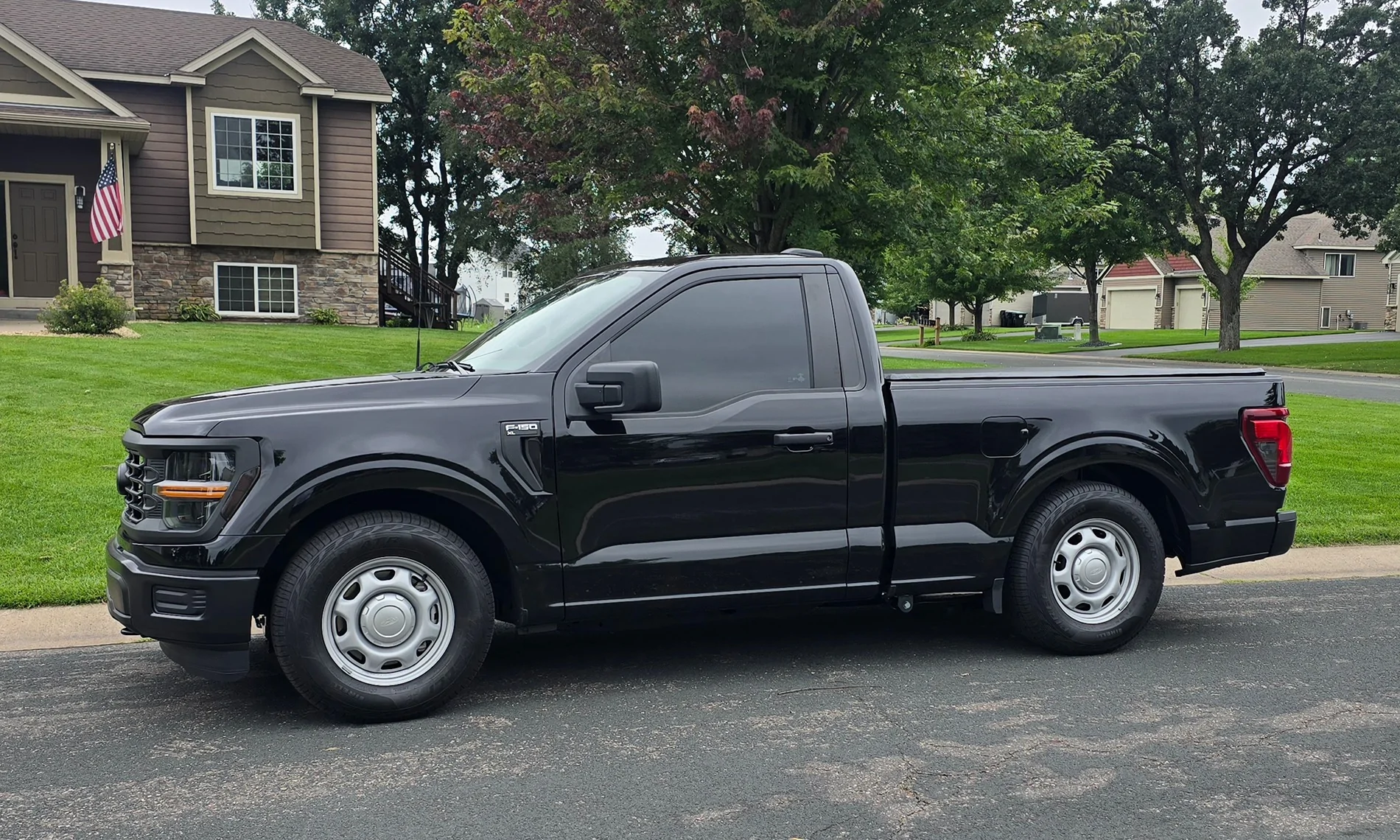

Ordered the 3/5 kit.
Drop shackles had some tooling marks on a couple of the surfaces so I had just the shock installed at the 3 inch drop.
Got the full drop but camber is off a tad +1.5
Installed the rear and only measured a 4 inch drop which makes sense after all an axel flip is about 6.25 and then you add the 2 inch lift perches.
So as the truck sat it was 34.5 in the front and 36.5 in the rear.
Well I added another 1.25 drop to the back by way of the factory lift for the trailering package.
I think it sits perfect now.
34.75 in the front and 35.25 in the rear.
No new vibrations. (This thing has a weird gas peddle vibration at 58mph that seems more engine harmonics and not suspension. This one comes and goes and bugs the shit out of me).

Looks good!!!

Truck looks great.
word of warning on their rear kit. In my case, the bracket that sat on top of the axle and held the top of the ubolts started deflecting/flattening out around the ears where the ubolts are. This was allowing play in the connection and would let the axle twist.
I ditched the top plate for ubolts that went over the axle but still used their bottom plate and the bottom plate started to bend when torquing.
this was all over the course of 2 years of daily driving.
just keep an eye on it.
i ended up putting the ridetech kit on. Much beefier.
