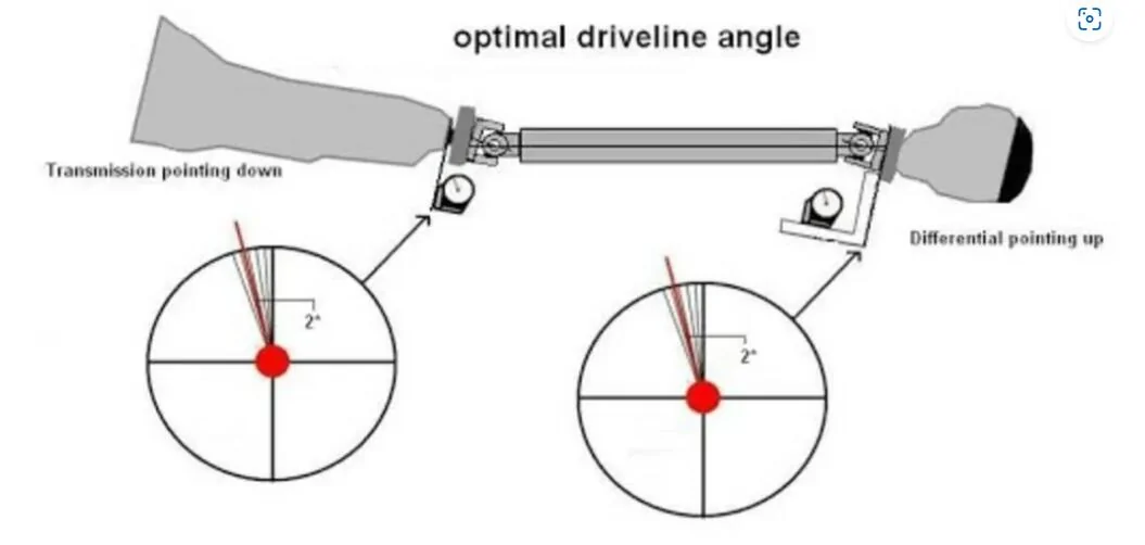

My truck is 2WD, and I'm sure that is why it didn't work on yours. Get a digital angle reader and place it on the water pump pulley to get your engine drive angle. From there, match your pinion angle to run parallel to your engine. That should work. See picture to best describe how both angles should be at.
I wonder if your truck has less of a drive angle than a 2WD due to its mounting point on the crossmember. If the mounting point is on the transfer case, further back on the frame. It will reduce the drive angle.

My angle finder has magnets on one side only. So when I set it up on the metal water pump pulley, it automatically reads off of 90 degrees. So, if we're perpendicular to the ground, 90 - 85.9 = 4.1 degrees.
