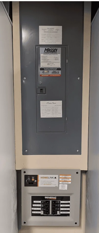

We have an electrician coming Friday to install the Generac 6852 transfer switch. We just need to figure out which circuits to move over. Also having him run a circuit for our TT for when we bring it to the house from storage and an additional outlet in the soffit on our patio for some patio string lights.
Generac 6852 installed today in JAX, FL. The inlet is on the backside of the three car garage. He also installed an outlet for our Travel Trailer. The mini-split in the pic was installed earlier this week for the garage.
10 circuits were moved over. Kitchen Fridge, Kitchen Outlets, Microwave, Garage Fridge, Garage & Laundry rooms, Water Heater, Washing machine, Master Bed and two Baths, and Family Room.
We tested it multiple times failing over and back and it successfully works with the Powerboost 7.2kw bonded neutral generator as seen in YouTube videos.

When researching this weeks/months ago, we couldn't find any reliance units for sale online. That plus no confirmed installs here nor videos for them with the PB. So that is why we went with the Generac 6852. There are multiple verified installs here and youtube.

Nicely done with this set up. UGADawg96 - did you have a chance yet to see if the on-board power could handle the full load of these 10 circuits or do you need to use circuits selectively? I ask because I'm thinking about a similar set of circuits for my upcoming Generac 6852 install. Thanks for sharing - good stuff!
