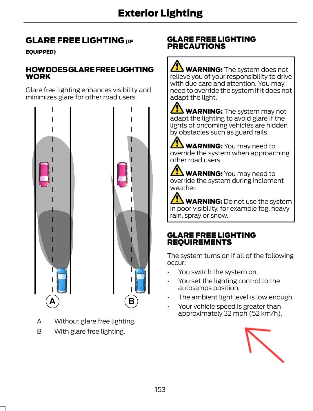

Now I know why 33mph is the trigger speed I see the Anti-glare kick in every night on my road
Ford F-150 Headlights - Automatic Brights Screenshot_20231110_002803_OneDriv
Wow, how the heck does this even work? That's insane!
I believe there is some kind of shutter/curtain inside the projector assembly that can be moved/located strategically to block just a portion of the light. It IS an amazing array, but its technology has been around in Europe for quite some time.
Scary expensive though.

Guess I need to start driving faster on back roads. How long till someone figures out how to reduce this number?

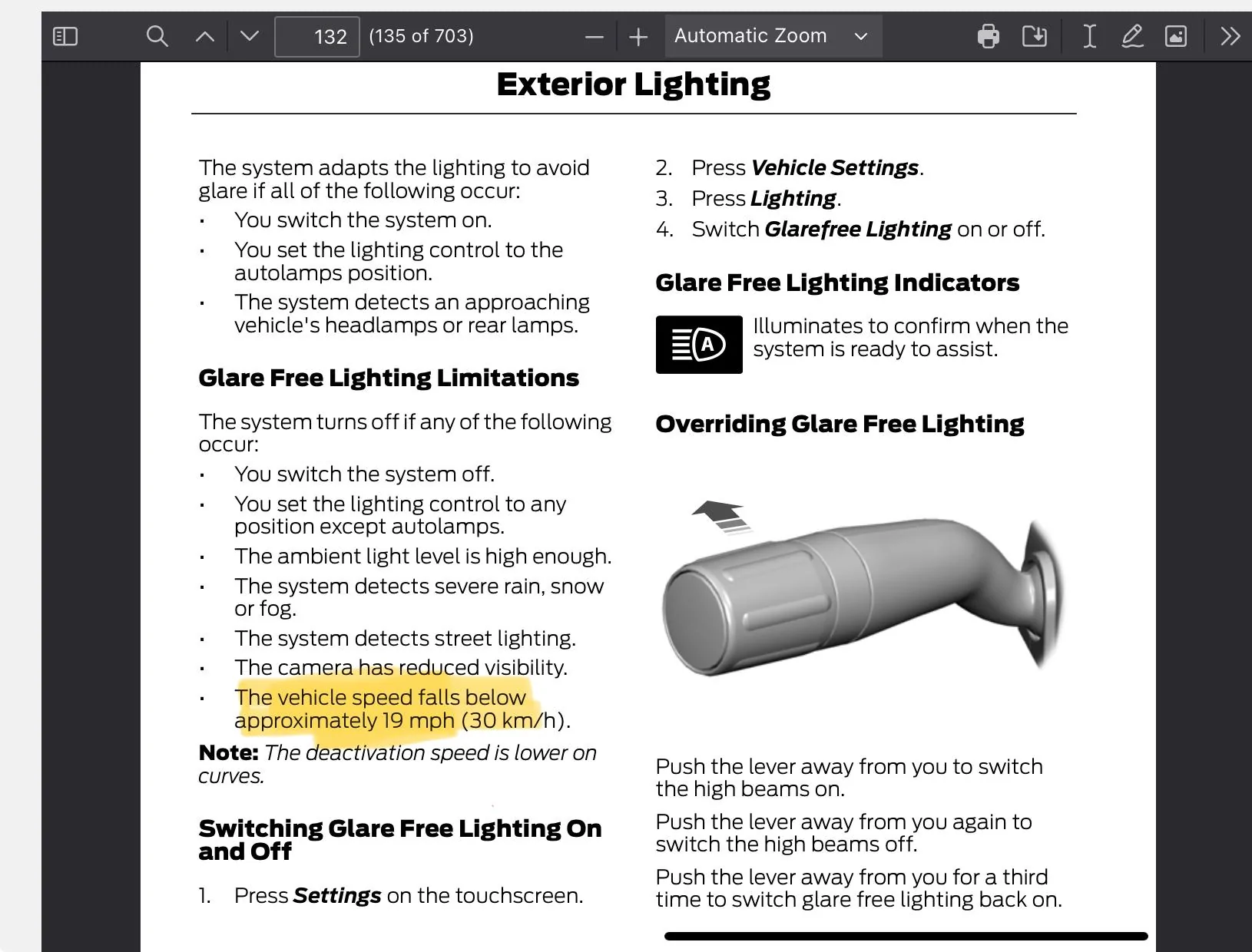

Interesting that they don’t automatically turn off below that speed. I can pretty much almost come to a stop on a dark road 4 way stop, before they turn off.

Ford F-150 Headlights - Automatic Brights IMG_0650
I noticed the same thing when turning into my neighborhood. Owner’s manual states The glare free system turns off if the vehicle speed Falls below approximately 19 mph.
