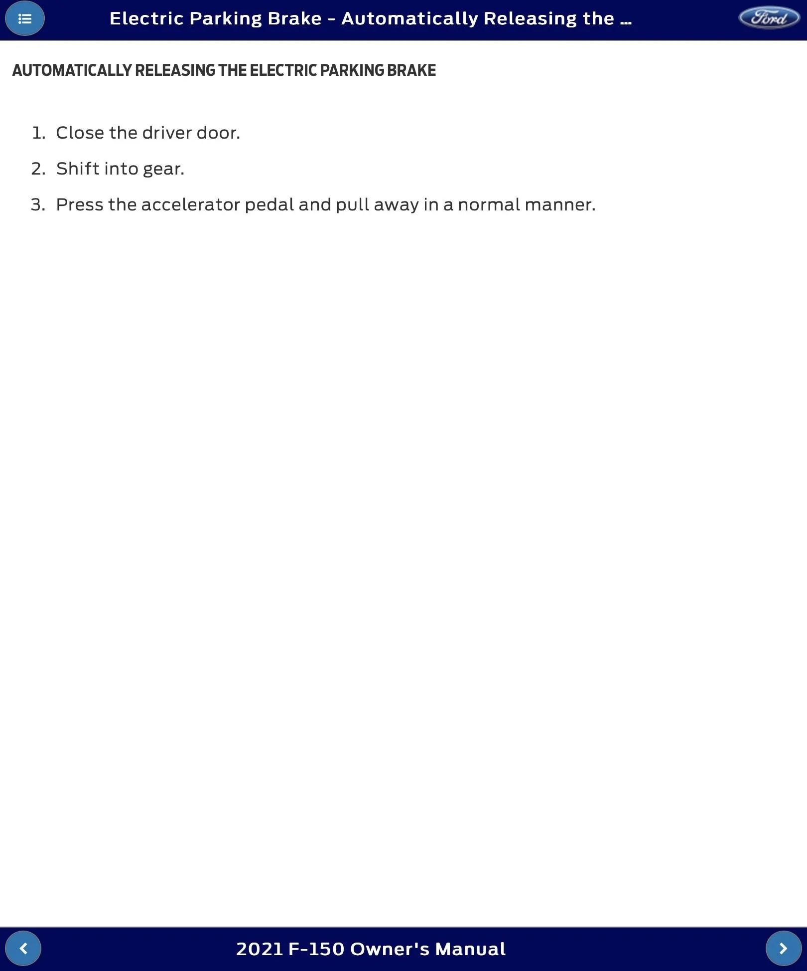

To add to the discussion……so once the parking brake is set, either manually or automatically, how do you disengage?
I typically both set the parking brake and release manually out of a life long habit, but now I just read where the owners manual states NOT to release while in park. Is this to prevent the truck from rolling and potentially damaging the transmission or something else?
Ford F-150 Parking Brake- Automatic 66D4DFDF-9CB0-47E8-82B1-A5C02E57500D
Ford F-150 Parking Brake- Automatic 97C54756-0317-448A-BCCB-A6246B64A63E
Have to admit, I don’t like the Auto Brake release. You have to actively press the ’gas’ pedal and the truck jumps in forward/reverse. There is nothing smooth about it.
Today, I tried parking both nose down and up; put the truck in Park, shut down and opened the door- no Parking Brake (I did not wait long). Maybe the computer needs time to process the angle before engaging.
Still fishing for the slickest option. In my mind Ford could manipulate coding- put the truck in park, Parking Brake engages; put the truck in gear, Parking Brake disengages. I guess that would be too simple ?
