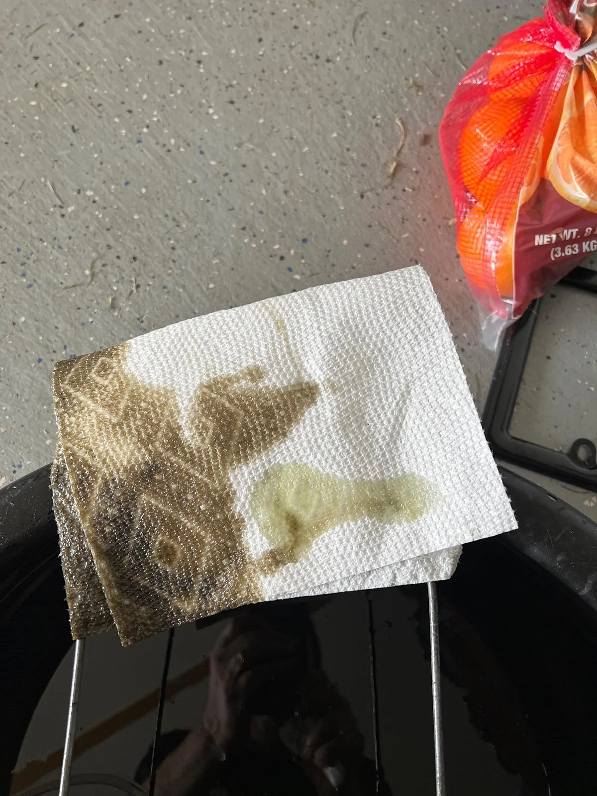

How many miles did you have on the truck at the time and how did the oil look?
My truck was just shy of 30k miles. The oil looked nasty. This photo is old vs new of the rear end oil - the front was far worse.

30K is not that much. I've heard that the ring gear marking compound Ford uses to check the mesh of the gears makes the lube look pretty nasty for the first change. But that said, I'm always surprised that manufacturers do not specify a differential lube change earlier in the life of the vehicle. When I have regeared vehicles the shop has always recommended a lube swap at 500 miles with new gears to get ride of the breakin particles.
