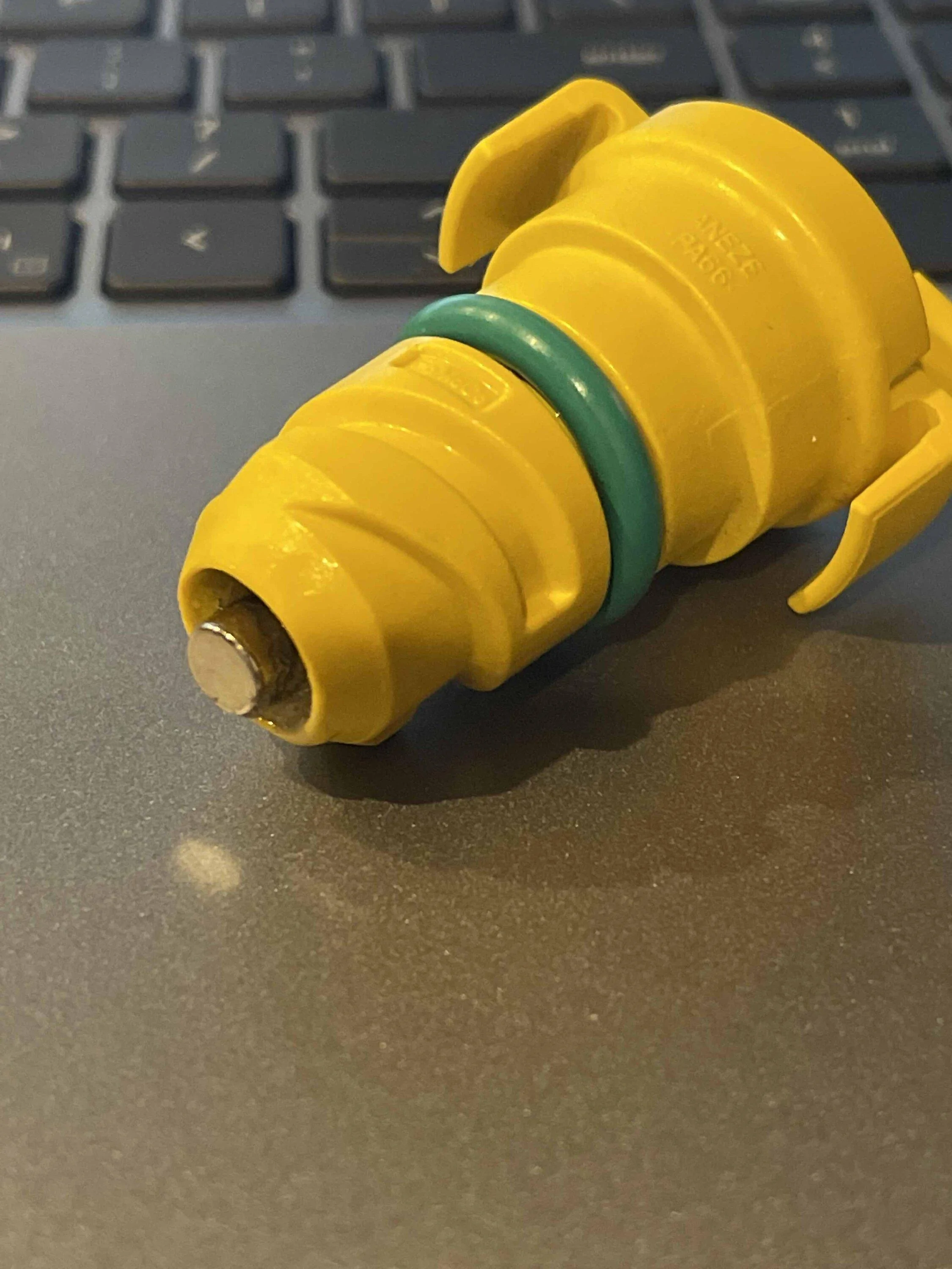

Not to go against the grain.. but I add a magnet to each of my oil drain plugs.. gives me some comfort as to how much wear is occurring between changes.. I epoxy a 1/4"x1/2" round magnet into the plug, usually I drill a 5/16" hole deep enough to hold it.. the stock ford drain has this already - all you need to do is epoxy the magnet in place. good luck however you go.
Ford F-150 Oil Drain Plug Magnetic_Drain

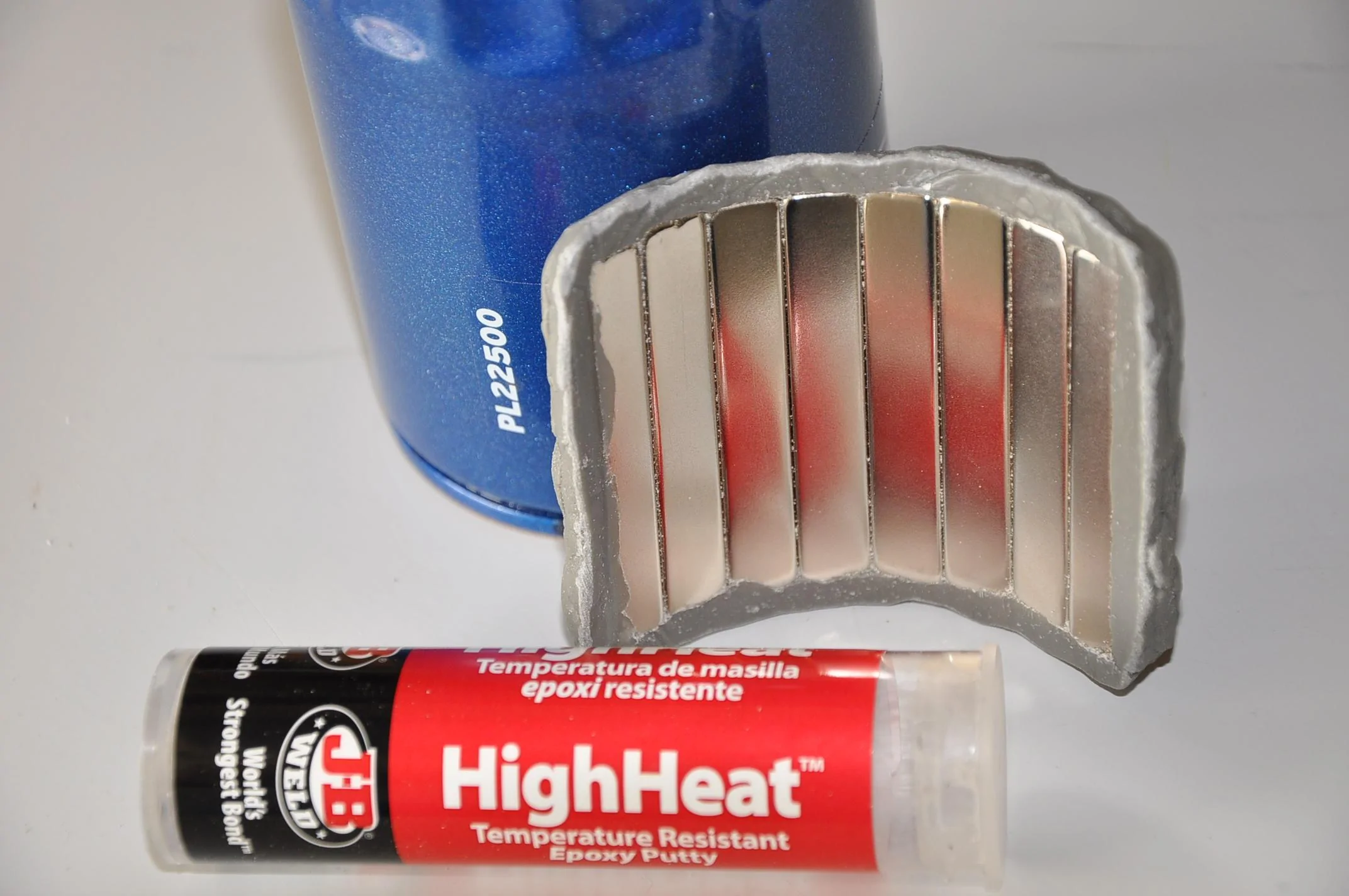

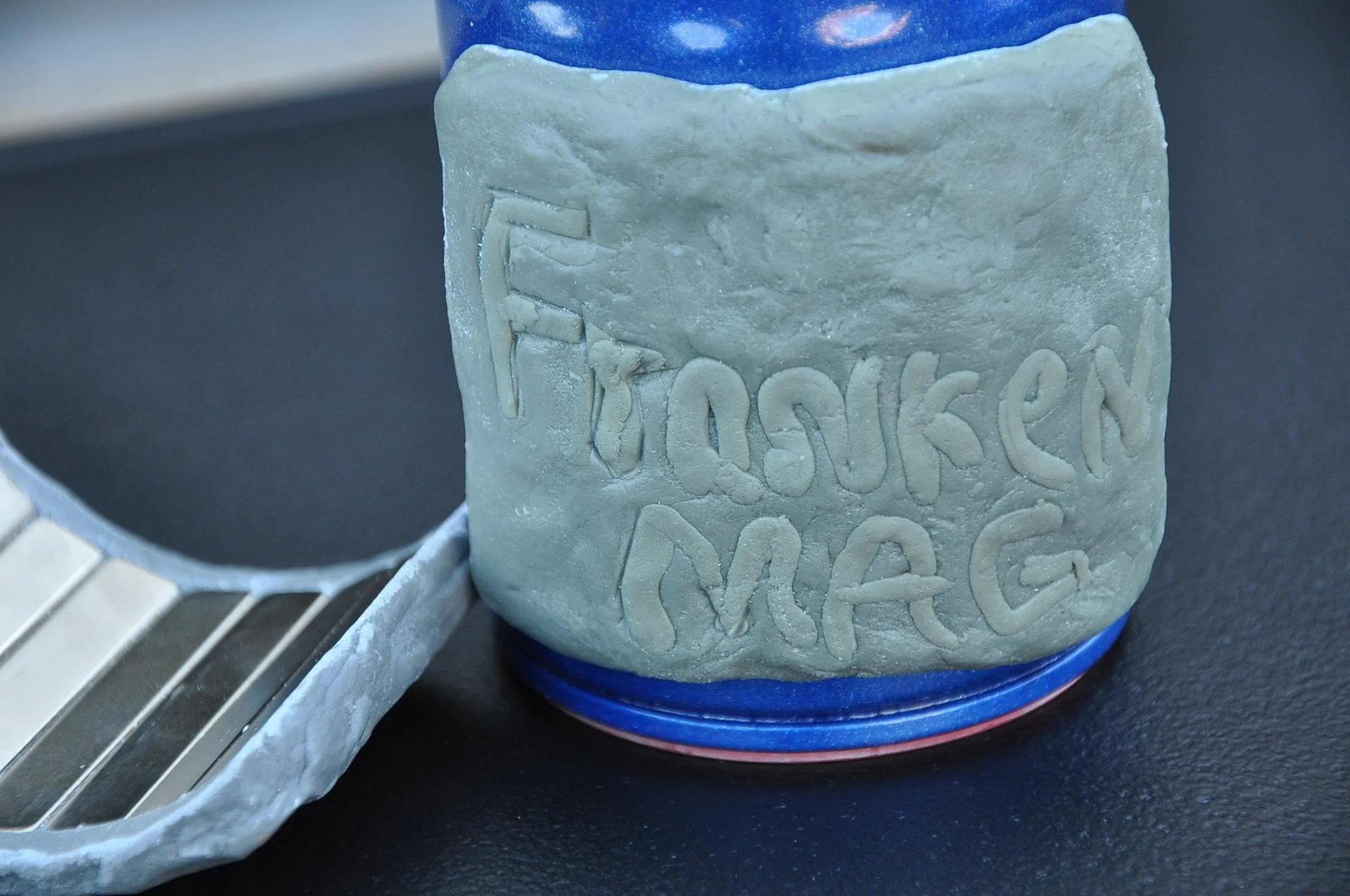

If you feel like making something you could try a Franken Mag for the magnets.
Ford F-150 Oil Drain Plug Franken Mag
Ford F-150 Oil Drain Plug Home Mag Front

Are the 2022 2.7 the plastic plug or metal threaded typical drain plugs?
XLT22
Nov 12, 2022
499
373
GA
2025 STX 200A
It’s plastic. Save your money and buy a 25 pack of #208 Viton o-rings from Grainger supply or any industrial supply house. Last check it was $14. Change it every oil change is what I do.
