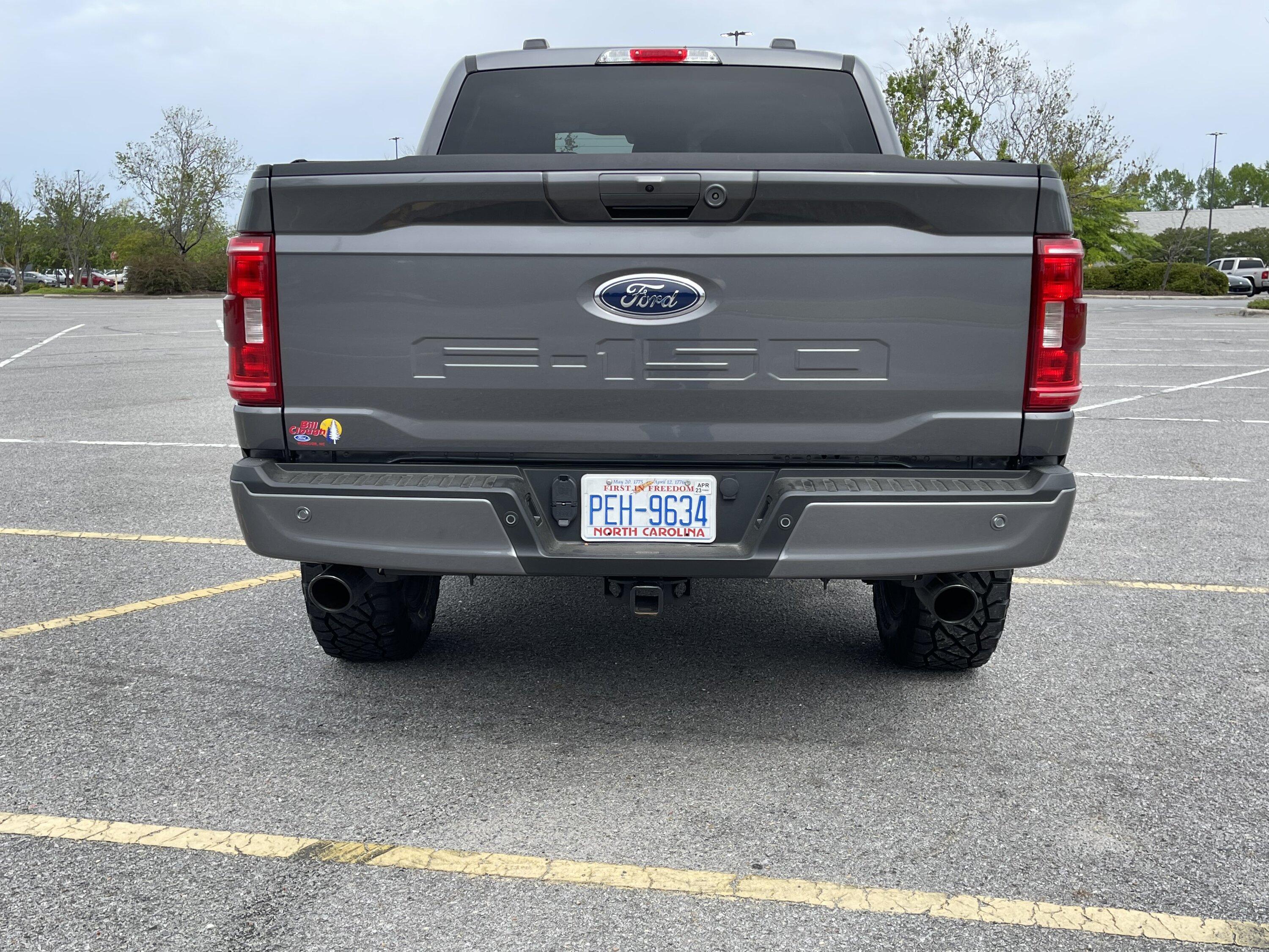

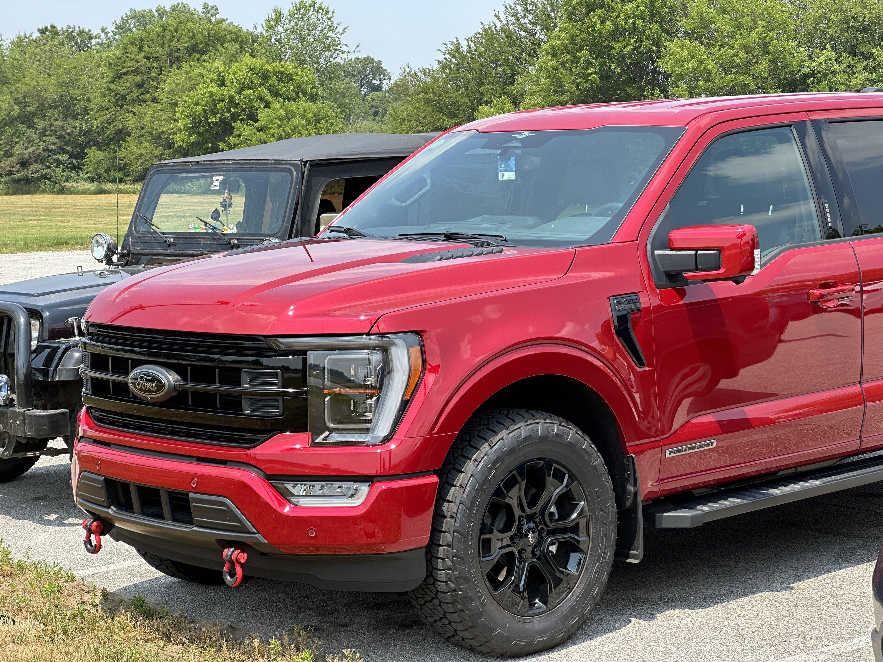

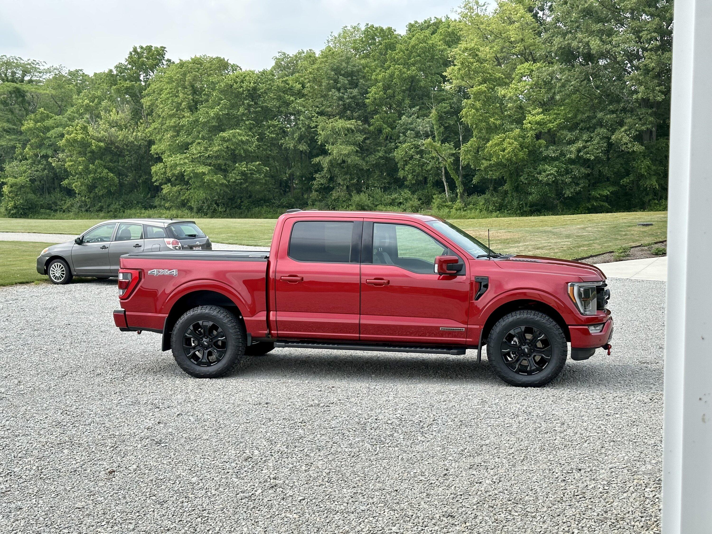

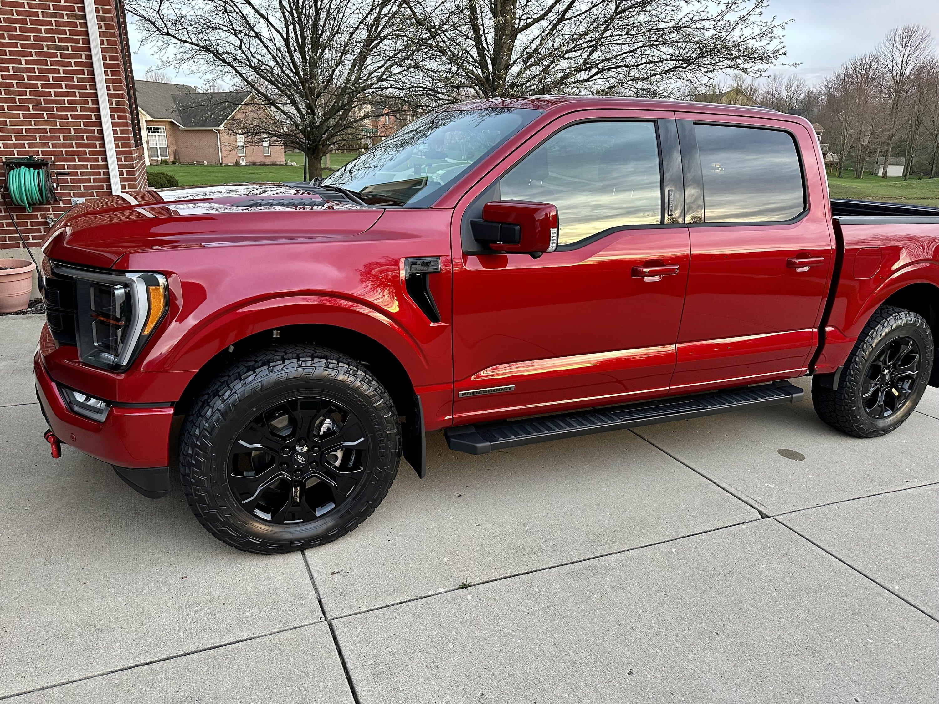

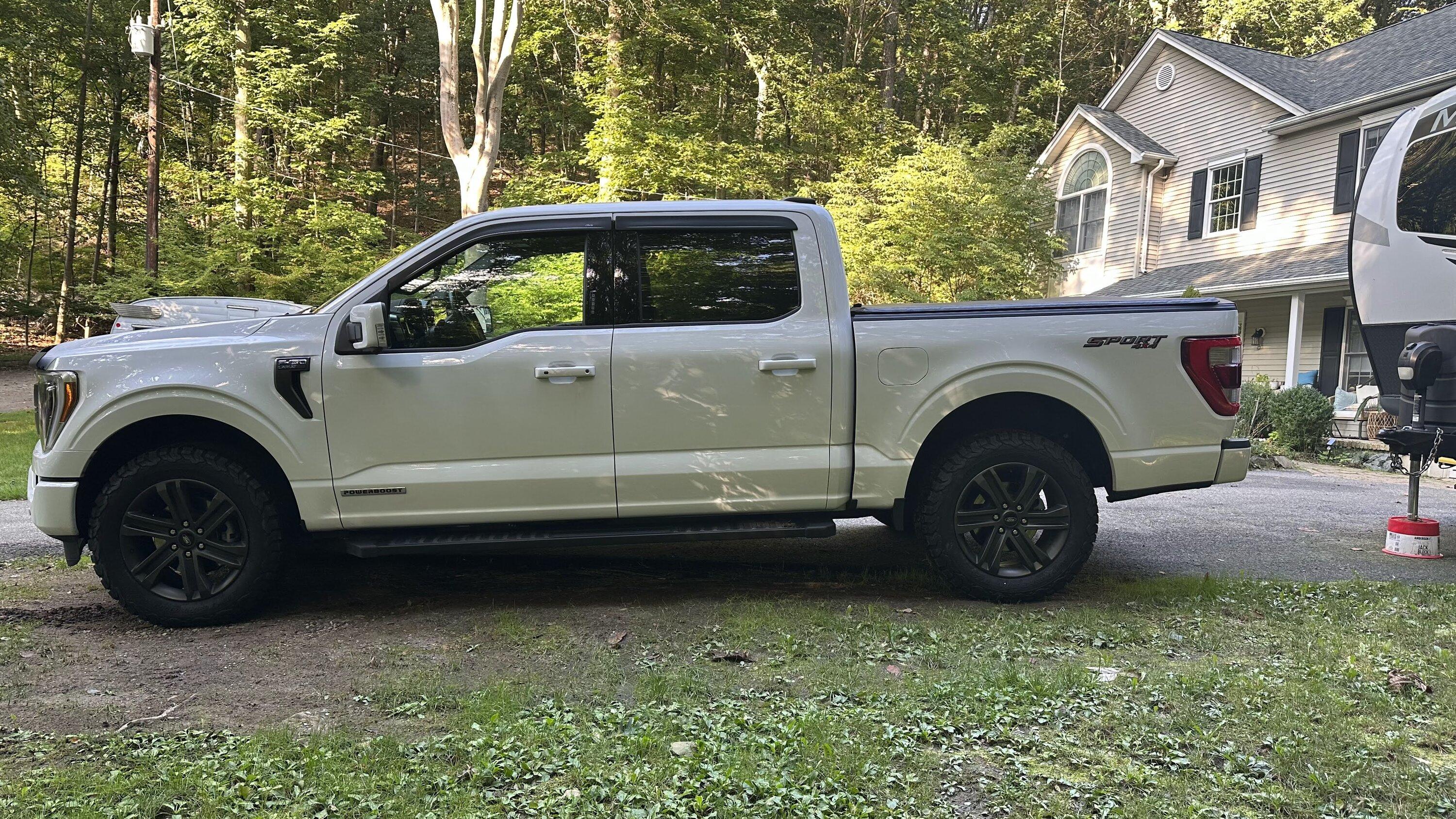

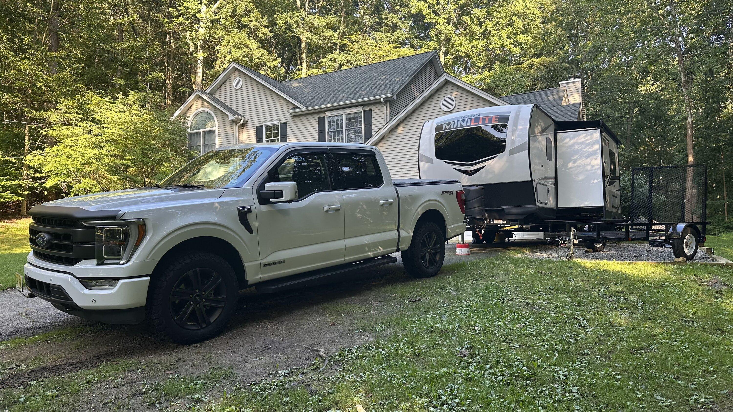

I’m running that setup- so are plenty of other guys on here- Nitto Recons 275/65/20’s. I actually have a slight rub at full right lock when backing up- but it’s very minor.
Completely stock suspension otherwise:
